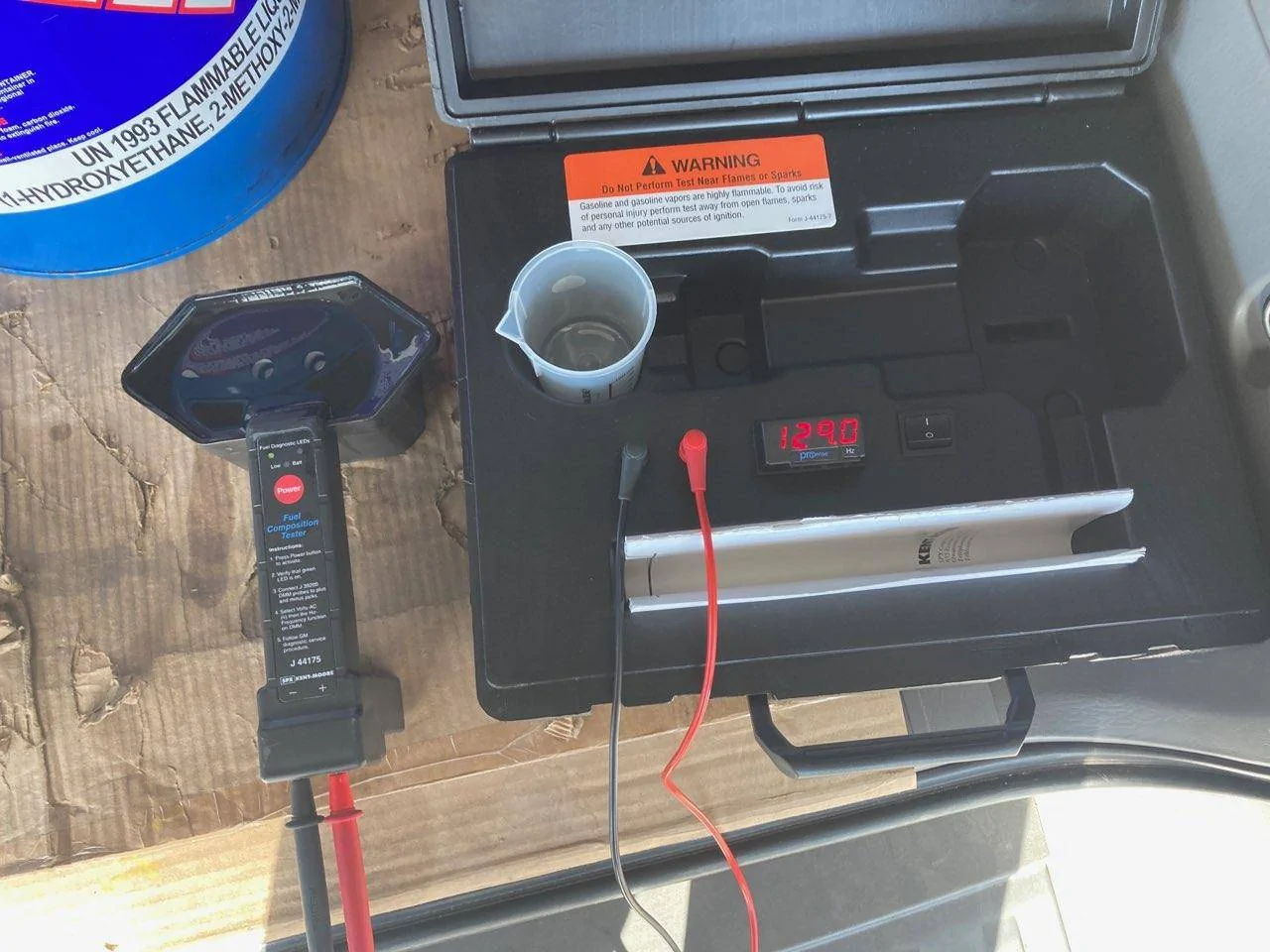

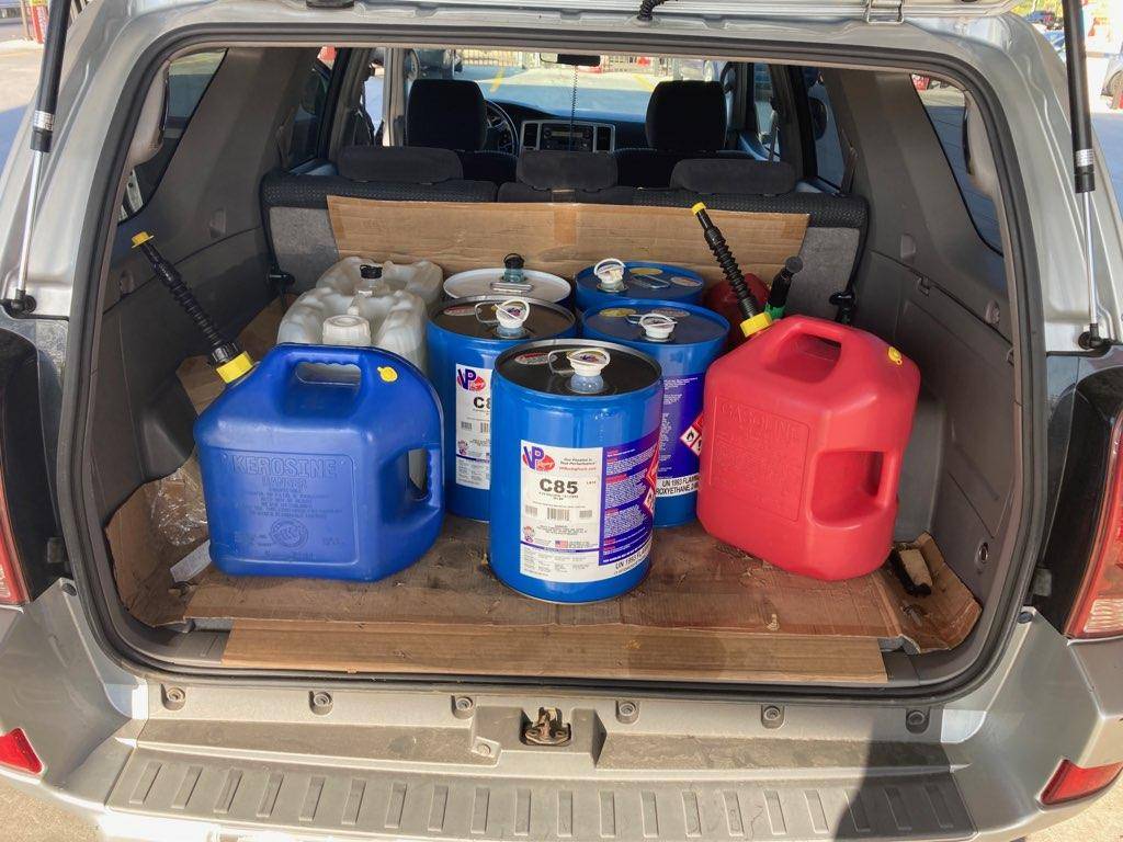

Since it is so close to house, I'll usually take wife's SUV with my VP racing containers. Fill up, test at home, and then take my car back over to fill up. I have my nguage loaded with tunes for e70 through e85 with different stoich ratios. I've noticed that as long as e70 or better, I can run the same 21-22 timing Lund based tune without any knock other than the minimal 0.5 here and there on no lift WOT box shifts.
My buddy also has a rather fancy digital tester to confirm content.
