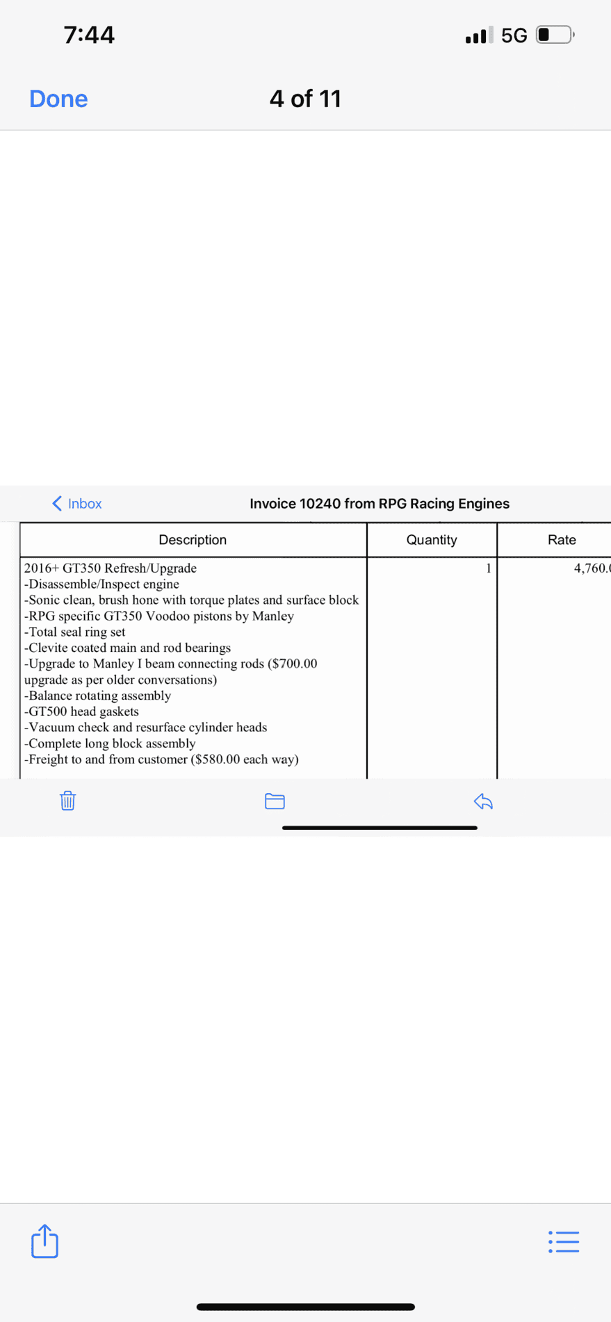

I think RPG gives me a bit of a discount but my voodoo long block refresh/rebuild including new pistons / rings /rods was less than that but I have to pay $500 freight each way.
My semi local builder charges $1300-$1500 to assemble a short block (his prices Just went up ) . add may be another $500 to assemble the long block so I think the $1800 is in the ball Park
They are charging a lot of other stuff that adds up including cleaning and work on heads /crank /block ....about another $2K .
Thats enough to sleeve the block !
