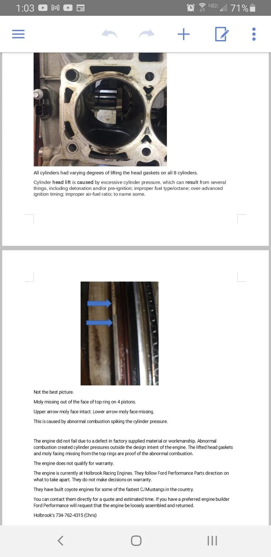

I proceed to pull the motor and have it shipped to Ford Performance in hopes of being covered under the 24 month, 24,000 mile warranty.
Attached is the copy of the inspection report.

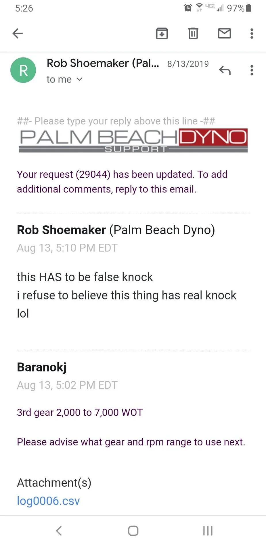

Every dyno pull and 1/4 mile pass over the past year has been data logged and all logs consistently show 0 knock. No -/+ , just 0.
My original PBD tunes were showing knock even at 16 degrees and partial throttle. PBD was convinced the knock was false, made some type of revision (don't know what because tune is locked) and all knock went away.
I trust PBD and them giving me 21+ timing for use with 96 octane as I don't believe they would give me anything they didn't consider safe.
My question is why wouldn't any of my logs show knock when apparently there was a considerable amount of detonation going on ( see attached picture)?
