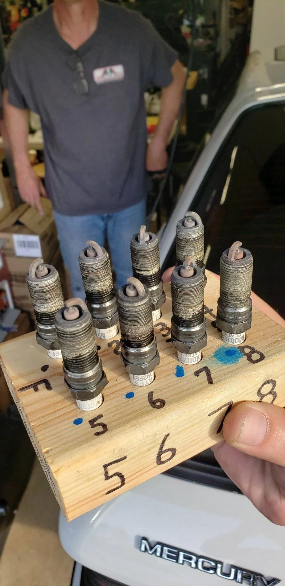

Every single dyno run and 1/4 mile pass has been data logged. I also have the nguage set up where the knock PID is displayed all the time and use the LED indicator light to light up if any + knock is indicated. If you pm your email address I'd be more than happy to send you dozens of data log files where you can see for yourself what I had been seeing the entire time.

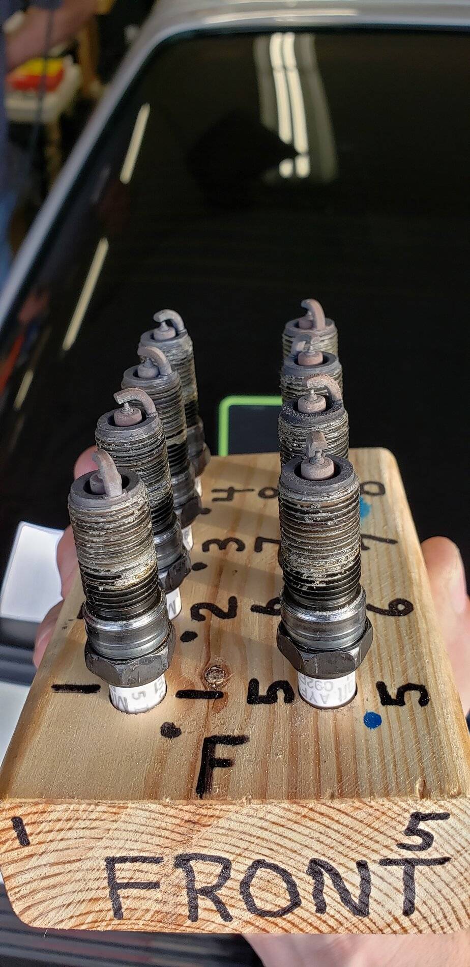

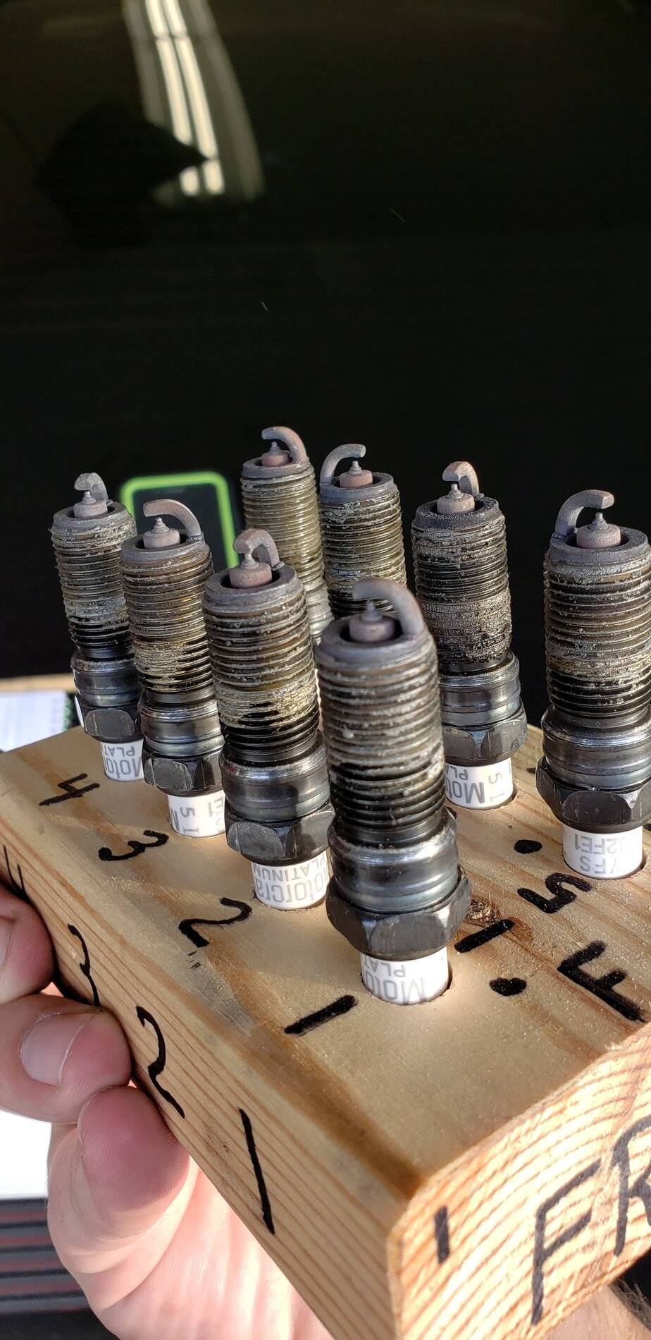

If I didn't redyno the car at the car show this past April I would have never knew anything was wrong. The tune cold started perfect, idled great, gas MPG was improved over my whipple tune, no smoke, catch can never had anything questionable in it, no hesitation, liner partial throttle, fuel trims were usually ranging from-2 to 2, often at 0 or +/- 1, and pulled like a freight train at WOT. These were how the spark plugs looked when we pulled them at 6,200 miles.
ROFL holy sh1t look at them plugs!
Nothing more to discuss here.

Yeah antiseize. The plugs came with the crate engine and instructed the shop that was doing install to gap them to .028. Ford motorcraft 1 range colder.
I've heard of not using anti seize on NGK plugs as it can potentially cause conductive issues and changing the heat range of the plug.
They say that because people put entirely too much on there, but yes that is true. Also, do you have a fuel system on this car? Don’t recall you saying so or not.
lastly, to everyone one, 800rwhp is possible on pump gas. You have to have the right/specific fuel system/parts for it.
edit: I believe there’s too much anti seize compound on them

They look like hell! Look how white they are!
Stock motocraft platinum plugs in a 800+ hp pump gas car.
For the love of god dont tell me they are stock heat range too.
Whats the gap?
id suggest the OP and others learn how to read a plug. If you need more info ask the nitrous guys LOL!
Whats the gap?
There the ones Ford Performance uses for their supercharged applications. 1 heat range cooler. Gap .028.
Maybe the picture isn't coming through well on your screen, but they weren't horrible in person. Some pitting on the strap. I was actually expecting much worse. I was actually surprised they weren't more discolored after 6,000 miles of boostane shot.
