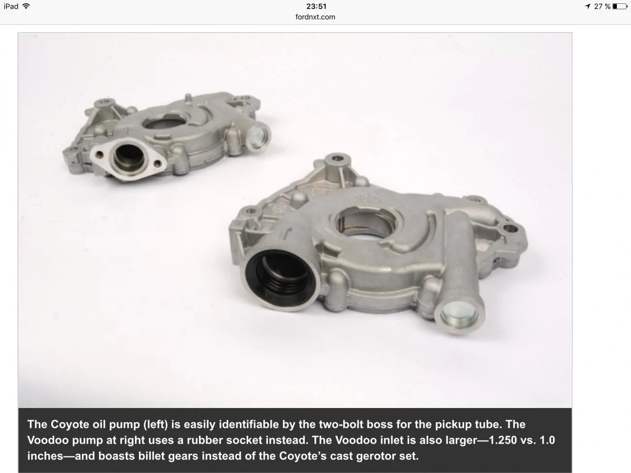

I wouldn't be terribly surprised if they put out a TSB with a tune that brings the limiter down from 8000rpm to something more sane like 5000rpm when the oil isn't up to temperature. I think this is, what, at least the second if not third report on this forum of a likely OPG failure from not being warmed up.

Who said the Voodoo OP didn't have billet gears !

GT350 needs billet OPG. You could buy aftermarket billet OPG but then that will void the engine warranty.
