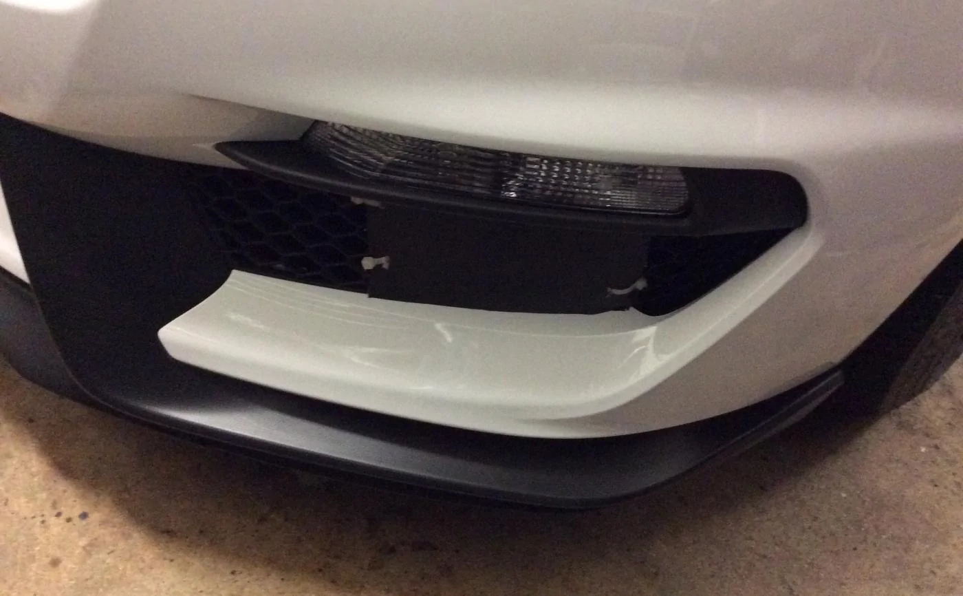

Black cardboard piece zipped tied to driver's side vent. For really cold days (40's) the entire vent is taped up.
Great idea to block the cold air to the engine oil cooler on extremely cold days. This way the thermostat in the water lines with coolant can actually regulate things as needed. I wonder if the oil to the oil cooler has any sort of thermostatic control, as if it does blocking it would of course not be needed?
Nice!
So far I've only driven in 70 degree as the highest and my oil Temps would only get to 203 and that's when I was getting on it. Then it would quickly drop down to under 200.
So far, it seems like they want the car to run right around 200. What is the highest we want this car running, because for street driving I may just put on the cardboard and leave it there until we reach the 80s.
