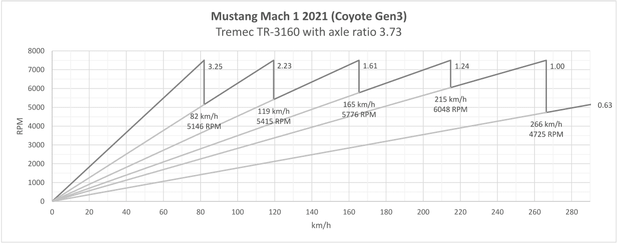

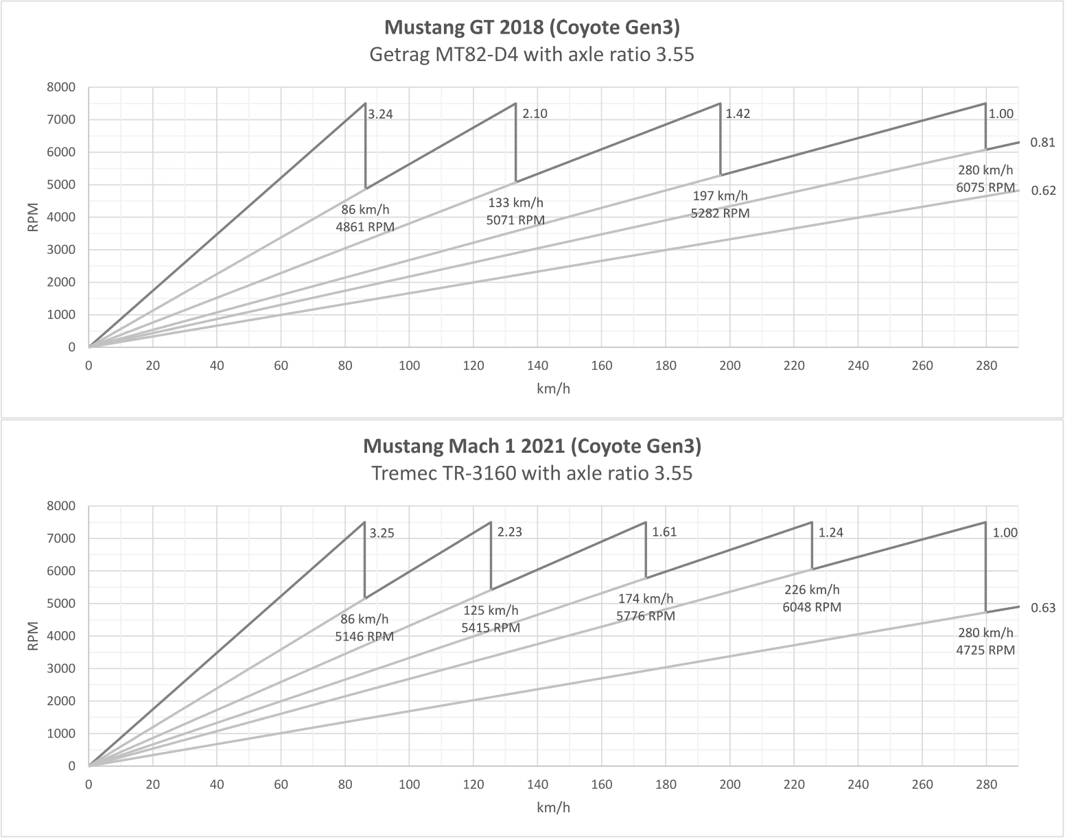

Stop!
It was you who claimed that there are European transmissions that are much better.
Mexico (where Tremec is based) is obviously not in Europe!
I am not aware of any European manufacturer using Tremec gearboxes in large-scale production.
That the Tremec is technically more sophisticated than the MT82, no one here has denied.
You also want us to believe that there is something wrong with the gearing of the MT82.
Let's take a look at both.
The information was prepared by someone from the German Mustang6 forum just for you. 😜
https://mustang6.de/viewtopic.php?f=51&t=19236
*Attention, the axle ratio is different for the US spec than for the EU spec!
Oh and wonder of wonders, the transmission in the Sport Mustang is shorter geared.
Manufacturers have been doing this for decades to emphasize the sporty character of a model.
As you can also see, the MT82 never drops below maximum torque.
That would be my approach.
However, the GT also looks like a sports car compared to your Fiat Diesel. :wink:
For comparison:
US spec Mach1 axle ratio.
For conversion: 1 km/h = 0,62137 mph

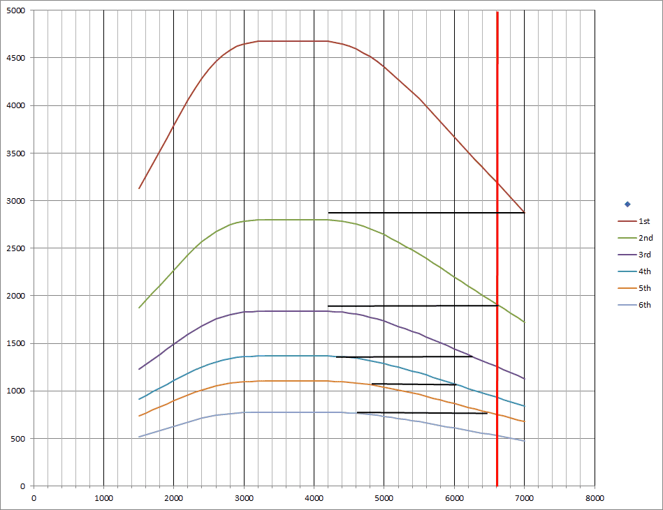

This isn't the whole story. To effectively show the efficiency of the transmission gearing to the engine torque, you have to calculate the torque to the wheels and then convert to thrust.
The above is the MT82 from a 2017 ecoboost with a made up torque curve. My humble opinion is that the only thing wrong with the gear ratios is how low first and second gears are. This is magnified with the coyote.
