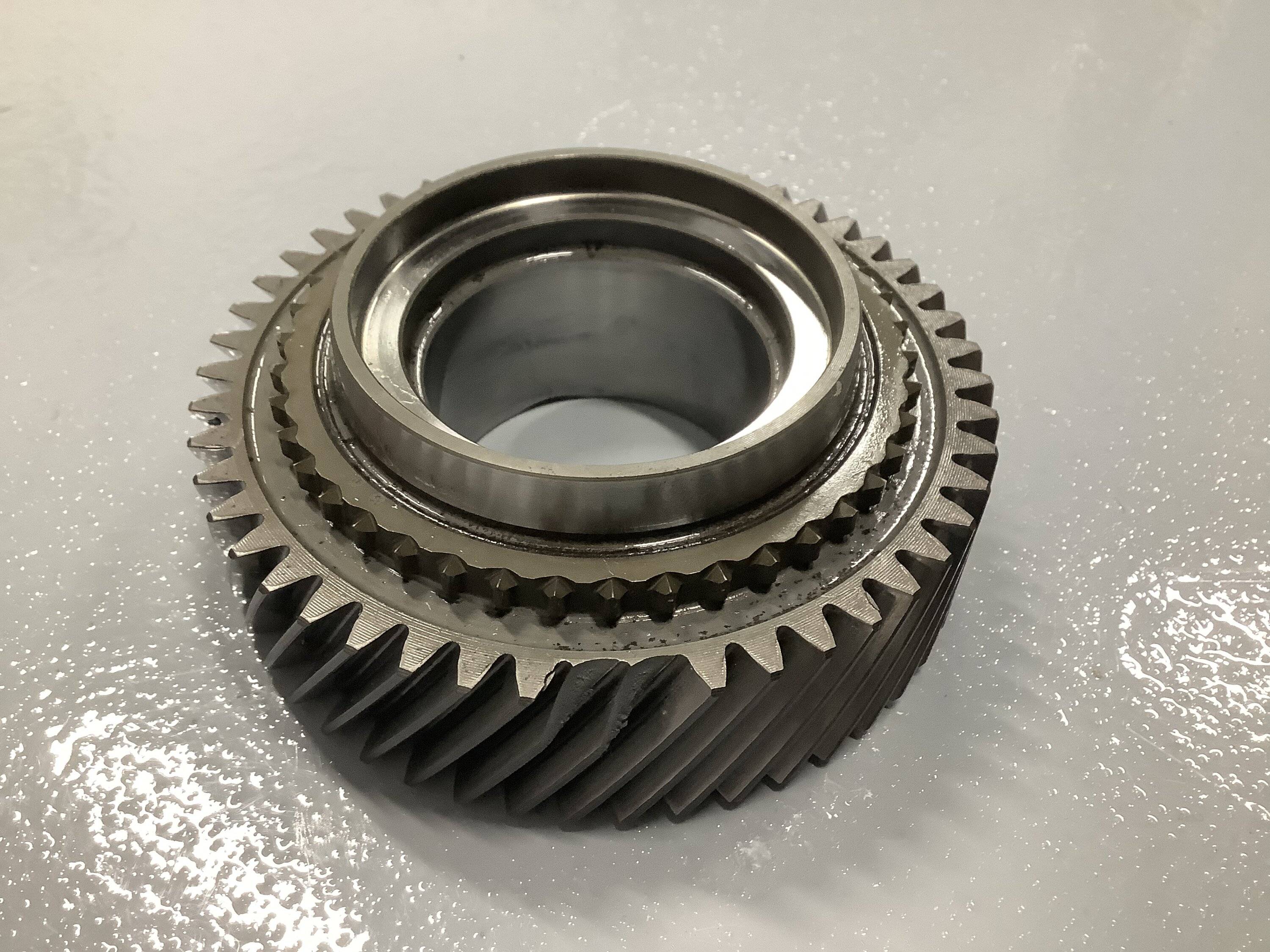

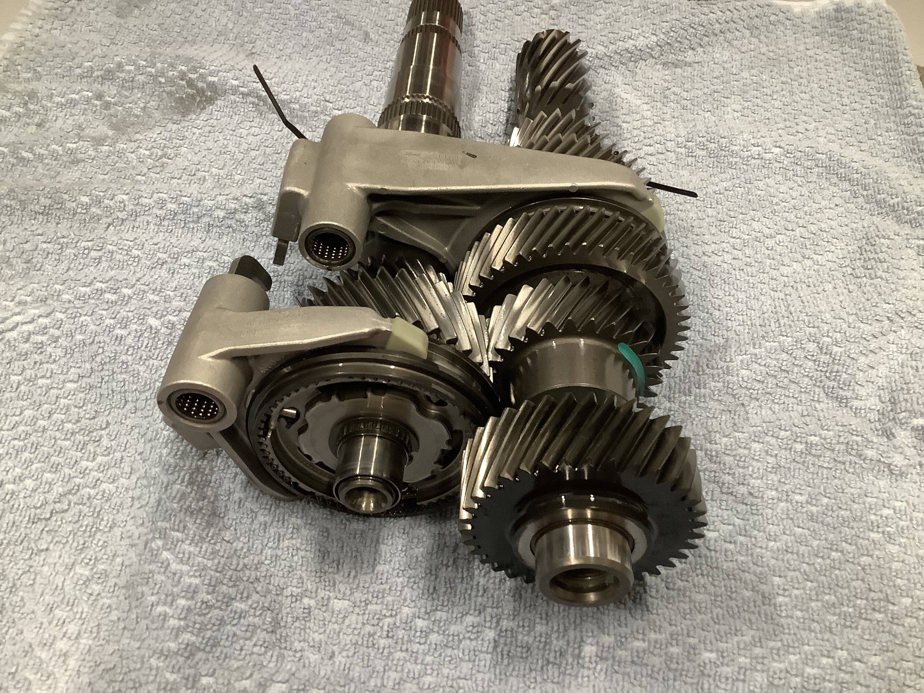

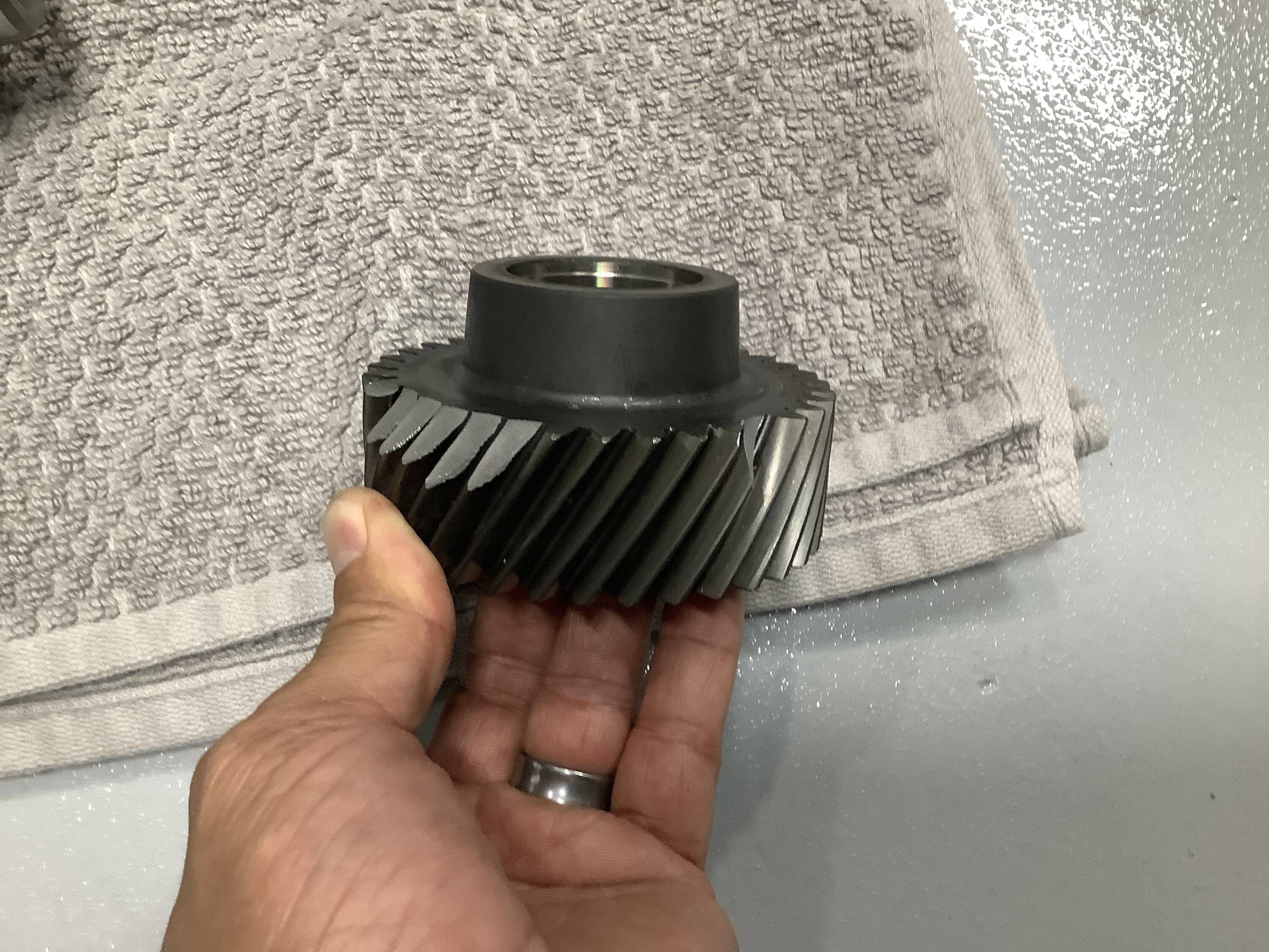

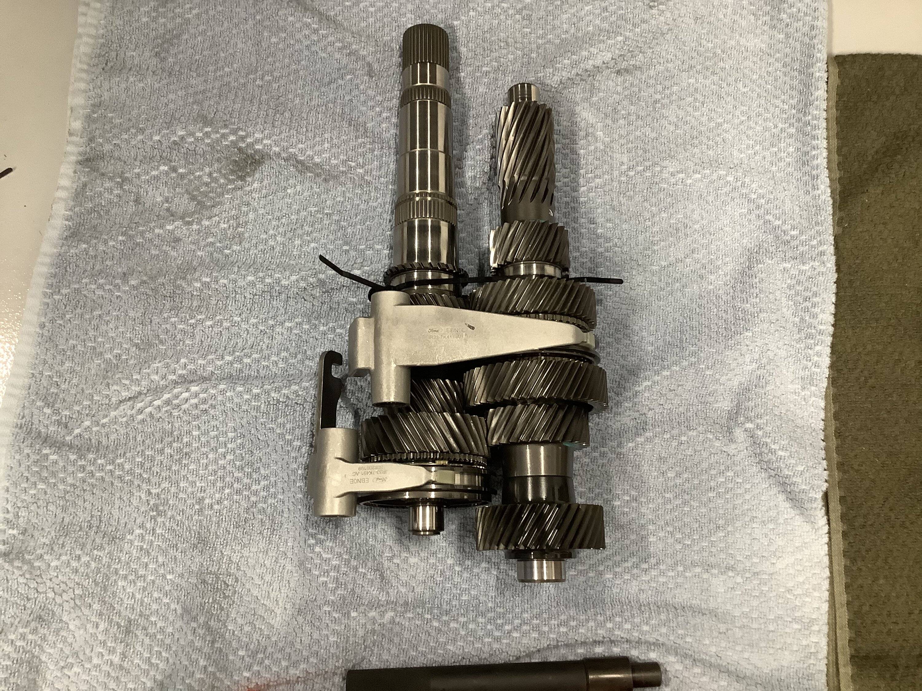

I recently took my MT82-D4 (with 6K miles on it) apart to rebuild it with better and/or enhanced factory parts, to hopefully improve upon its shifting and make it stronger. I will say that after a few high rpm lockouts and grinding on the 1-2 and 2-3 shifts, the gears and synchro looked brand new. However, when I was pressing 5th gear and 6th gear off the countershaft (used 3rd gear to pull 6th gear), several teeth popped off of 5th gear and 3rd gear. 5th gear looked like a powdered metal gear and was also the only gear that was different in color than all other gears. I also read that Ben Calimer said 5th gear is a weak gear. I do think a lot of the issues experienced by MT82-D4 users may be clutch related.

I should also add that at the time I experienced my lockouts and grinding, I was running a Steeda Tri-Ax race shifter, Steeda adj. polyurethane motor mounts, Steeda STH kit, Steeda diff. bushings with through bolt kit, Steeda subframe bushing support kit, Steeda Differential bracket and either a Whiteline transmission bushing insert or Boomba transmission mount with black bushings. All of this was done to be proactive and mitigate any of the reported problems associated with this tranny.
Sheesh! Good thing you pulled that transmission, but there is no excuse for that in a new transmission on a high-powered car. Quite frankly, that should be warranted.
