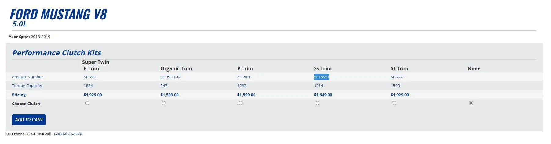

Spec seems to have enough holding capacity. Centerforce claims to have enough force but I'm not so sure. any recommendations? I'm not too sure which on I would want. I should see ~1300 WHP on a sheet at some point but of course riding around like that wouldn't be the plan.

I will need those and maybe a CF DS with repeated beatings: I don't plan on drag racing just more half mile and circuit stuff when I get a chance.
Edit:
Will you be removing and reinstalling the tranny yourself? I found it to be a bit of a PITA (more so, tedious careful work to avoid resting the weight of the tranny on the input shaft and making sure it seats against the engine block without forcing them to come together). With that being said, I would want to use a clutch that will allow you to grow into it since you’ll be adding more power. If you don’t mind pulling it again to upgrade the clutch down the road then I would say get what is capable of handling the current power level.
I went with the Ram Pro Street twin disc cerametallic. It’s definitely a much different feel and harder to drive on the street than the factory organic clutch. I haven’t learned to able to really slip it, which makes it tougher to drive at slow speeds. I haven’t stalled the car yet, but have come close a few times. It seems like the clutch is either on or off. It’s more clutch than the car needs, but I was aware of that going into it. I just accepted that because I didn’t want to be pulling the tranny anytime soon, so that was the determine factor for me.
This one is the one you bought?
Ram 60-2239 2018-2021 Mustang GT Pro Street Dual Disc Clutch Kit w/300 Series Discs (lethalperformance.com)
I'm thinking P SS or ST trim
