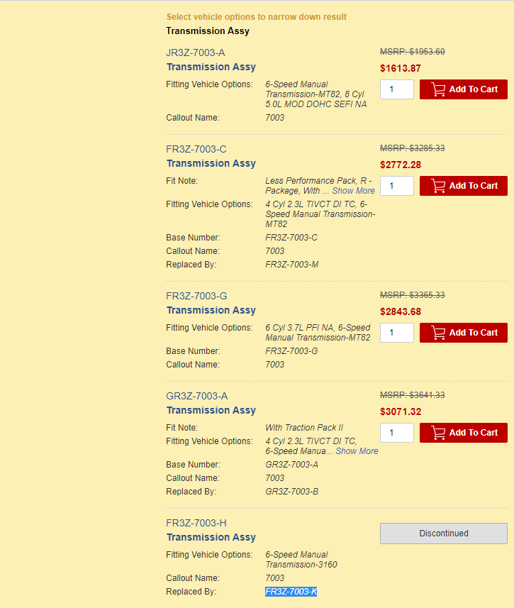

I don't know if the differences are relevant to you question, but info like this suggests there are at least 'some' differences :

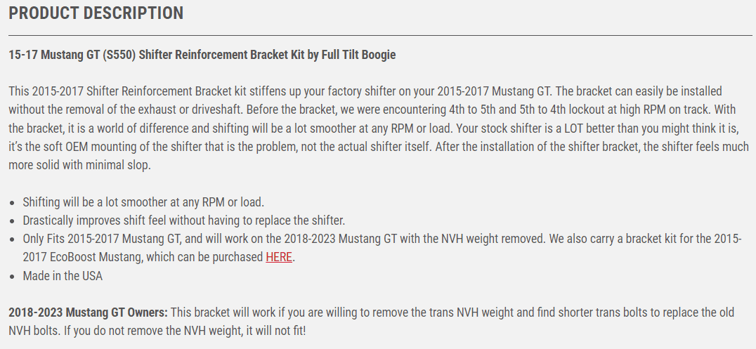

I know that, but note these comments from the GT advert :
And these comments from the equivalent EB advert :

I didn’t, but in reading the adverts for the GT and EB, the mention of removing the NVH weight makes me think that the casings are similar. I don’t know much about the EB tranny, but if someone can confirm whether it does or doesn’t have Rev matching and the gear position indicator on the dash like the GT, those would be a couple of differences off the top of my head.
