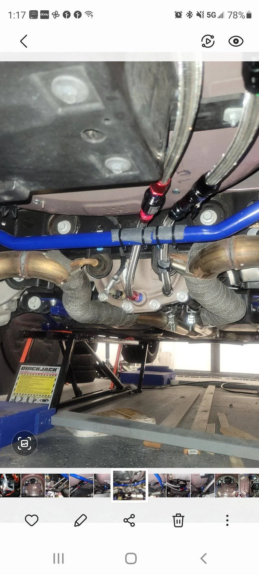

Thank you! Well noted on the orientation of wrap, and HT silicone.
I have a 2020 with the in-car temp gauge for the rear diff, which is mainly what I was watching while on the track. I wouldn’t need the temp sticker in that case correct?
As you already have noticed, you don’t really have time to look a gauges when you are on track ( it’s why race cars have warning lights on top of gauges) and it’s very distracting, the label allow you to know what is the highest temperature reached by the differential and concentrate on driving

Here is a photo of how I have my header wrap. Wrapped it from the back going forward with a 50% overlap and when I got it up front where I wanted it, I used a good old hose clamp to button it all up. It has been in place without any readjustments for three years now.
