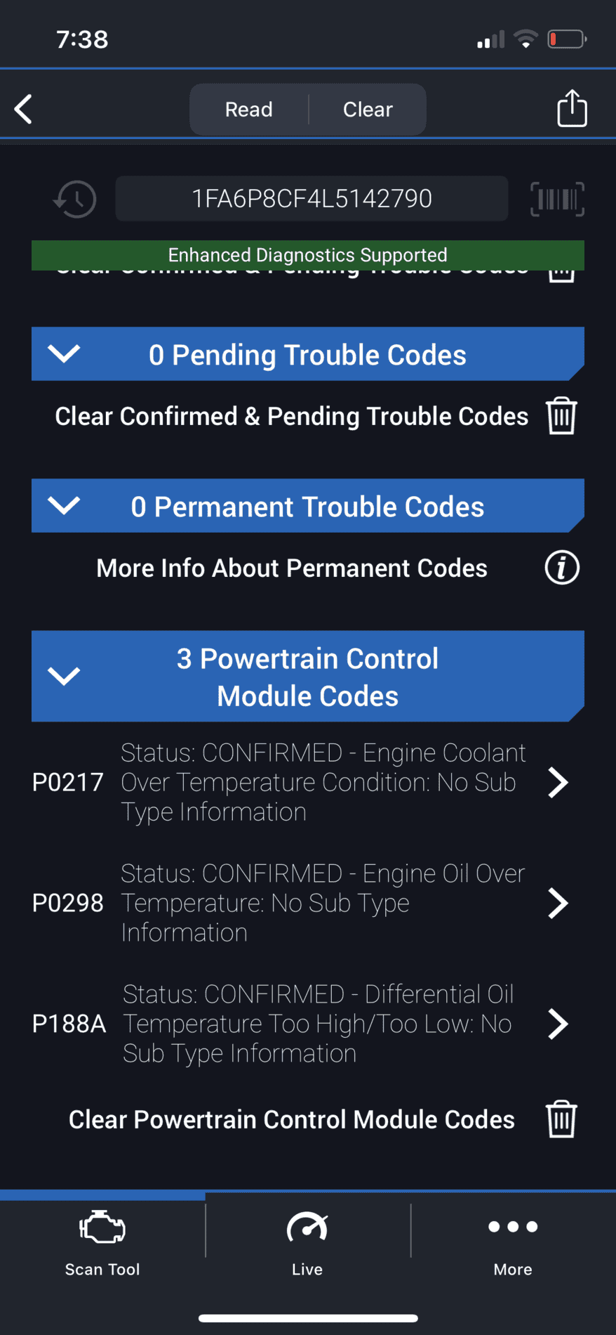

That’s what I was hoping for, being a newbie and all. But I ended up worrying about the car overheating….which was an annoyance/worry while trying to drive the correct lines. You can see in some of the videos I’m toggling the steering wheel button trying to check my temperatures. I was very aware of my mirrors, and pointed folks by quickly and safely. Thankfully the track was open all day, 29 people total, and we would go out when most came in. So thankfully no traffic and I only had to point by less than 10 times the entire day.
I scanned my codes tonight - this is what popped up.
