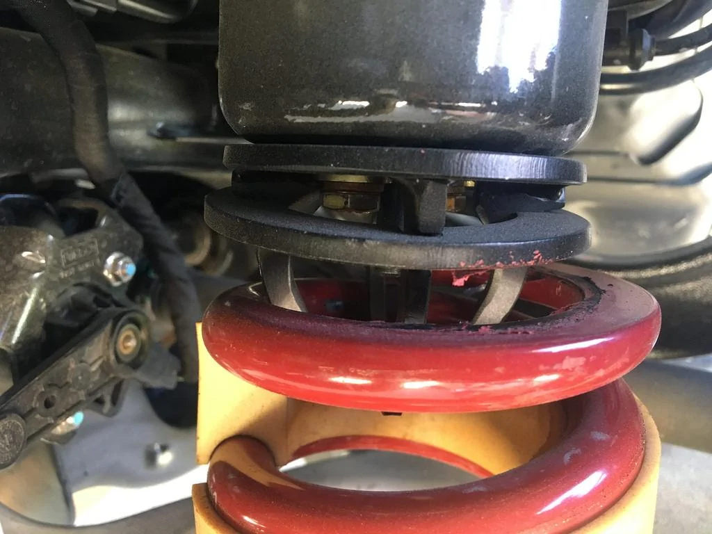

JRZ Adjustable Articulating Rear Perches
Hyperco 2.25ID 5" 1600lbs Rear Springs

Steeda Spherical/Delrin Rear Adjustable Camber Arms (modified)

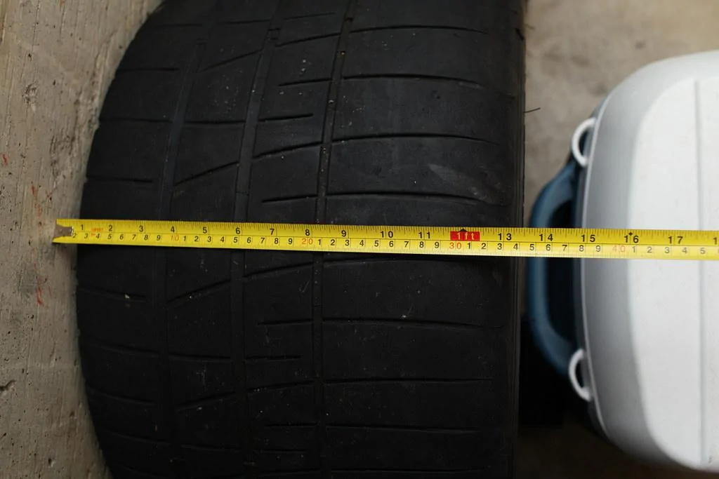

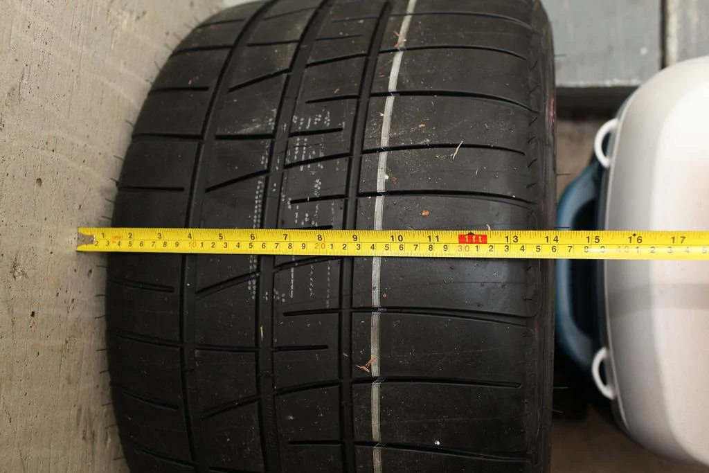

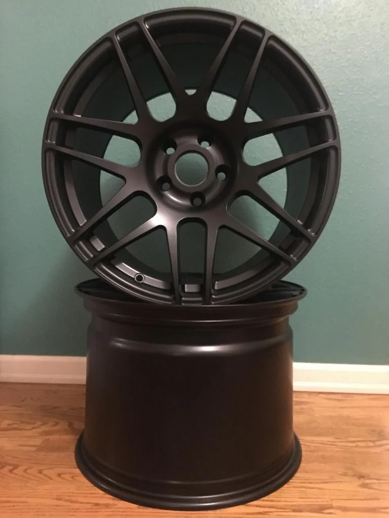

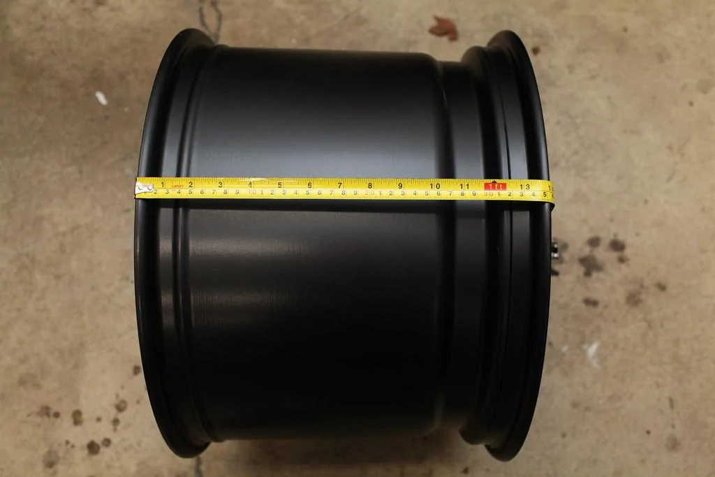

I've been running an 18x12/335 setup quite successfully for the past few seasons, but I'm always looking to maximize my grip in the pursuit of those precious tenths on the clock. I was able to reclaim some inboard room this off-season by doing a lot of testing/math to determine what actual amount of travel I'm using up front for the various spring rates I've run over the years. The end result was the conclusion that a 5" spring "should" give me "just enough", which, in turn, allowed me to relocate my perch back above my tire for my desired ride height for additional inboard clearance. The natural conclusion was, "Hey, now I can fit an 18x13 up there!", and the end result was this showing up at my front door after (4) months of waiting (thanks [MENTION=27078]Paul@PKAUTODESIGN[/MENTION]!)

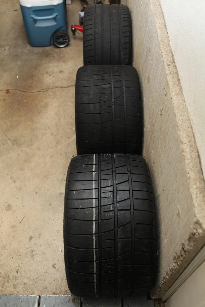

13" from bead-to-bead but almost 14" overall width
4yo for scale
I tried to weigh them, but couldn't fit the damn things on my scale because they're too wide! I did weigh holding a wheel though, and it comes in at just under 25lbs - surprising, because they're basically the same weight as my 18x12 - biggest difference being the face (F14 vs. CF5), since the barrel on the F14 rev2 is the same as the CF5.

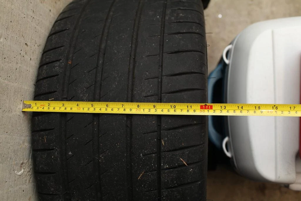

So how much wider are we talking? Here's a comparison of my various setups:
19x11 | 305/30R19 Michelin Pilot Sport 4S
18x12 | 335/30R18 BFG Rival-S
18x13 | 335/30R18 BFG Rival-S
Ultimately, I've added an additional 0.75" of tire going from 12-13 on a 335, and the visual stretch of the sidewall (which was the desired outcome) should give me more sidewall support on a tire that tends to feel a little numb at the limit.

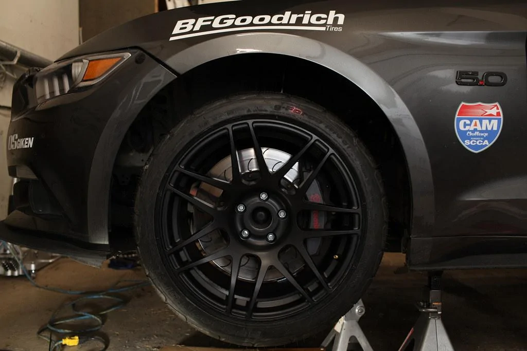

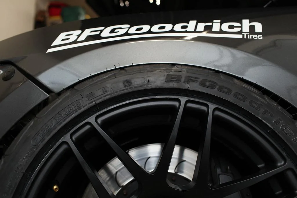

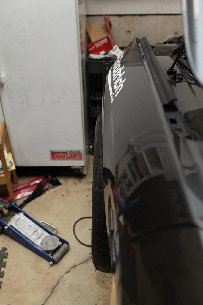

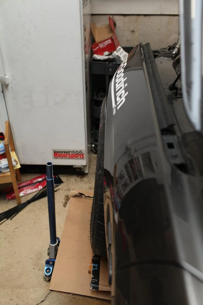

So how does it fit? Let's take a look!
Front, full droop:
Front, maximum compression (fender limited):

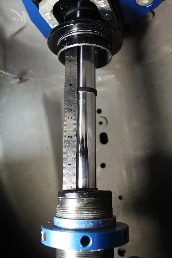

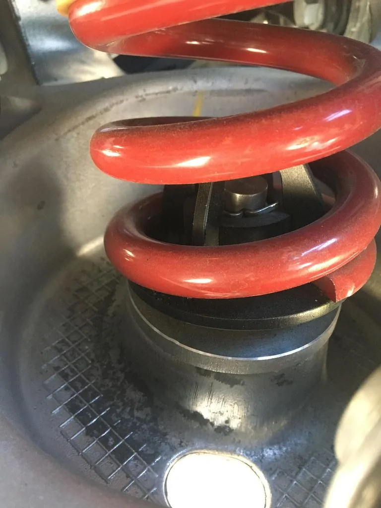

Here's how much shock travel is left right at the point of fender interference:
While it looks like a lot of travel left on the table, I've actually never experienced compression travel this far on a 700lbs+ setup - and now with a 5" spring, I'll reach block height before I ever reach this point. But block height is also past the point of maximum compression achieved, so the end result is - 18x13/335 works up front! :D
Apologies about the rear - I thought I took some pics, but apparently I didn't - suffice it to say that with some parts relocation, I moved almost all the additional width inboard, and used up what additional fender clearance I had left. Nothing on the table, it just barely fits, but with full compression travel without any fender or shock/frame interference! I'll remember to take some pics when I have the rear suspension apart in a few weeks putting in some final spring/alignment touches ahead of my California swing.
Of course, the proof will be in the pudding - I've got my first event of the season next weekend. But with 40deg temps (and most likely rain) in the forecast (par for the course this time of year in the PNW), I probably won't get to test the new setup until the Fontana Pro Solo in late March. Not ideal to be testing at a national event a thousand miles away, but I'll make it work - or not, lol. Stay tuned!

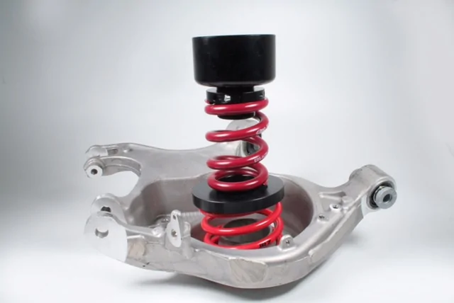

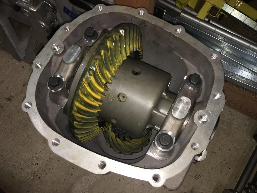

You do this work in your home garage (or in the parking lot at events when something breaks :( ) without a lift, correct? :thumbsup:

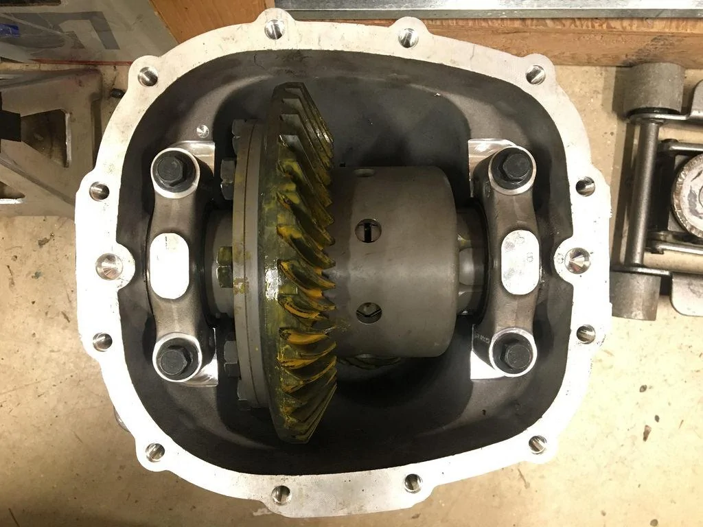

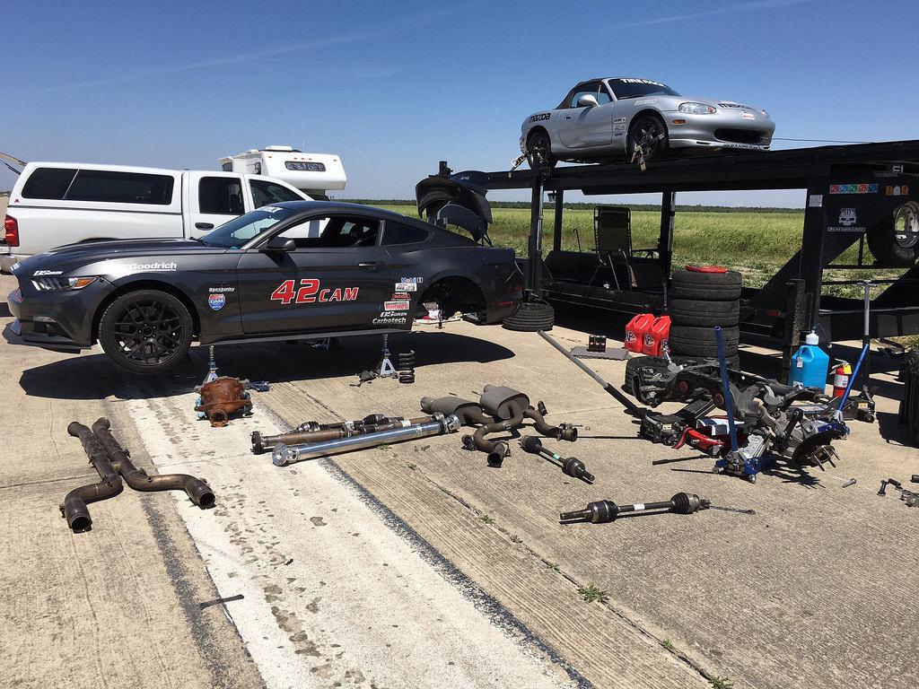

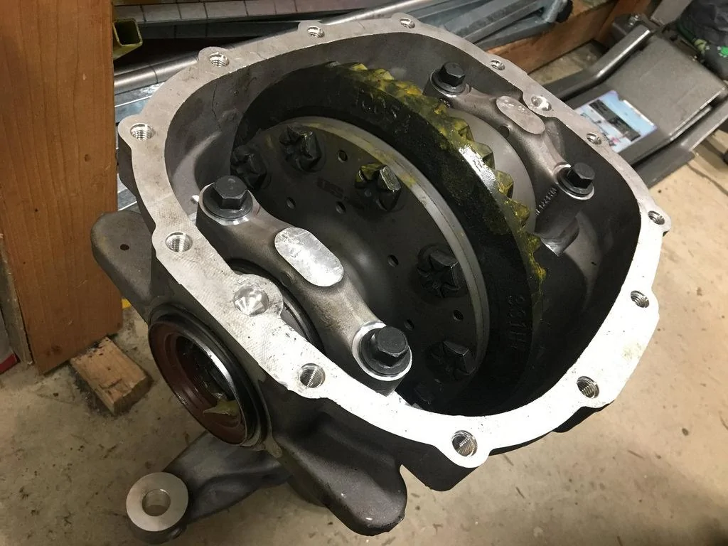

yep. i probably passed the point of this being a good idea for my quickly aging body a few years back, but you work with what you have! btw, i do not recommend changing a rear-end on site - yardsale!

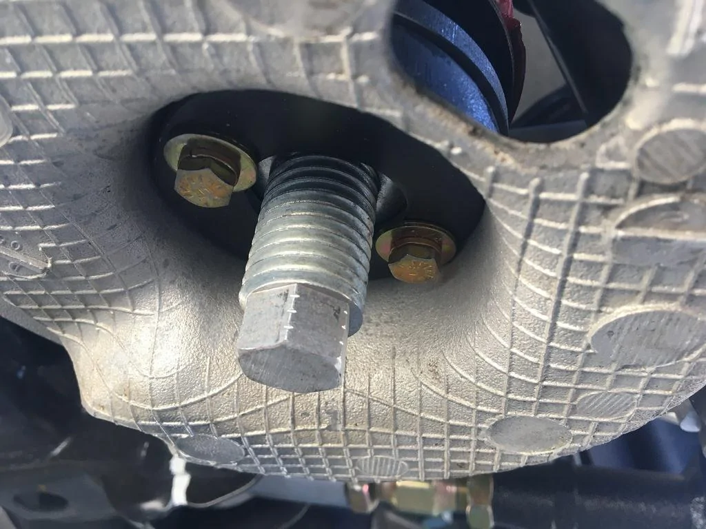

on a positive note, i drilled out my diff cover threads and am now running 14mm 12.9 bolts - which makes it a helluva lot easier to swap diff carriages, since you don't have to drop the entire subframe to access the bolts (since it's now a bolt-through setup with the heads facing inward). 1-2 hours now, depending on how motivated you are :)

That weekend boardkat got his car back together in time for the event and whooped all our butts. Pretty crazy, lol.
Do you have a link or contact info for the fancy rear spring setup you got?
stay tuned. i am currently "in limbo" with a distributor due to purported issues with JRZ, and don't want to recommend or throw anybody under the bus until i figure out what's going on.

On the topic of iterating, I finally got my 3rd (!) diff carriage put together. A fellow autox'er (thanks [MENTION=20453]ihavefat[/MENTION]) sold his S550 and never got around to installing his OS Giken - for a price I just couldn't refuse.
In my experience, you can never have enough powertrain spares, and it's nice to have a different FD to boot, as I finally put a ratio I always thought I should have been running to the test. And if it's too much of a compromise down low, well, that'll be fixed very soon anyway :D
Unfortunately, I won't be able to put enough break-in miles on it before the event this weekend (needs about 1000 street driven miles on 75W140 before putting the golden 80W250 in and actually getting the diff to work), but I'll definitely be driving down to the Fontana Pro with it on the car.
