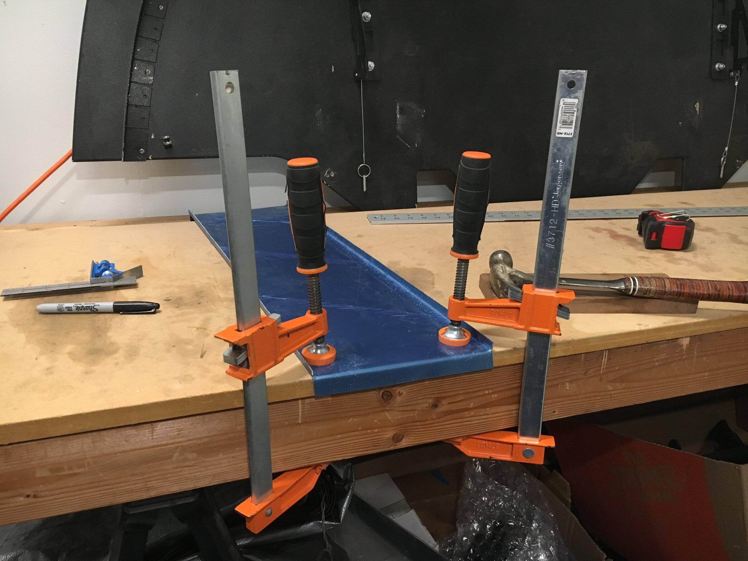

One way to skin this cat. Fluidyne triple pass and setrab 948 for engine oil. Ducting made from 0.040” aluminum sheet.
Next is diff and trans coolers.

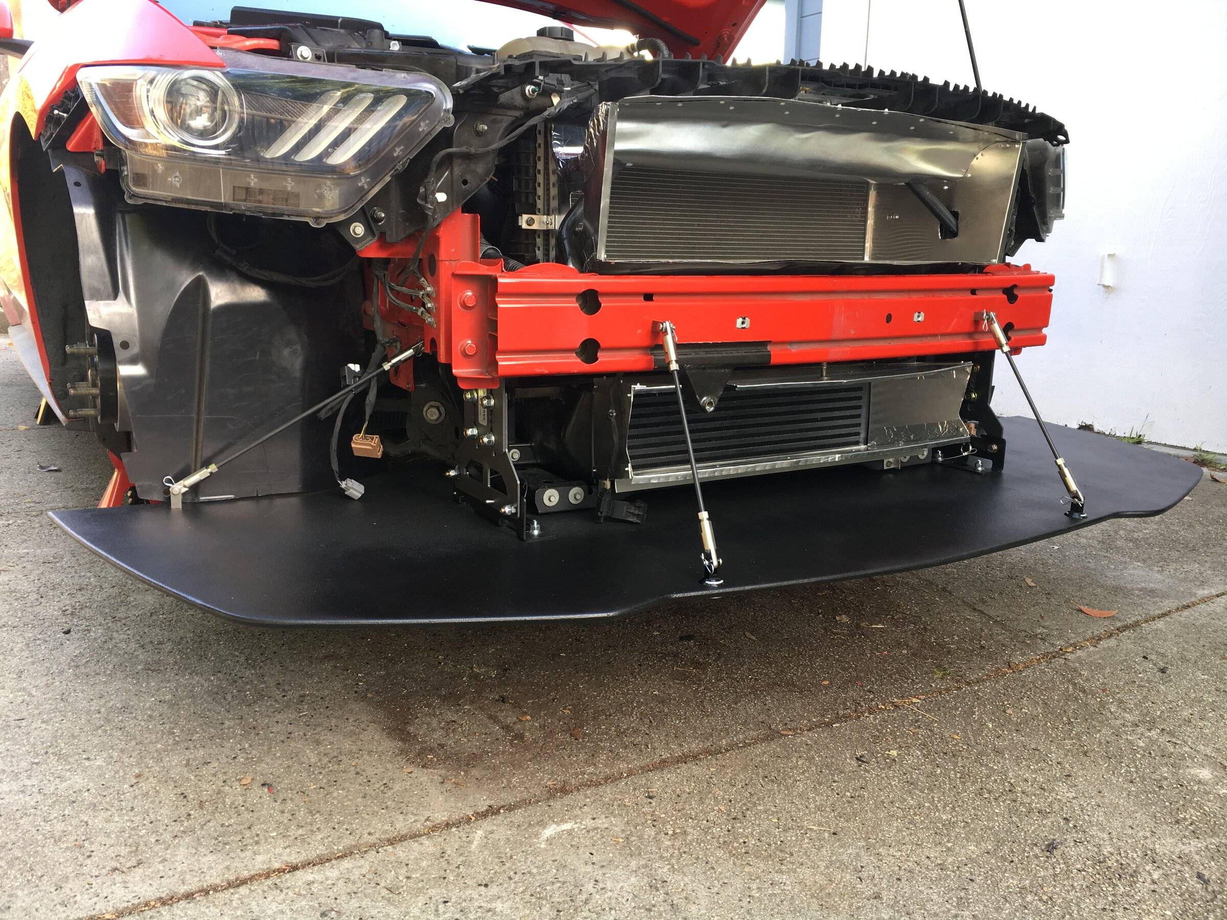

Do you have any other pics of your aluminum ducting? Perhaps after cutting and before installation? Also, what are those lower brackets under the frail rails?
I didn’t take too many pics of pieces before install. It’s a painstaking process figuring out how it all needs to be shaped, bent, affixed, etc. each car will be a bit different depending on your setup.
Only other pic I have is in process:
Those brackets are quick release splitter mounts. Picture with my old ducting setup:
