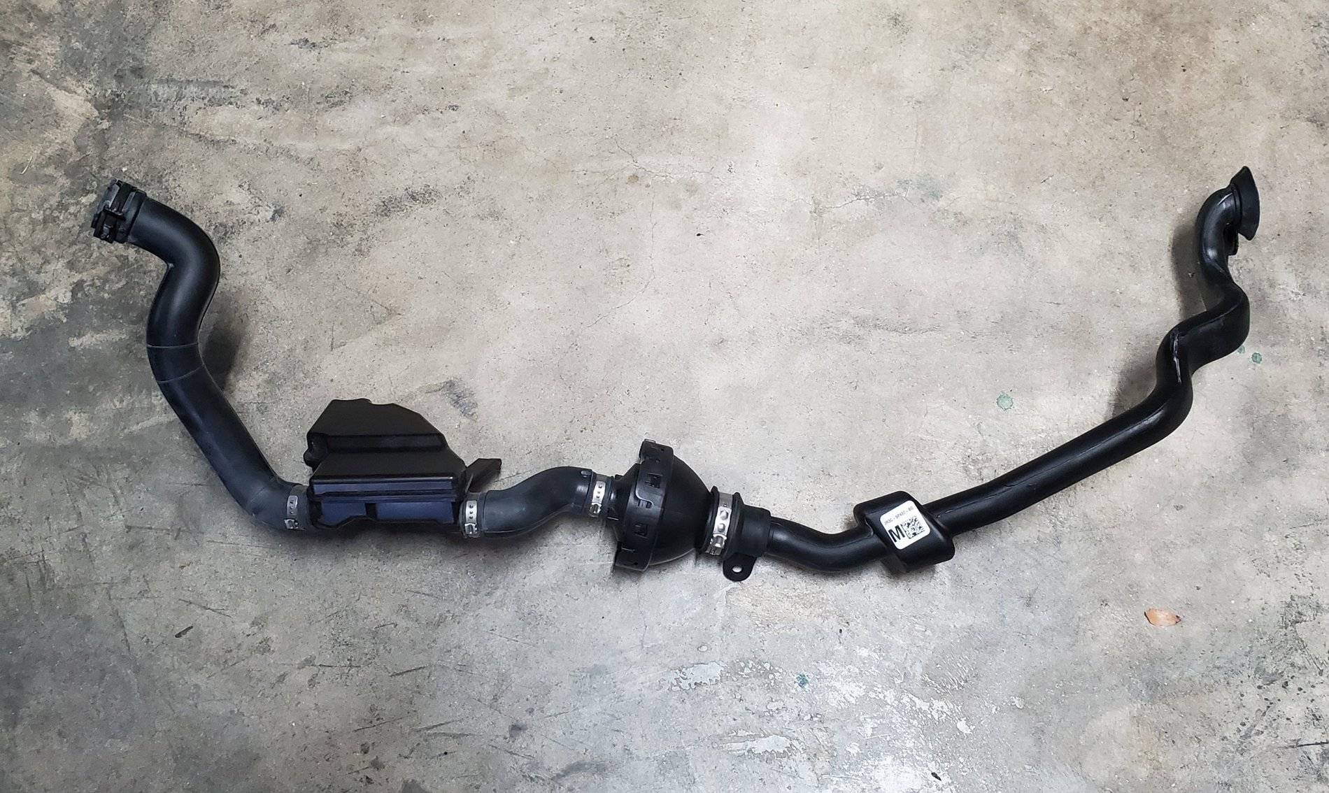

This was the first thing to go on my 2020GT. The tube along with the firewall nut zip tied to it reside on my parts shelf in the garage. 1/4 inch ratchet, long extension, and a deep 10 mm socket with a universal. Capped the Air intake tube and plugged the firewall and you are good to go.
