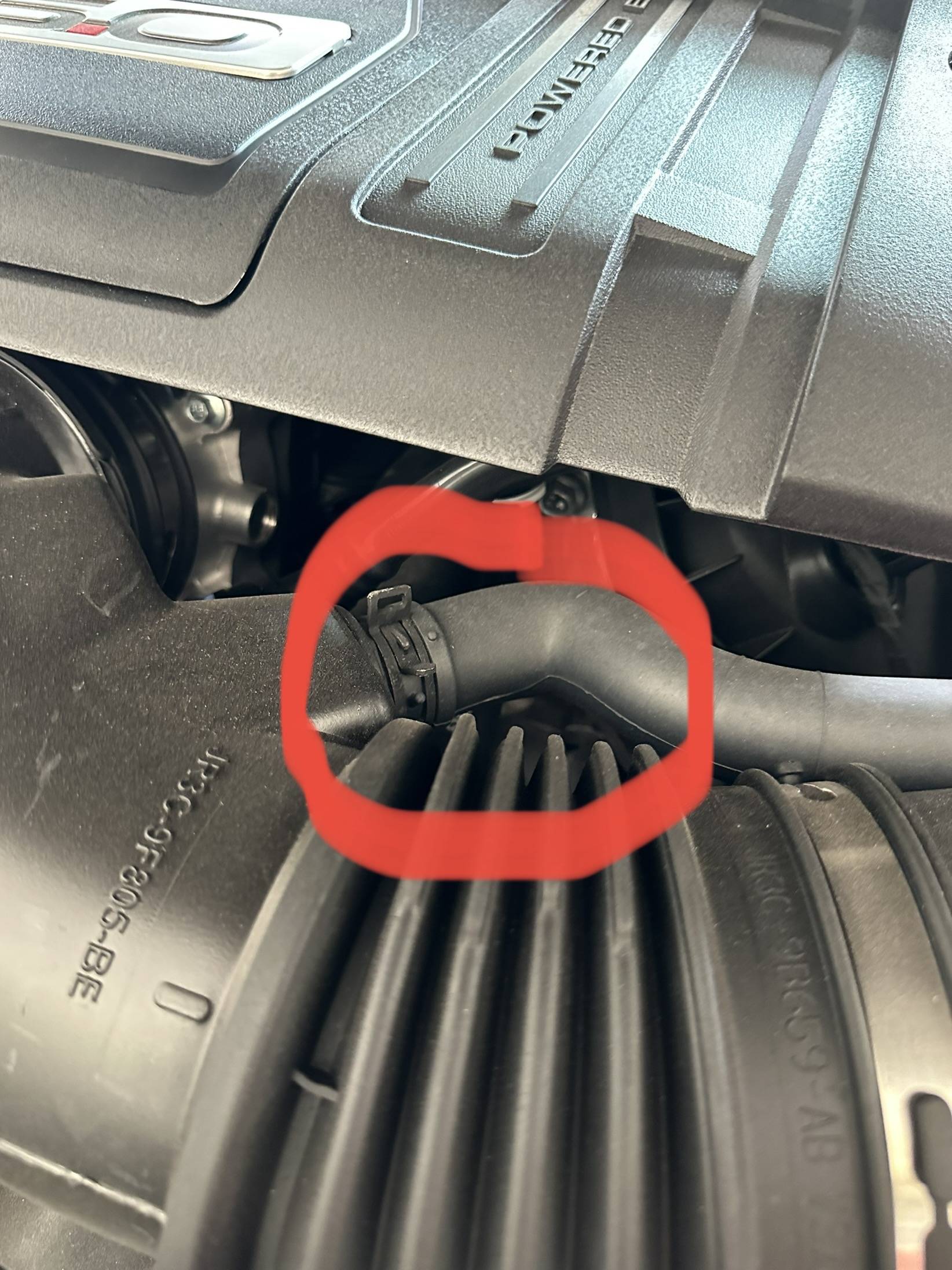

I was reading the threads about the sound tube delete. To see if I like the change, could I just disconnect it at the engine side and plug that for now?
Eventually I might want it gone, but for now I wanted to try it.

You can disconnect from the cold air tube like you pictured and also at the check valve right by the strut tower. Then you wont have a loose tube bouncing around the engine compartment, and if you leave the check valve in place, you won't have an open hole right into the cabin. That's what I did on mine until I decided I liked it better with out the sound tube.

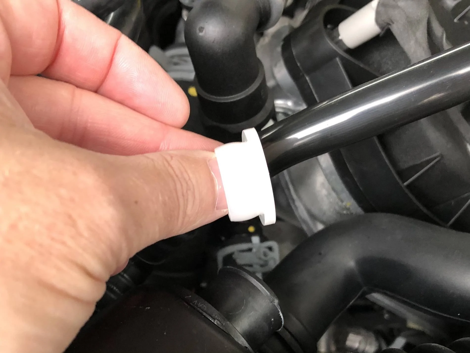

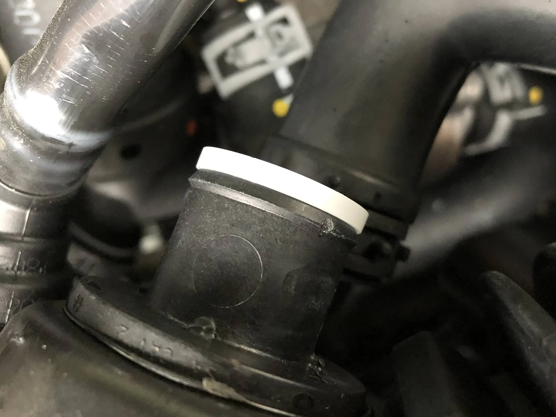

The sound tube got silenced today, but no test drive yet so don’t ask how much of a difference it made ... lol
I plugged mine in a slightly different way to the normal ‘rip it out’ method as I wanted to keep the OE look :
Everything went back together and it looks completely ‘normal’ :like:
WD :like:

That’s a cool idea for those that want to retain the stock look! I thought it looked to cluttered so I was happy to take it out. Still looks like a bit of a rats nest in there but a little better 😎
