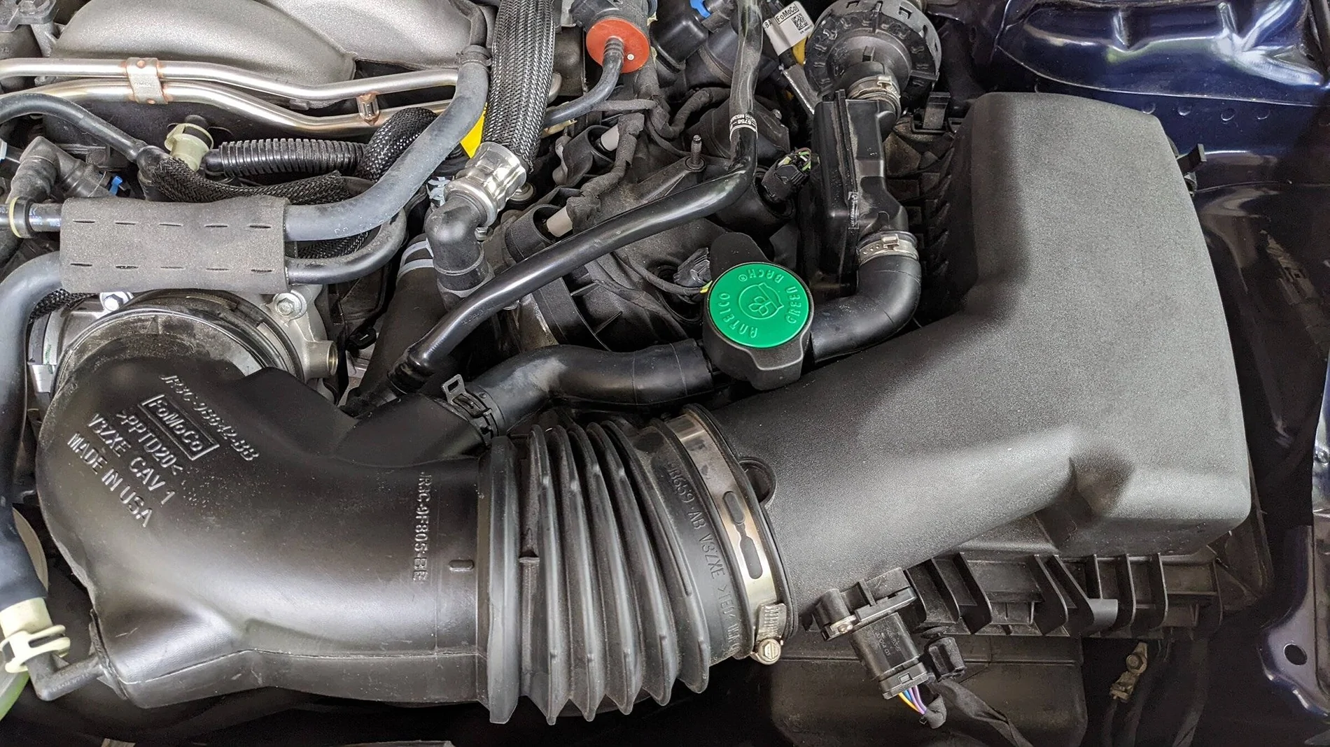

years ago guys were doing this to silence the sound tube. I did this as well, (back in 2022),
and that way everything stays C.A.R.B. legal
