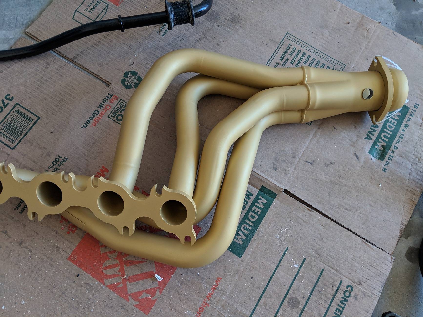

Yes, no need for wrap with this stuff. You wouldn't think a thin coating like this would do anything, but I can reach down in the engine bay and touch the headers within minutes of a long drive with my bare hands. It keeps the entire engine bay so much cooler
Damn. So your saying i should do my headers i spent 2 days diy on jack stands……. Kill me
definitely going to do it when i upgrade opg and crank, that way at least some crap is out of the way

Yeah man, I wouldn't even think about doing headers on these cars without it first. Did this on my 2017 GT Kooks set too back in 2018. If I had to do this a 3rd time, I think I would drop the subframe. Jack stands + Headers = FML

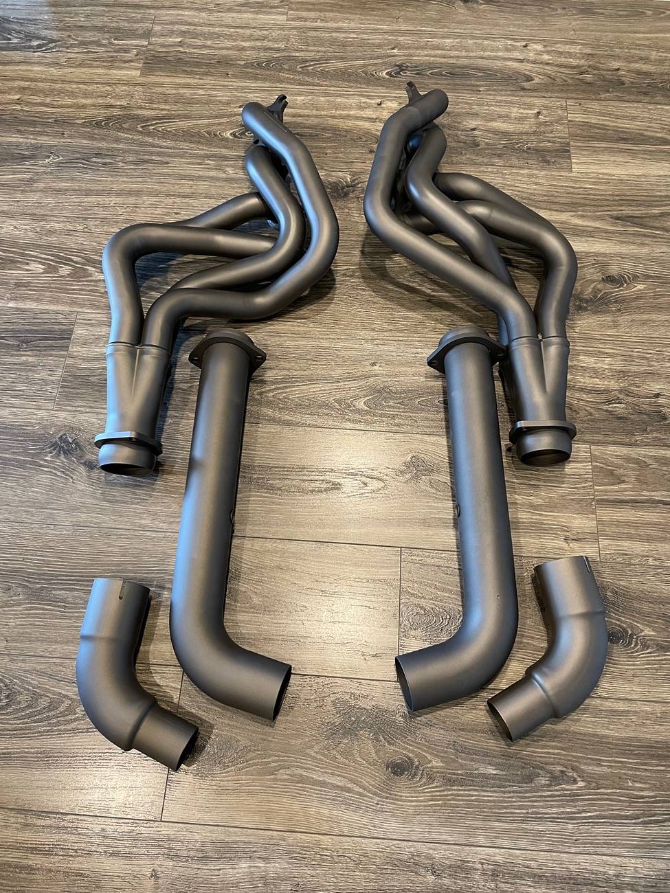

Also on the cerakote train. Found a performance coating shop about 30mins from me. I think I paid $400 to have all of my Kooks stuff done. Even got to pick the color!
How is it holding up?
