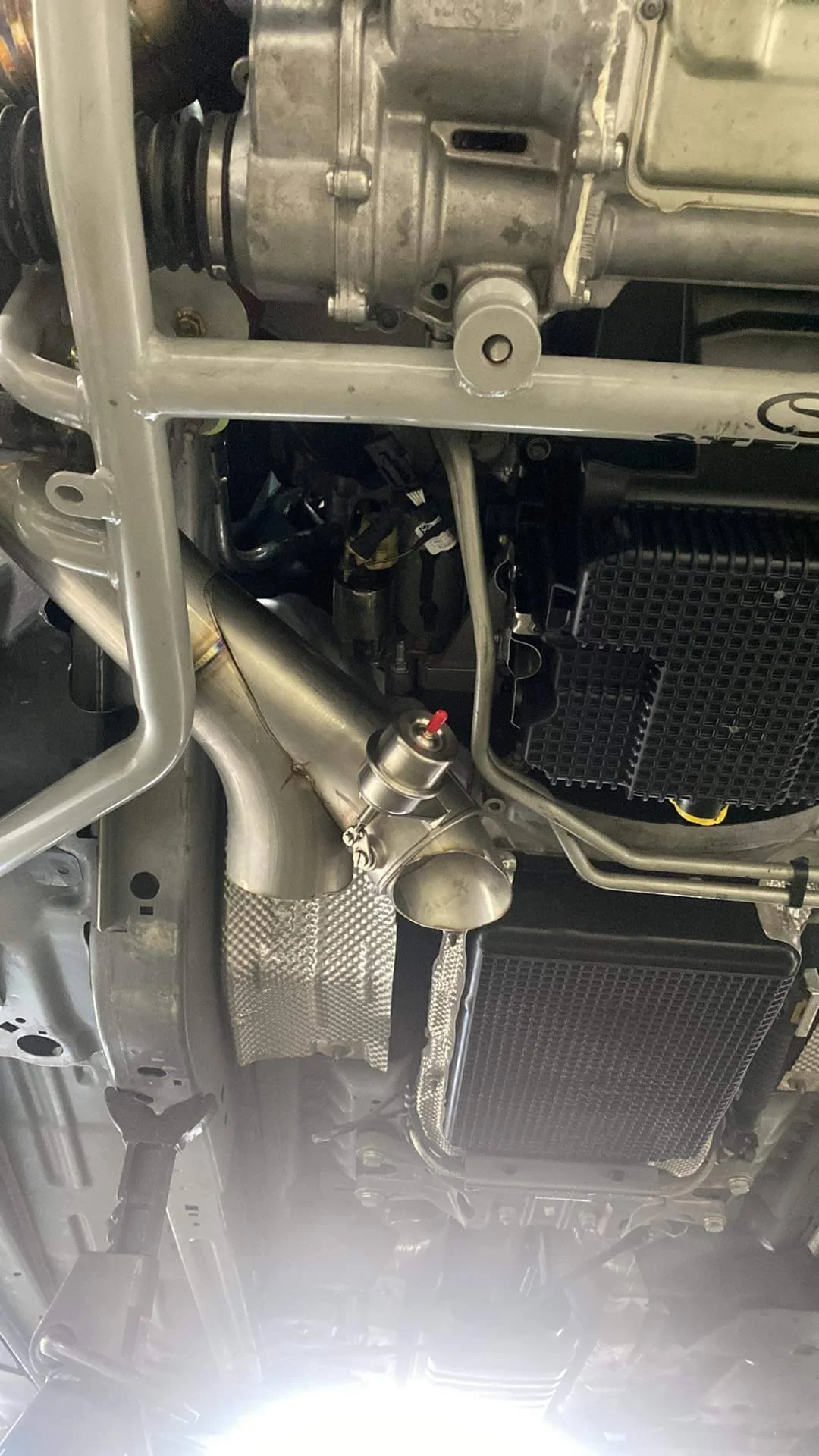

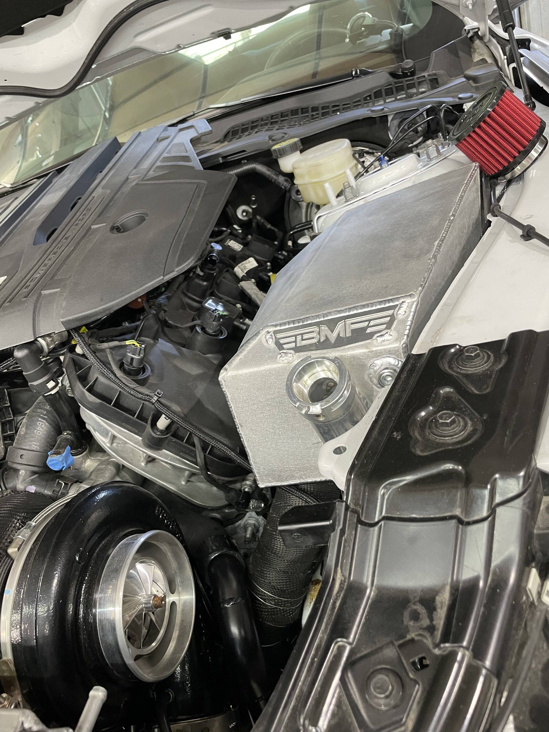

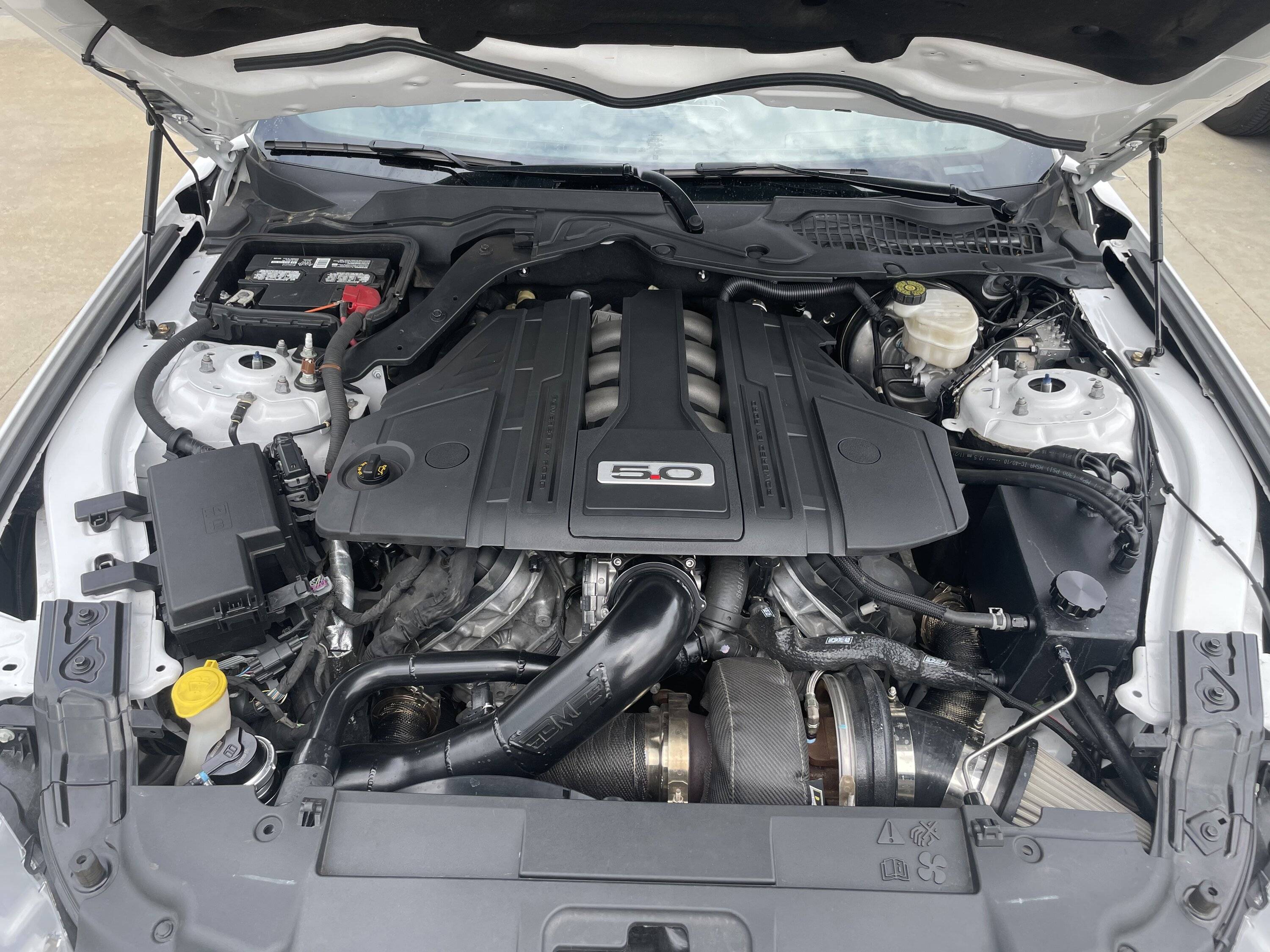

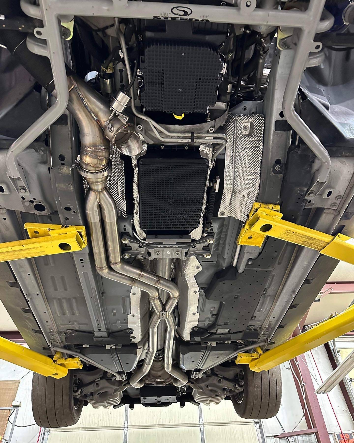

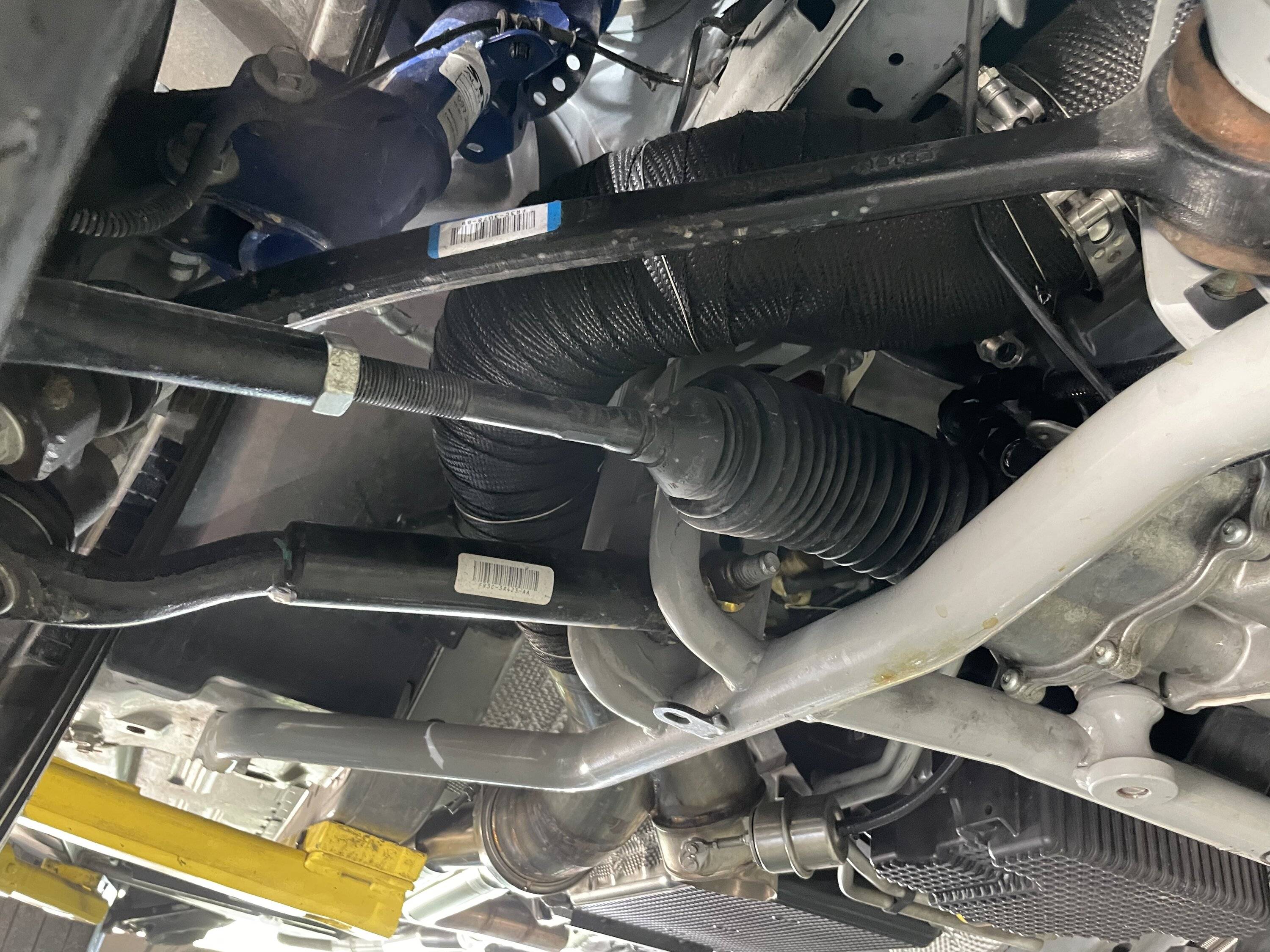

turbo is a forced inductions s400 76/85
we ran the exhaust through k member to keep it off the ground and put on a boost actuated exhaust cut out for when it’s time to play.
I’ve got to get some tires for the car. It wouldn’t hook well at the track. It would spin on the line and then haze the tires in every gear. I think the tires have just gotten hard over time. It ran a 10.66@141 on 9lbs of boost.

Just magic mate. Well done 👍. kudos to your fab guy As well.
pretty much what I’ll be chasing , 10 or 12 lbs and low 10’s. Fun reliable street car.
Nice! Get that 60' down and your well into the 9's. My car went 9.73 @141 on 8lbs of boost.
Incredible work, very nice.
Is that 2.5" dual exhaust?
