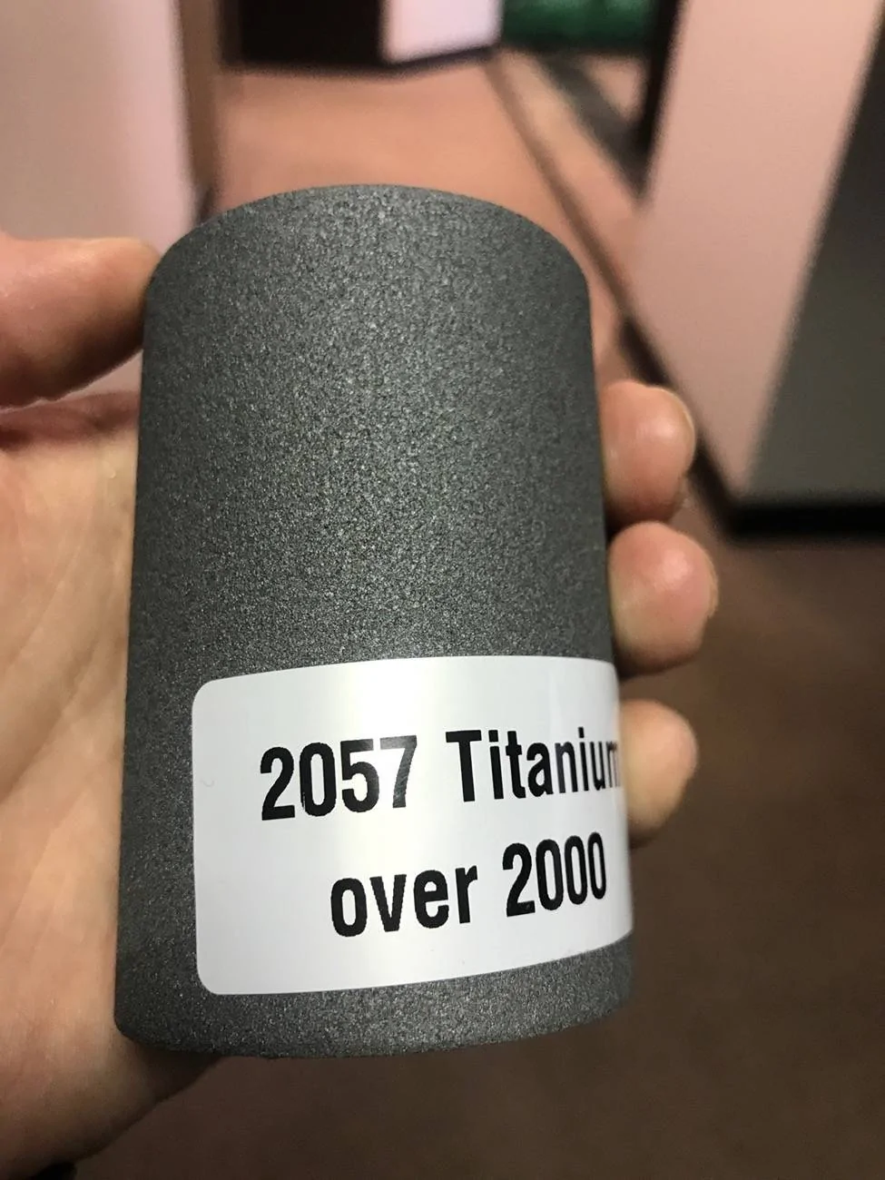

The Jet Hot 2000 series coating is definitely thicker (and more coarse looking, sorta like 80 grit sandpaper) than Cerakote. Here is a pic of their 2500 series coating, which looks to be pretty thick (presumably for bonding characteristics). I would guess that the 2000 series is slightly thinner, but not by much. The second picture is the 2000 series Titanium color sample to show what I selected for my parts.

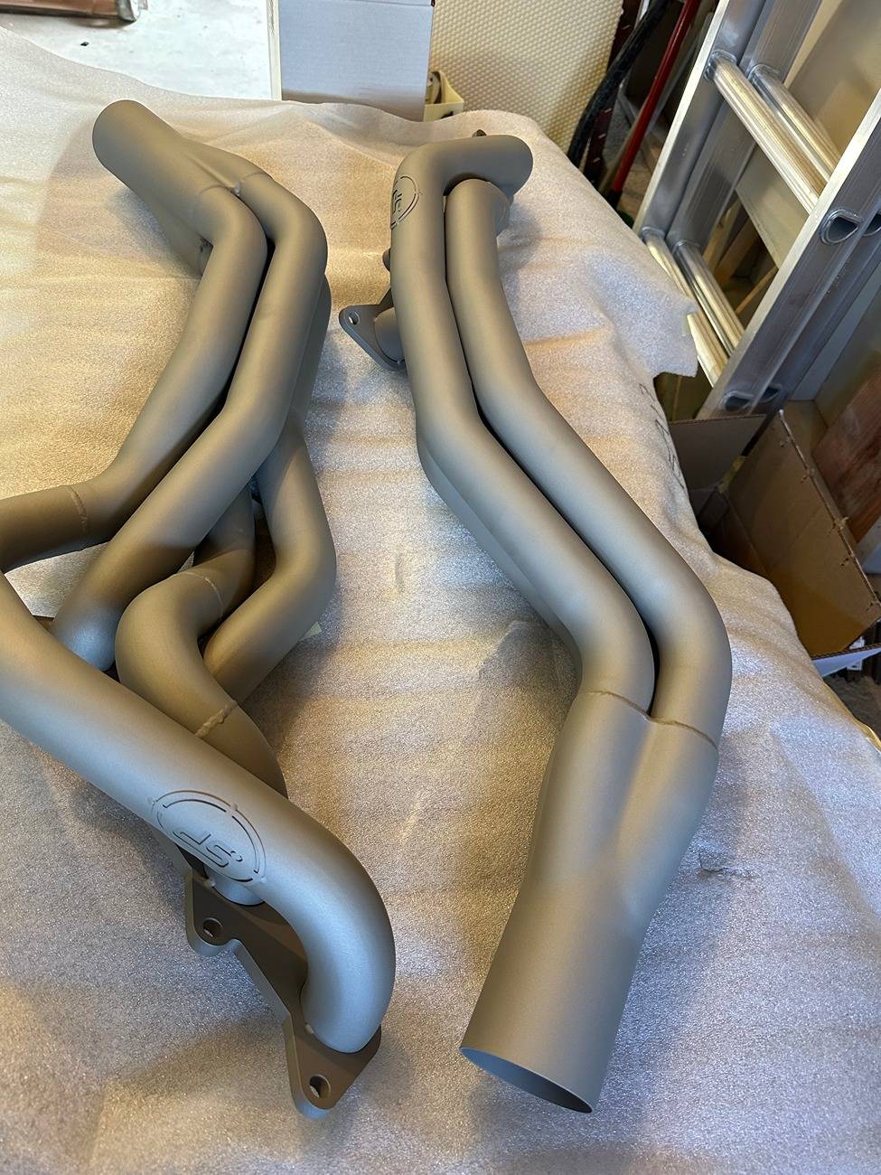

I have done the Cerakote Glacier coating on several sets of headers, turbo manifolds and it makes a dramatic difference in the engine bay temps. They say its good for 1800 degrees, but you have much bigger problems if your exhaust is 1800 degrees at the headers
https://www.cerakote.com/shop/cerakote-coating?finishes=cera_glacier

The coating on those headers looks really good! Did you spray them yourself or send them out to be done?

I took them to a local place that does all sorts of different coating services. $325
Ive had them do wheels, headers, turbo manifolds, guns. They always do good work

Do yall do this without heat wrapping?
ive been considering this on my bimmer downpipe, it sits uncomfortably close to my valve cover and i hate how the heat wrap rusts the stainless steel

Yes, no need for wrap with this stuff. You wouldn't think a thin coating like this would do anything, but I can reach down in the engine bay and touch the headers within minutes of a long drive with my bare hands. It keeps the entire engine bay so much cooler
