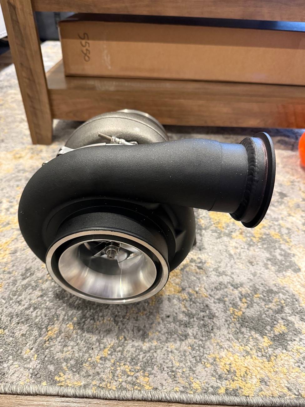

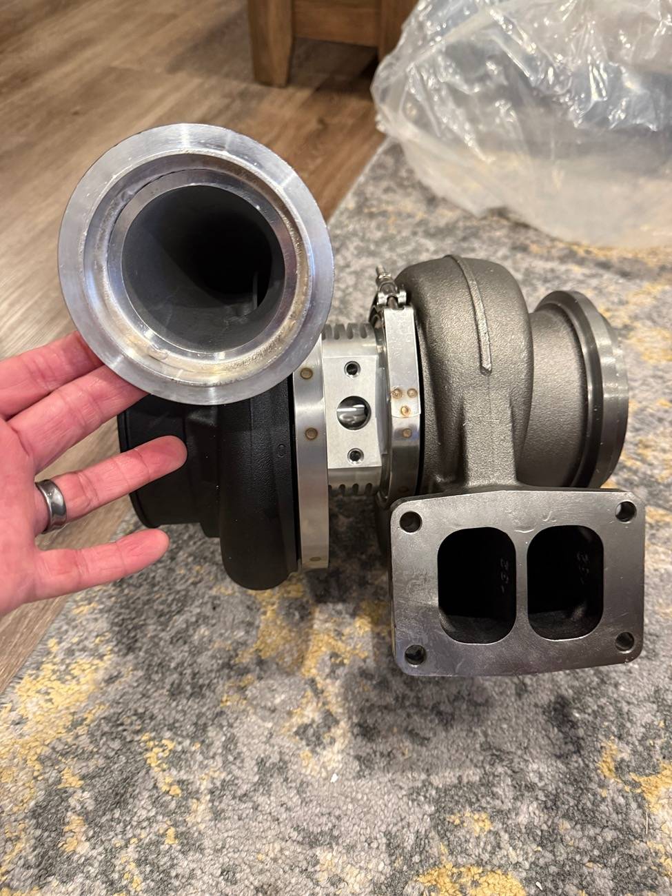

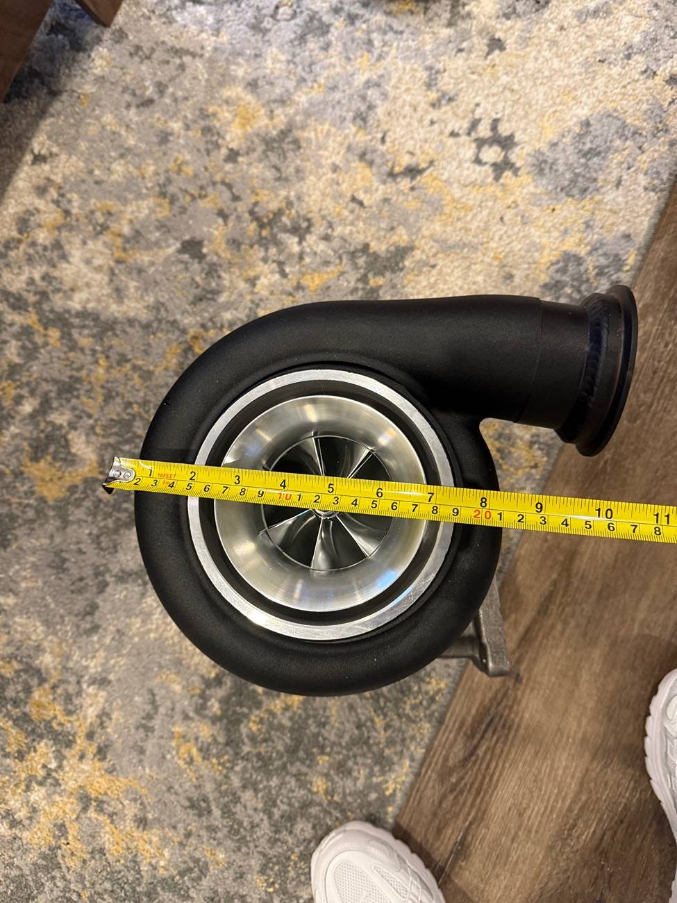

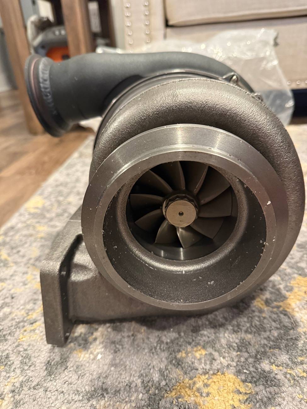

Guess what just arrived? Man is this thing not only huge, it’s heavy! I’m definitely gonna be adding somewhere in the neighborhood of 130 lbs to the front of the car.

Very nice Christmas present to your self haha. What spec did you end up going with ?

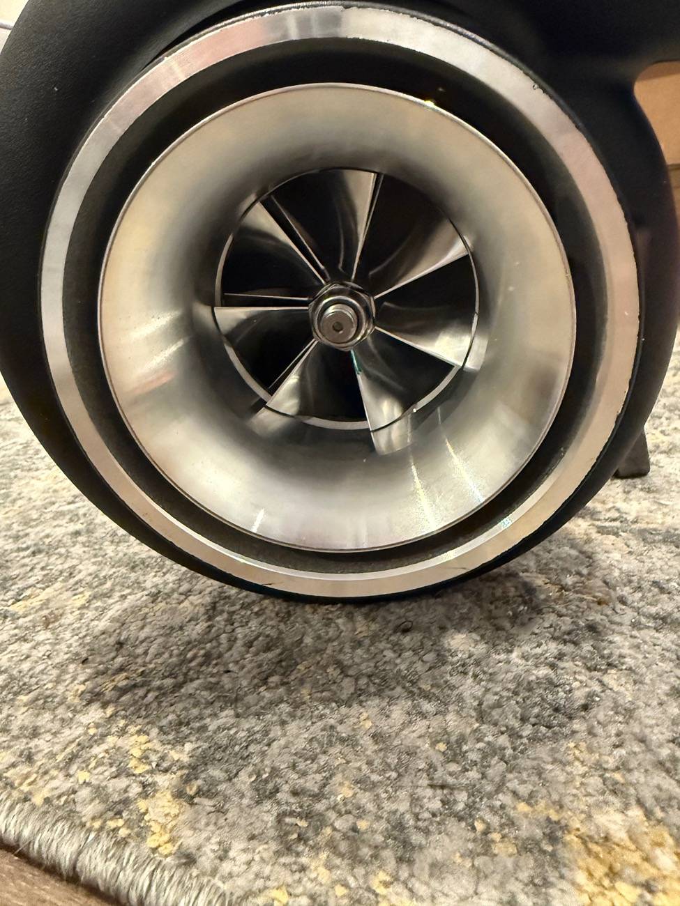

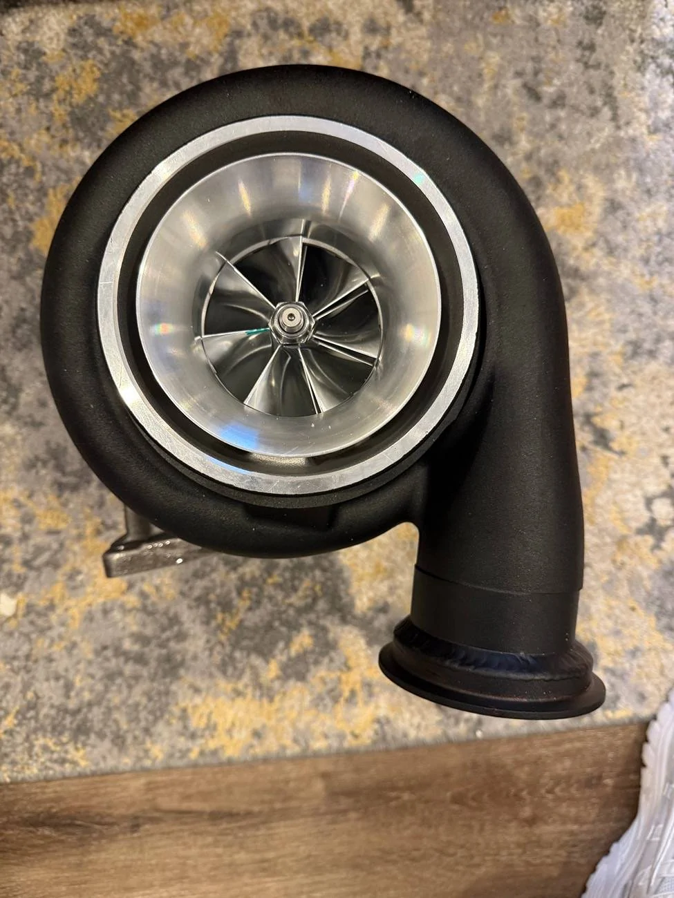

It sure is! Initially, I had ordered the 80MM, but late last week, I learned that BL Fab was having an issue getting a part to complete the build for that turbo. They offered to upgrade me to the 88MM compressor free of charge, so that’s what I did. It has all the same specs (7+7 billet compressor wheel, billet thrust plate, 96MM T6 turbine and 1.32 A/R).

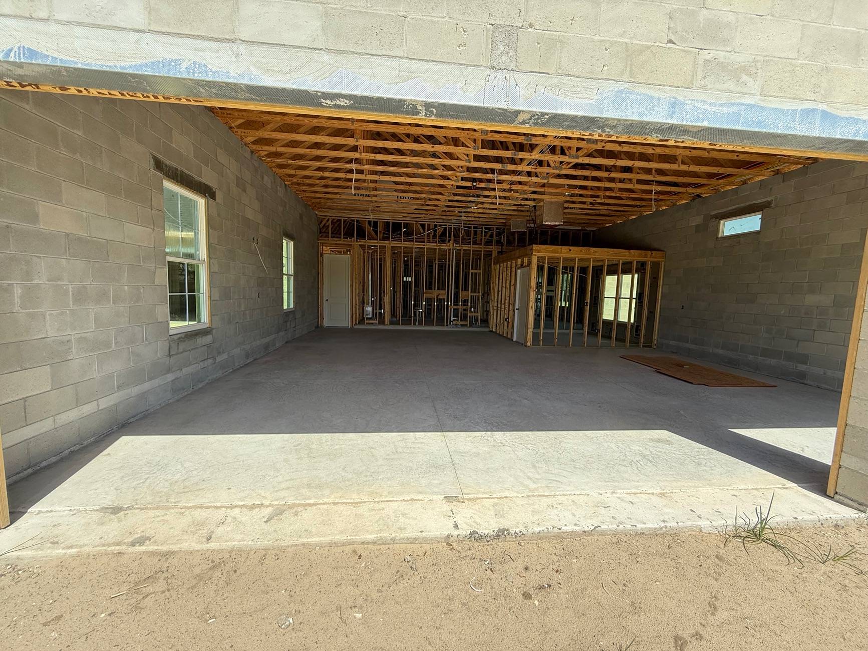

Any updates? Would like to know how this turned out

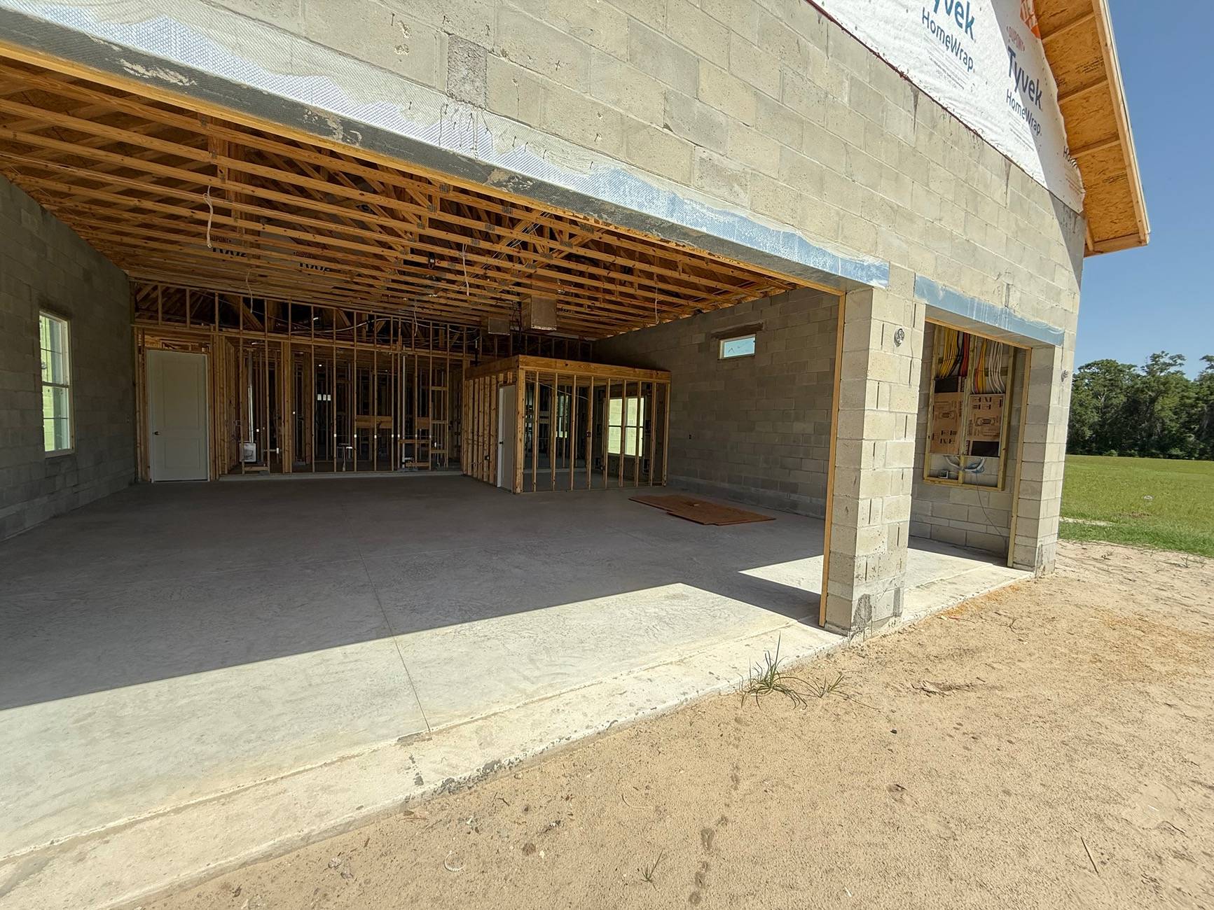

No real updates at this point, other than having purchased almost everything on my parts list needed for the install. I’m still waiting on our house to be completed. We have about 4 months left in the build process and it seems like it’s taking forever. Once we get moved in, I’ll spend a few months dialing in the house and setting up my shop area and then I’ll get to work on the install.
