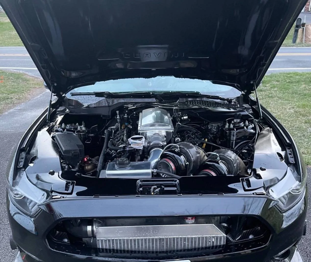

See this online, anyone know if this is a kit?
That shit there is custom. Pretty sure it's missing half a radiator.
not a fan of the dubble fender exits. but that's a good way of saying FU to downpipe routing.

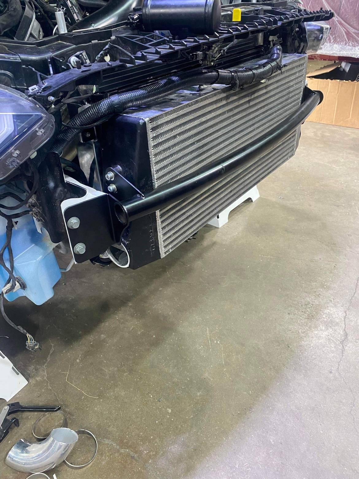

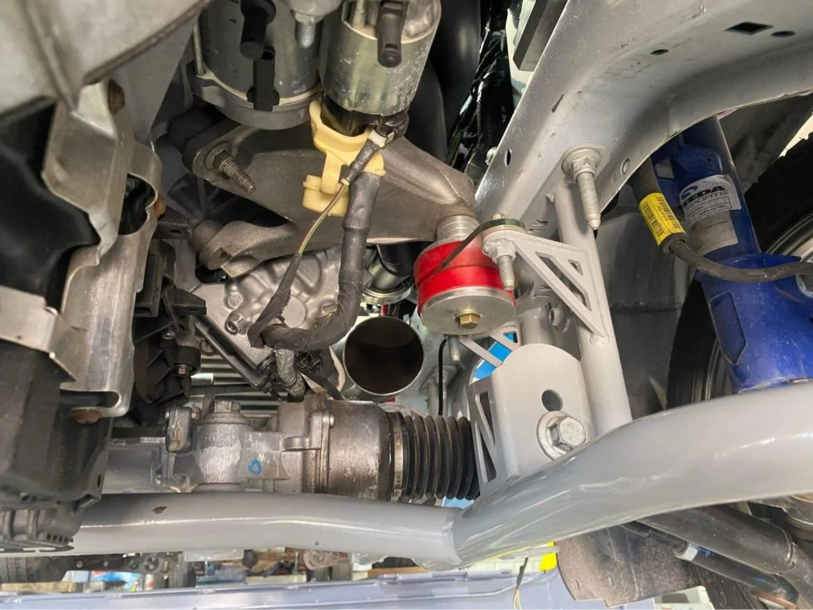

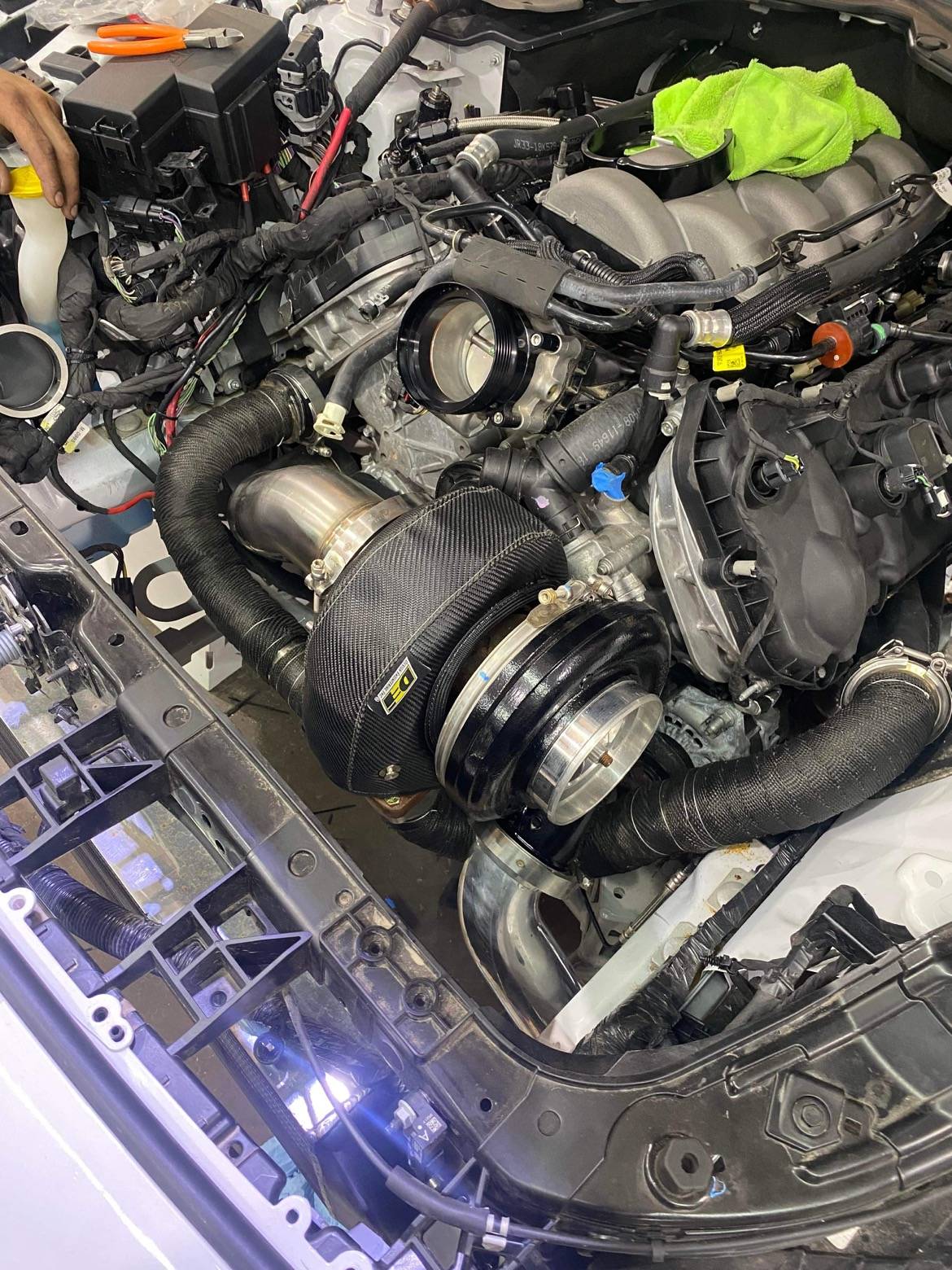

Rear exit exhaust and no tubing under the k member. Custom build from a speed shop
Are you going to have to move the ECU/power distribution stuff? Seems like the passenger side manifold is pretty close to everything.
Did you keep AC?
Did you keep AC?
looks like his fusebox and ecu is still there in the first pic.
I can only assume they went under the right side engine mount there.
it's kinda hard to tell but that's what it looks like.
Did you keep AC?
Ac is intact but due to the location of the passenger manifold the hardlines were modified. No modifications were made to the wiring or ecu location or otherwise.
Guessing no A/C?
EDIT -- I see the compressor now, but no lines lol
Also, that downpipes looks small.. like 3". Def going to need more than that on a single turbo set up.
