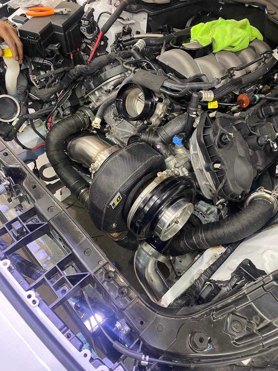

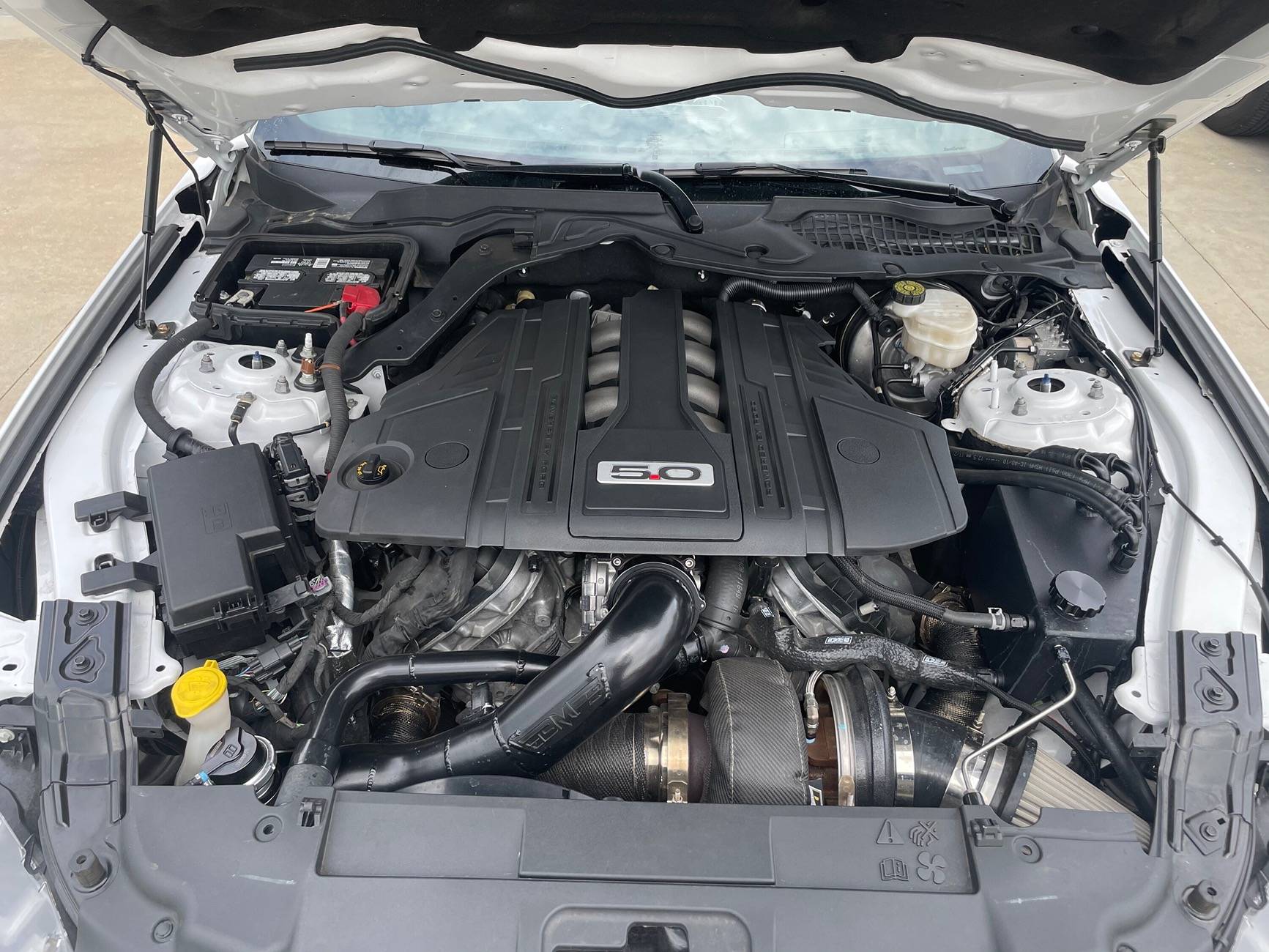

Running like a clock. No boost yet , the power will be fun After I do. I’m just enjoys having it back on the road after a time consuming engine built. Getting all the parts from the USA etc
I’ve done 6500kms on the new engine. Going to do some track day and skid pan days and have some fun.

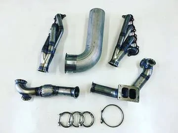

first pick CG fabrications stock kit.

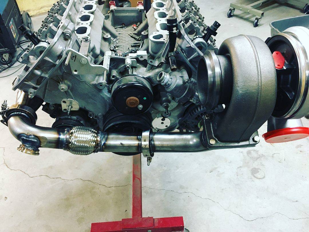

this is a build on here. He custom made the cross over pipe to fit exaust. I think is did high 9’s on 10lbs or less. Pretty efficient set up with a FI 76/87 turbo.

Any video of it running at idle and on boost?

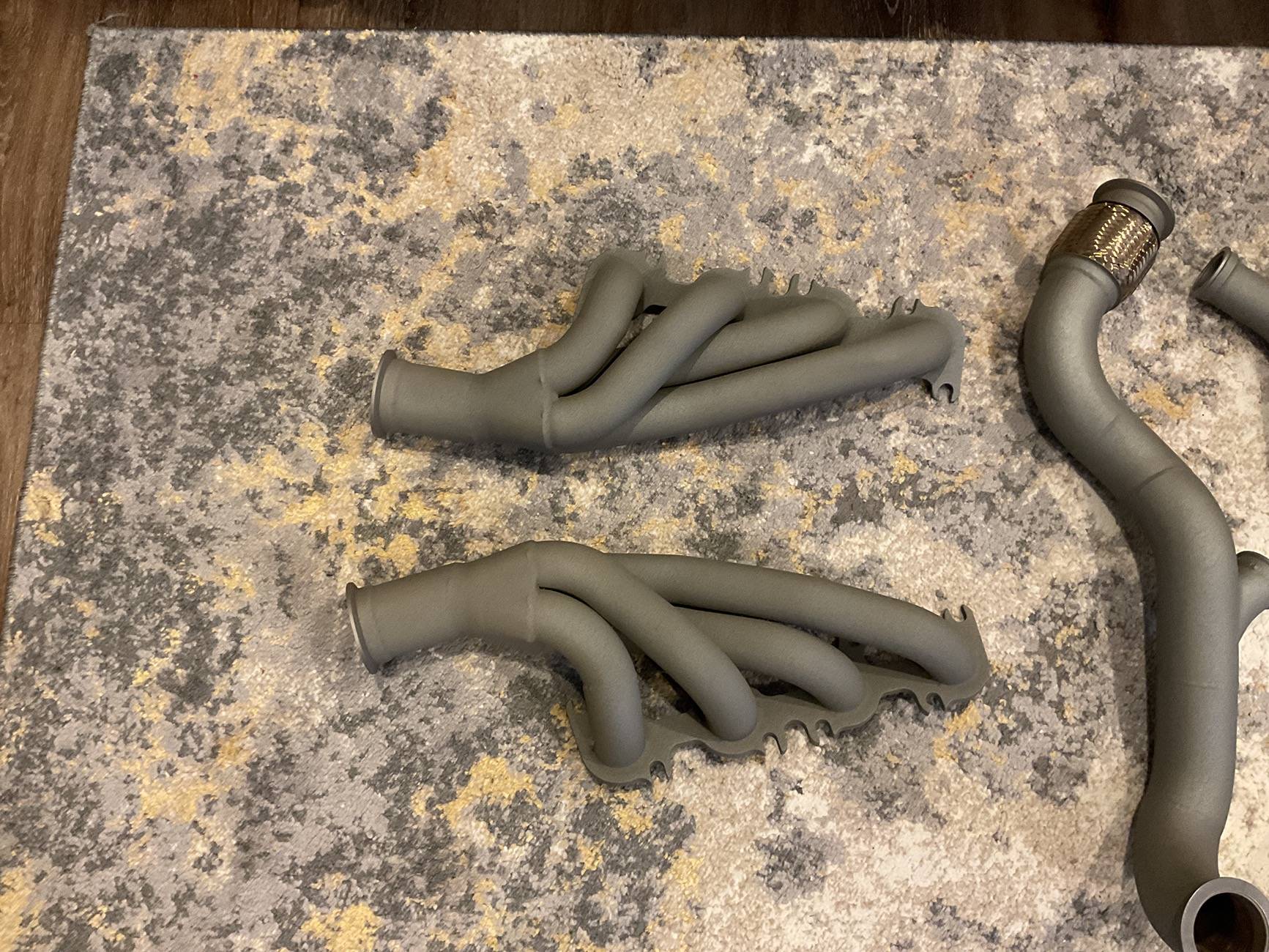

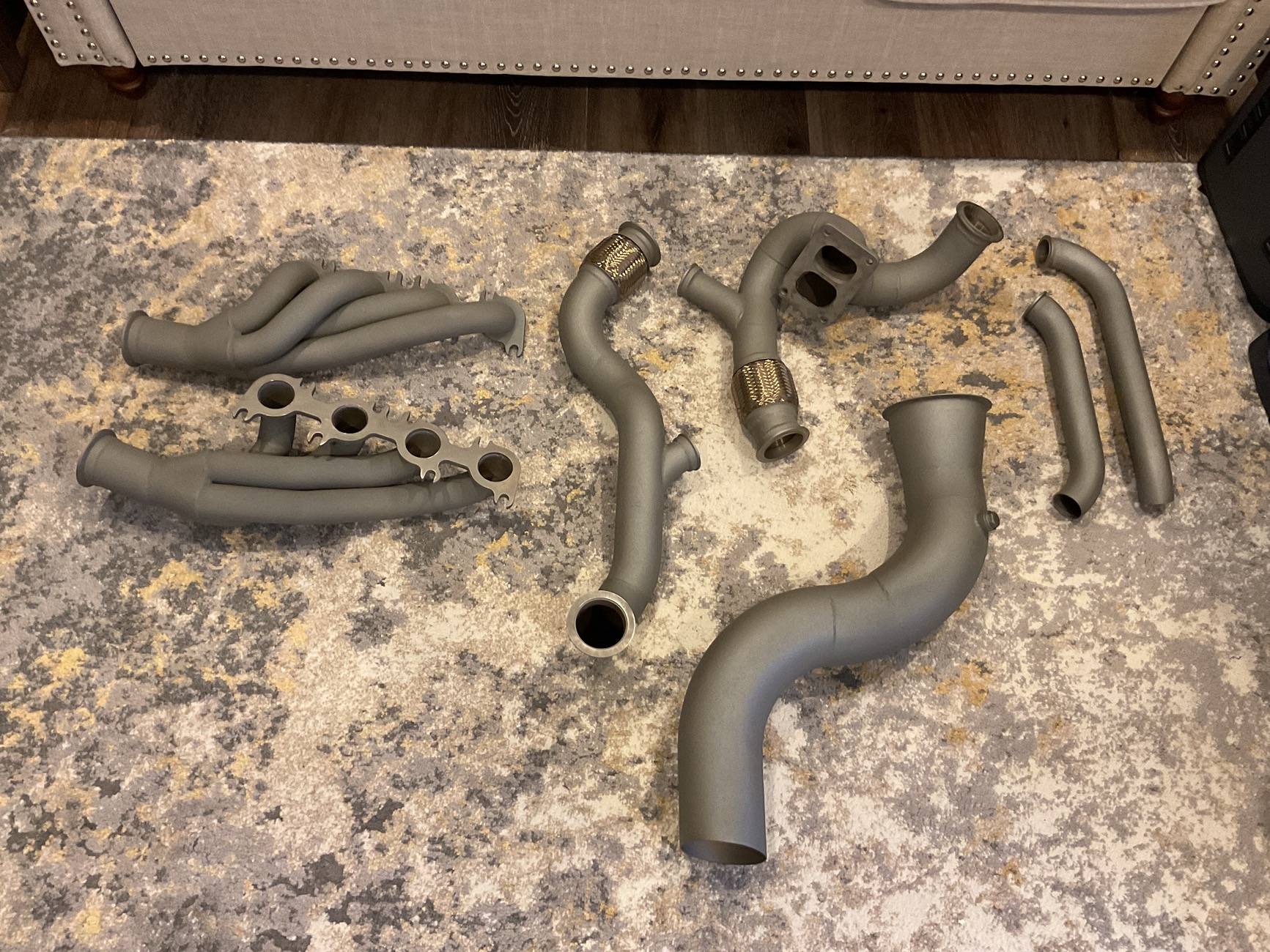

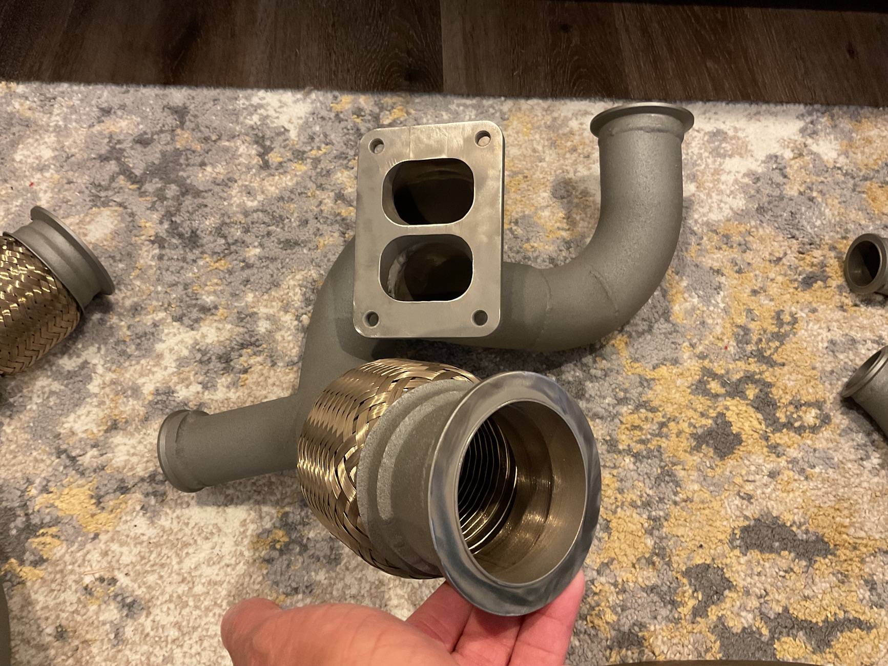

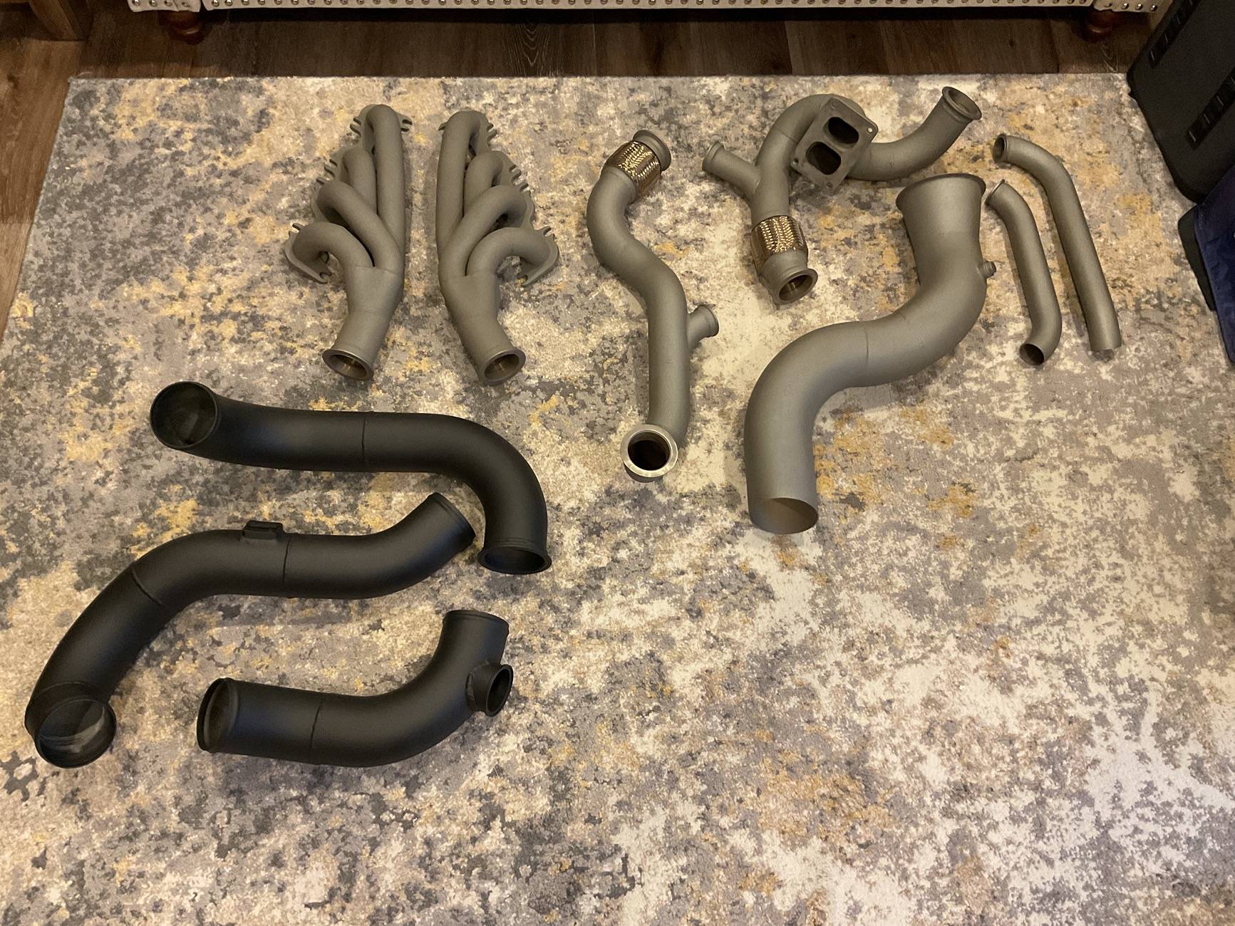

I just receive the hot side piping back from Jet-Hot Coatings today. Everything turned out great! They’re still doing business exactly as I remembered from 14 years ago. Each piece was individually bagged in clear plastic and then wrapped in foam and taped. Lots of large bubble wrap was also used to make the ride back to me very comfortable.
