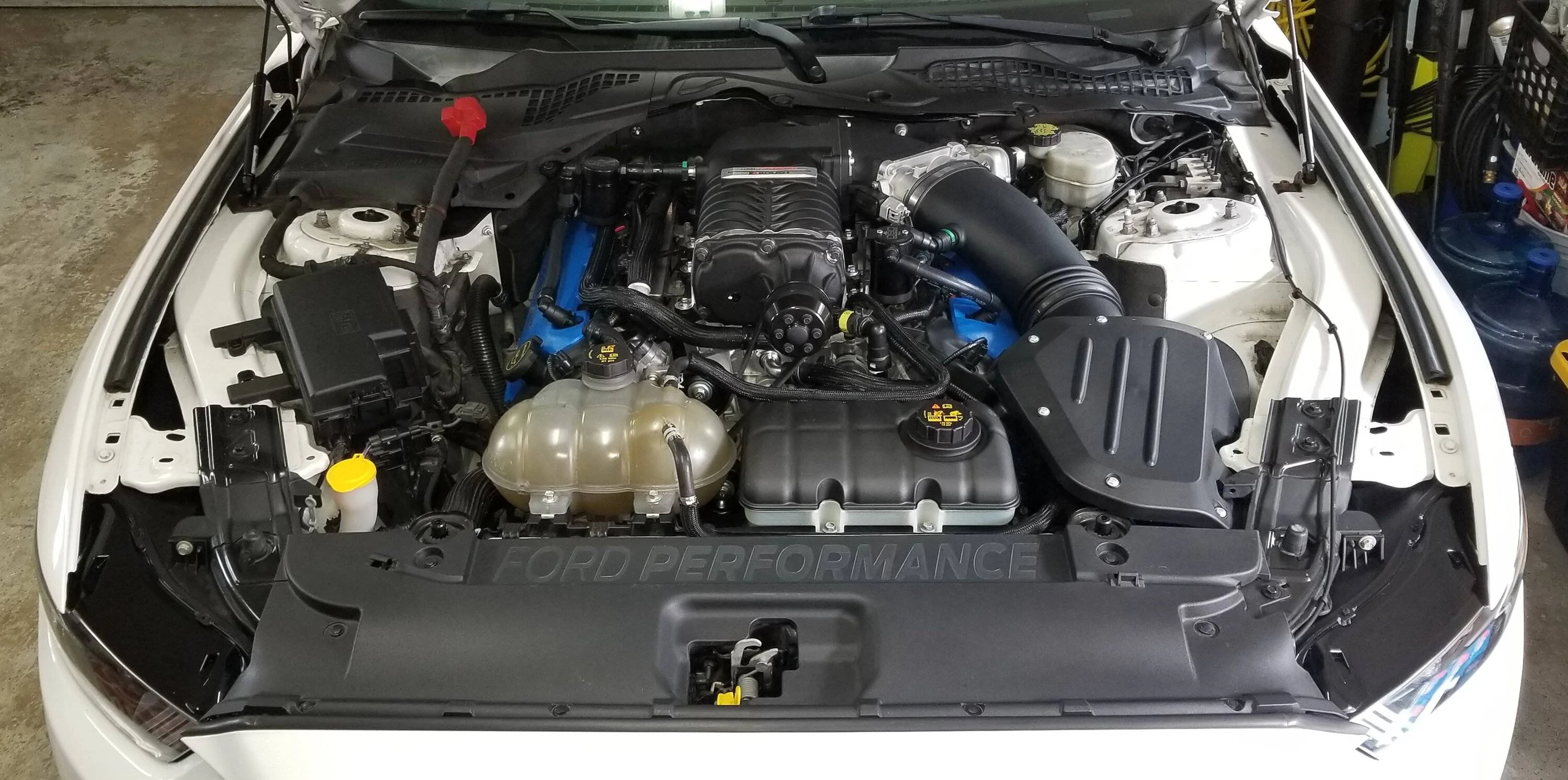

GT350 Half Shafts are relatively cheap insurance for a boosted Coyote, especially a manual transmission car. I installed mine for some peace of mind. I used some Steeda parts to stop any possible wheel hop. Did long tubes, bigger port injectors, a VMP BAP and a Steeda driveshaft safety loop. Hope this helps. Good luck...
