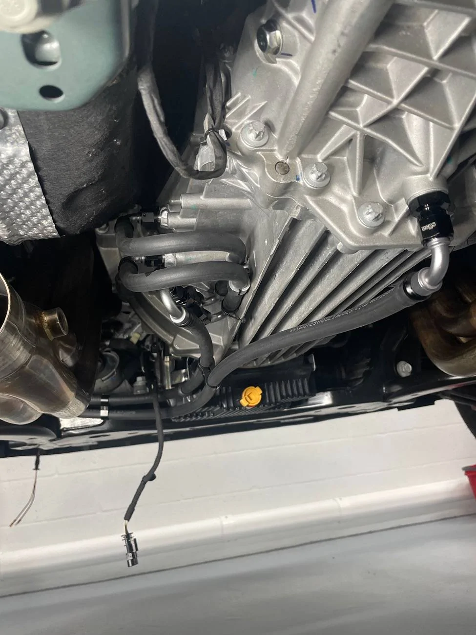

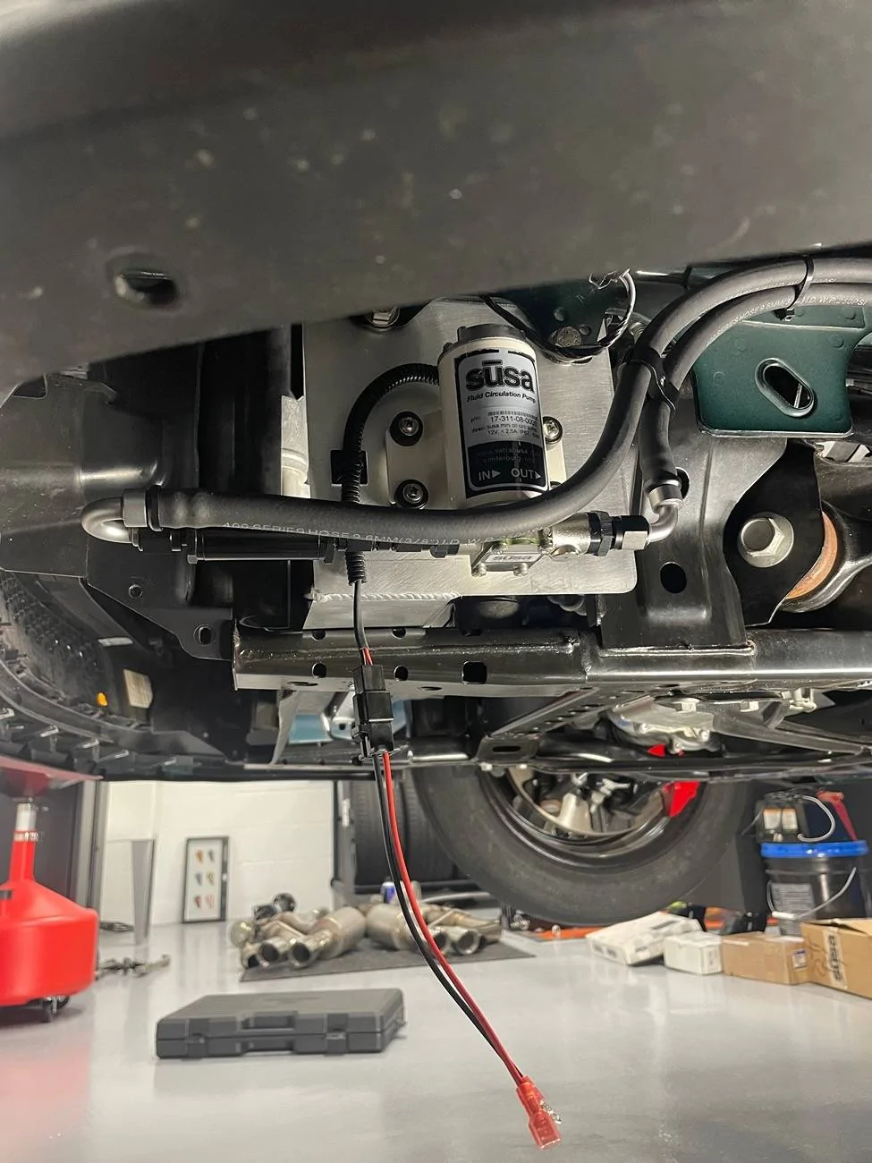

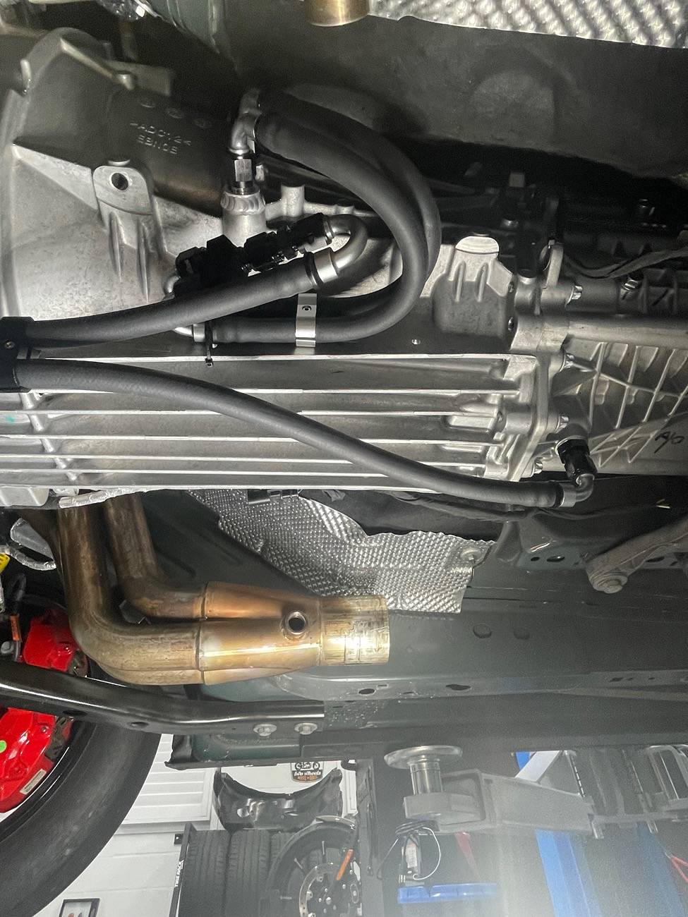

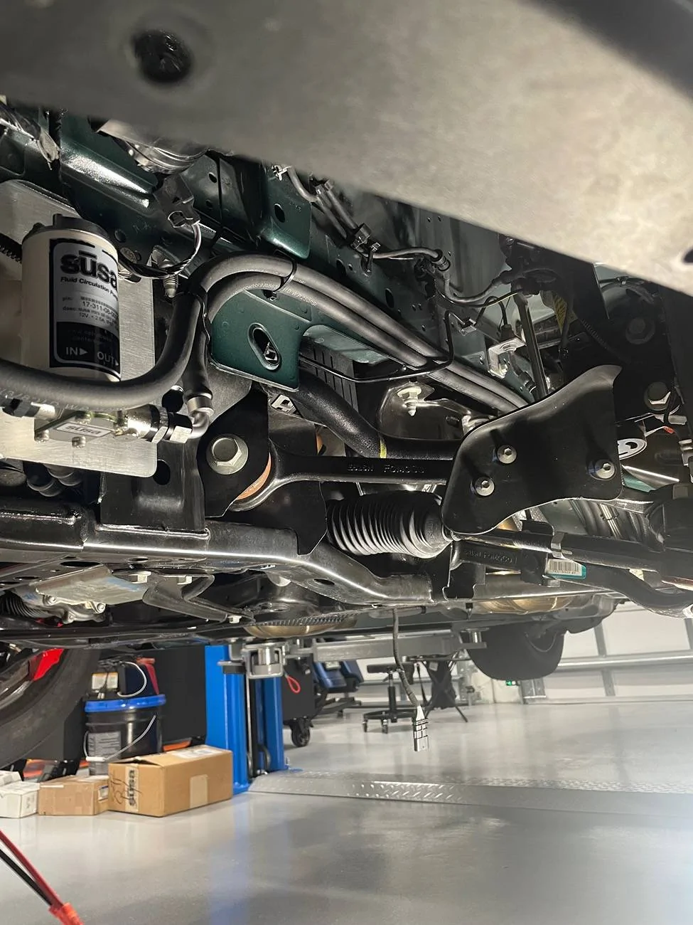

I prefer a single turbo because it has less components and will also provide more room for tweaks, if plumbing has to be altered to fit around other components installed on the car such as my external transmission fluid pump. A twin bottom mount setup would likely interfere with supply and return lines attached to the tranny.

Top mount twins would be tight. I would also have more components to service with twins. I’m already going to have to move a solenoid and clutch lines for the clutch slipper device on the driver’s side.
