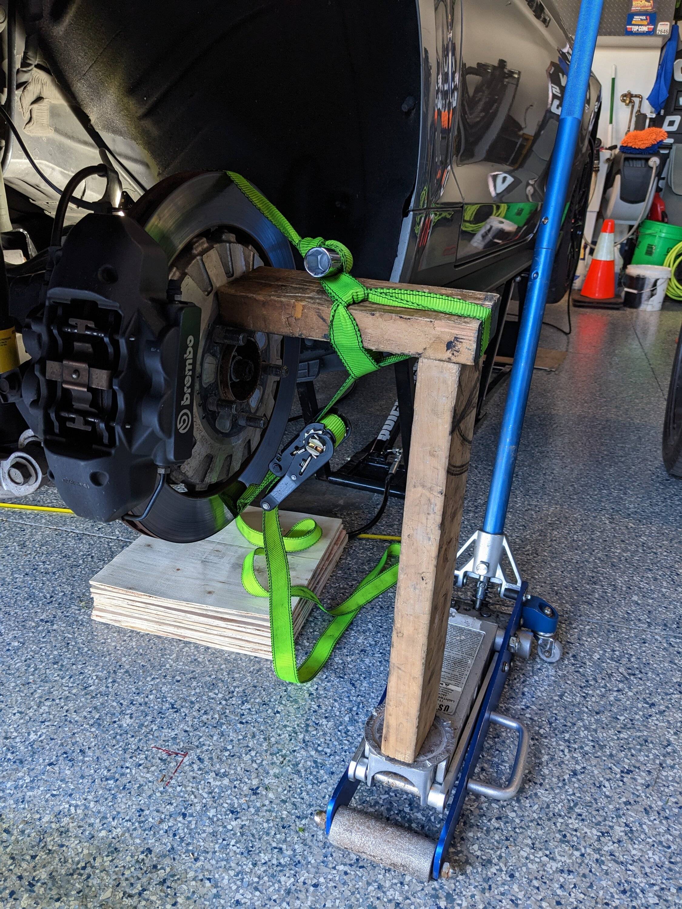

Also, the last time I fought the rear camber settings I rigged up this clap-trap just to keep it from slipping when I loosened that bolt. I used the digital inclinometer from my Longacre camber gauge to tweak the adjustment.
I was getting the clunking noise and funky rear handling just like you described, right after I had the rear alignment done by a local shop that I used before and never had any trouble with. Thankfully I bring that wrench along to events so I checked and found that bolt was snug but not tight. The above picture was taken when I decided to just do it myself instead. I only took it to that shop because that camber setting is so difficult. They got it spot on, but I should have checked all of the bolts afterward. Never again.
Now that the bolts are all tight I no longer have active camber and the car has been friggn great!
