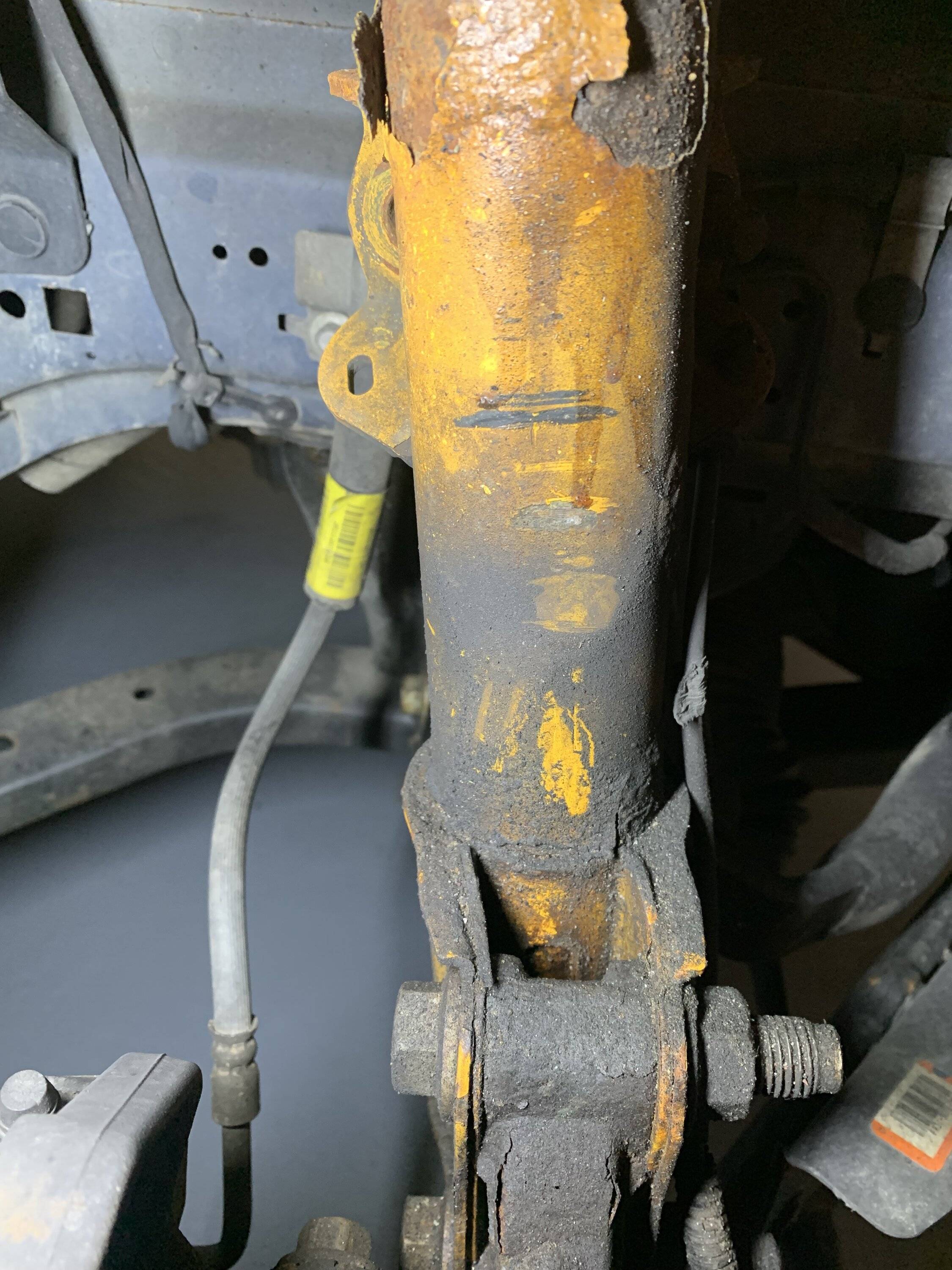

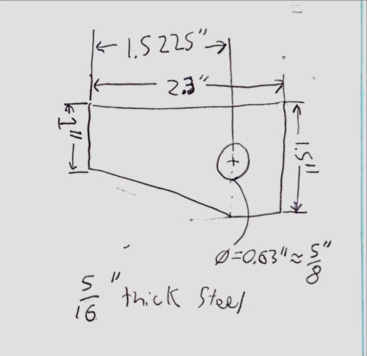

My front Koni yellows are folding due to brake torque (Both of them). I sent an email requesting warranty coverage for this and have “engineered” a piece of metal to go under the upper bolt and maybe prevent this from re-occurring.
hopefully they just cover it. Otherwise I need to make decisions on the front suspension.
What coilovers are the happy balance of cost, robustness and performance these days? I would normally go for redshift but fear they might not deliver due to financial distress.

I had a Koni bent like that, but it was when a spindle bolt came loose and it wasn't secured.
I have a ProParts Megan special, and a friend got a set too a while back. IIRC they're a good price, and a great value. You're going to have to call Jeff Wong, I don't think its on the site, and lead times might be longer than you like. He's a nice guy but not great about communication on that side of the sale.
