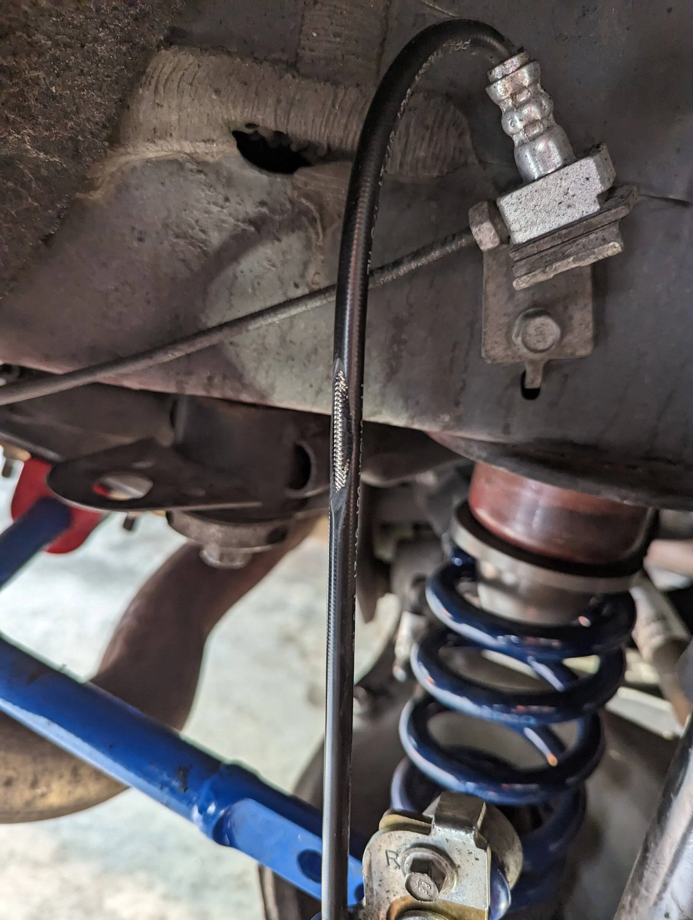

Went to look if car isn't coming apart again and found this.... Not a huge fan - feels like it is related to rear bar using relocation brackets (which otherwise are a great idea, move bar away, put links at much better angle and so on). Anyone saw this ? Solutions ? Ziptie line to the bar ?

I have that on mine. Any chance those are J&M lines? I feel like they are slightly shorter than stock lines.
I zip tied them back to the brake line frame mount in your photo. No more issues.

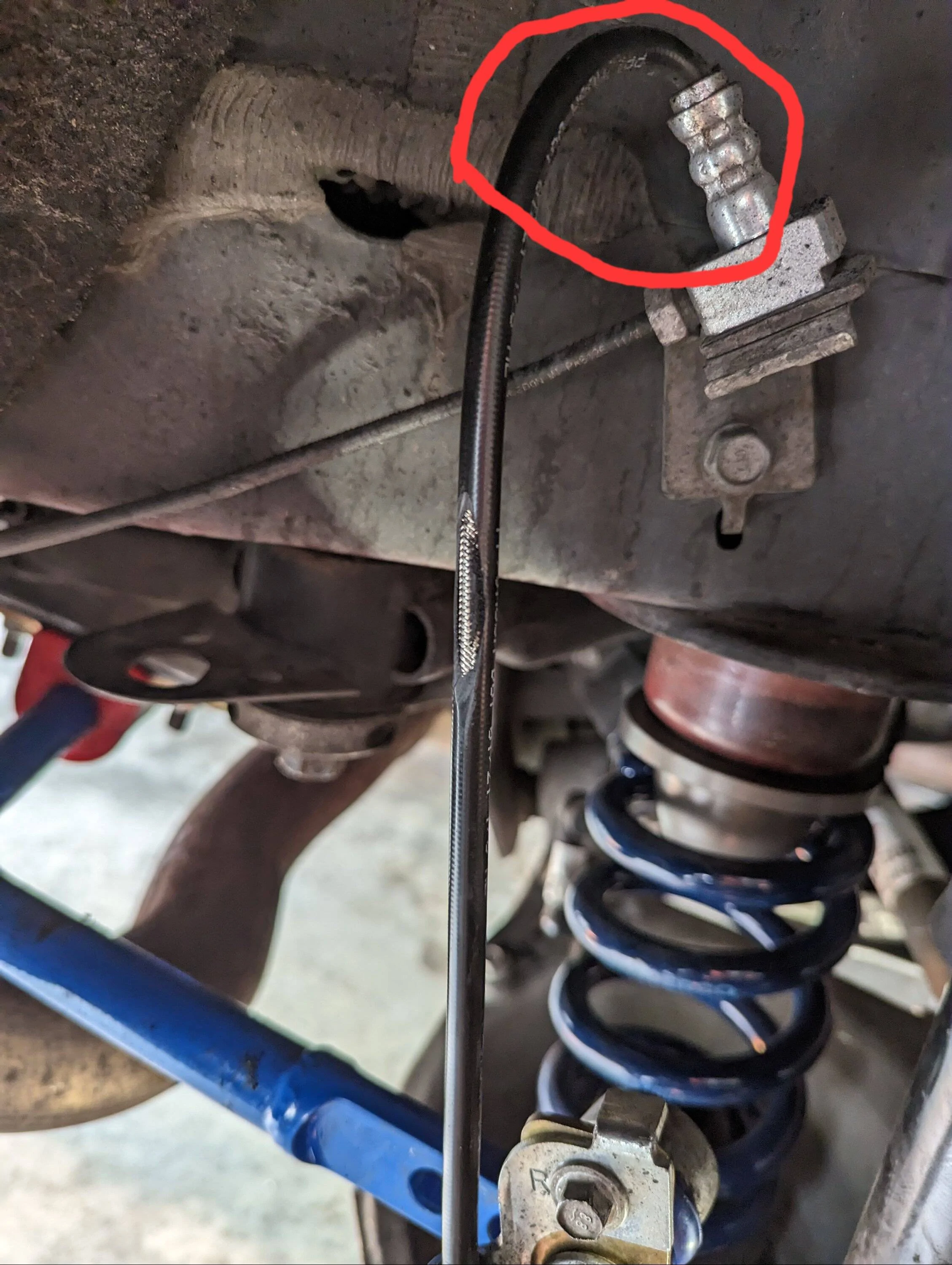

That's exactly what they are. Which frame mount ? One in the upper right corner that holds the connection between hard and flexible brake line ?

Yes on the zip tie question.
