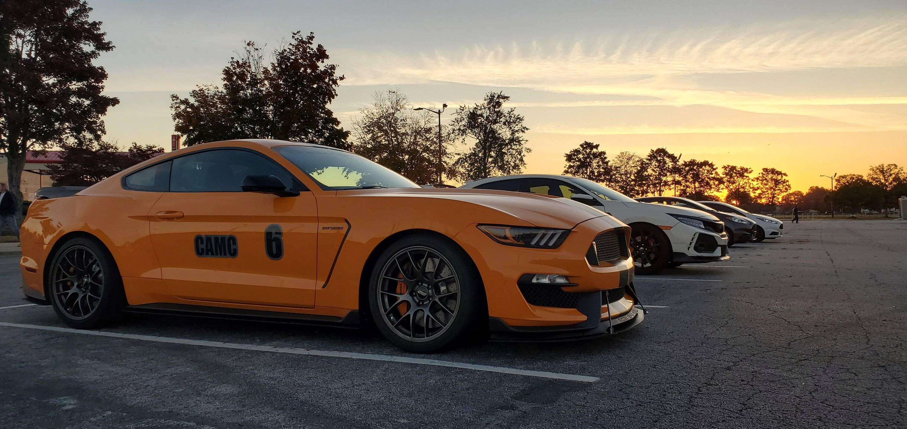

OK, I somehow completely missed this thread. Used to autocross with SCCA over a decade ago back in Indiana in various cars and classes, but just got back into it this year with the Atlanta region in my GT350. This was from my latest outing.
New tires worked as well as I thought they would.
New setup is rotatable 19x11 Apex wheels with 305/30-19 Khumo V730. I'd read some reports that these tires like crazy low hot pressures, and I can confirm that based on the 6 runs I got today and monitoring the sidewalls, this is accurate. Best times came with 30.5psi in the front and 27 psi in the rear.

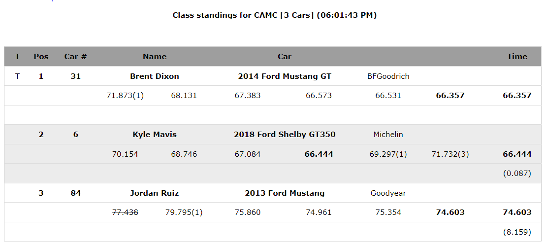

I'm lucky to have a consistently fast local driver in my class in his modified 2014 GT and with the PS4S I had run during my first few events I was typically between a second and a half to 2 seconds behind him as he's on a set of 305 Falkens. With the new setup I was actually beating him until his very last run where he edged me out by a mere 0.087 seconds. My fastest time of the day caught 3 cones (2 minor slalom cones and one that probably cost me more time than it would have saved in raw time) but I did put down a faster raw time with a 65.732. Car is still on stock camber at the front and only slightly more than stock in the rear after lowering so I know I can dial in more front grip with a set of camber plates which could solve some of the understeer I'm fighting and really boost the car ahead in the standings. Time to pull the trigger on the next set of mods. (also looks like Brent, Jordan, and I all need to update our vehicle profiles to list the correct tires, oops)
At the end of the day I was in the top 20 on PAX even though the second heat was able to pick up a couple of seconds compared to our morning times. Typically Brent and his 2014 are top 10 in PAX so the second half got a major advantage on us in today's runs as he was only 15th with a number of cars he normally beats sliding ahead due to the better surface temps and cleaner surface in the 2nd half of the day. Feeling good as this means with a little more front turn-in from a set of camber plates I should be able to fight it out for top 5-10 PAX finishes in our fairly competitive Atlanta region events.

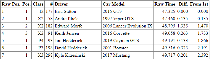

Sort of related, I took 1st at the PCA/BMW Autox two weekends ago, on a gocart track. I had really struggled to put the power down out of corners in prior events, and tried a wildly different tire pressure (RT 660's), from 28-26, to 34-32, and it made a massive difference, putting me in 7th overall. The EVO is north of 500 HP, and every car ahead of me is an autox veteran. I'll take it.
There is more time I left on the track. But I will take it. Also have a list of tweaking to do this next year.
