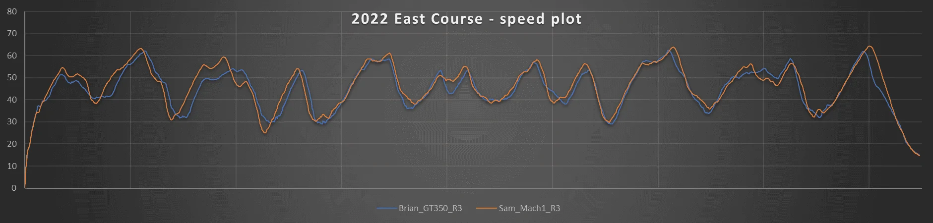

Regarding speeds for the courses, I think the courses this year were just a little slower than the last couple of years. Here's a speed plot from the East course with my fastest run (had me in 3rd place) on Tuesday and Strano's 3rd run. I really botched the turn after the first slalom and you can really see how it killed my time compared with his. Average speed was around 44 mph but you can see there were a lot of digs from 30 to 50mph.

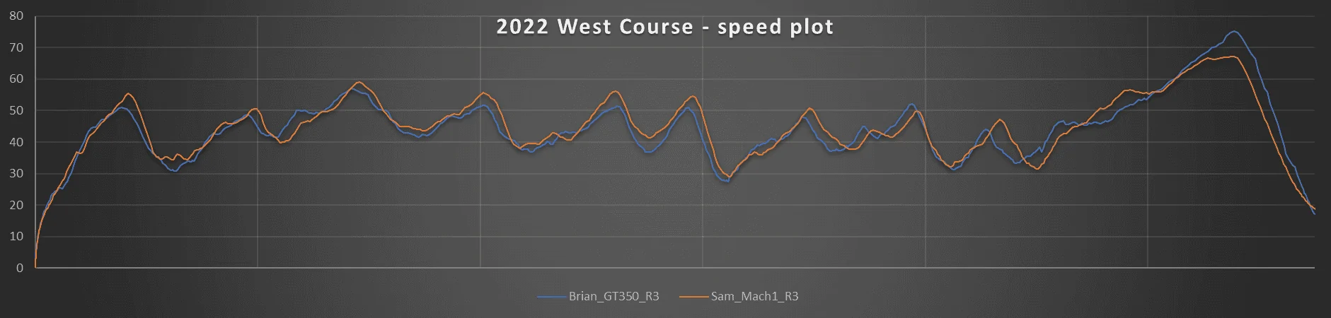

For the west course, there are far fewer hard accelerations and average speed is lower (around 42mph) even with the fast run through the finish. You can see Sam's car hitting the rev limiter right at the lights where mine continues (all hail the +8K rpm redline).
These are FS cars so I'm sure Jacobs speed plot would be higher overall with more power, grip and less weight.

I can see from the these plots where I got ahead of Sam and yourself on the east course. (not that far ahead, Sam put down a great time and beat my first two attempts, and you landed a solid trophy position). My peak speed (gearing and tires) was only 63mph, but I got y'all in a couple of the high speed transitions late on the course. I carried more speed down to the first pinched tight right-hander, and after the 90 degree left at the far corner of the course I didn't slow down as much through that next offset. Finally I executed in Corner 5's transition before the turnaround with less speed lost.
That's all probably mainly helped by the aero and stiffer springs supporting confidence in those sections more so than power or weight advantages). Thats when the CAM build really turned on for me was when I sorted out some aero.
My car is only ~420 at the rear wheels and weighs ~3650+-. CAMC allows a 3300lb car, but I'm not sure any of us S550 drivers know how to do that without some pretty drastic measures. Fletcher is at 3550lbs with lexan rear window and a lot of interior removed (headliner, center console, glove box)
