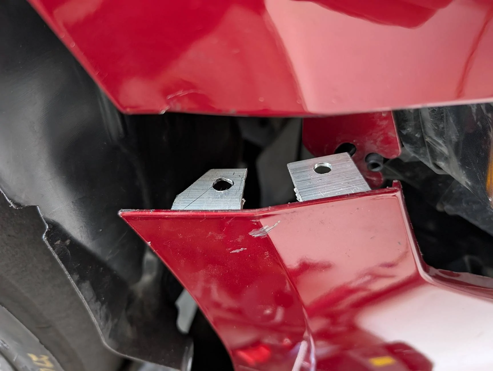

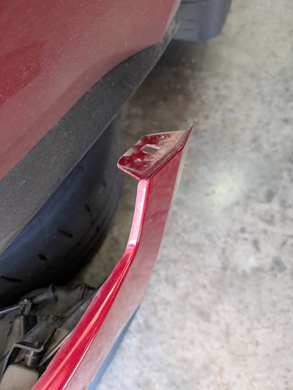

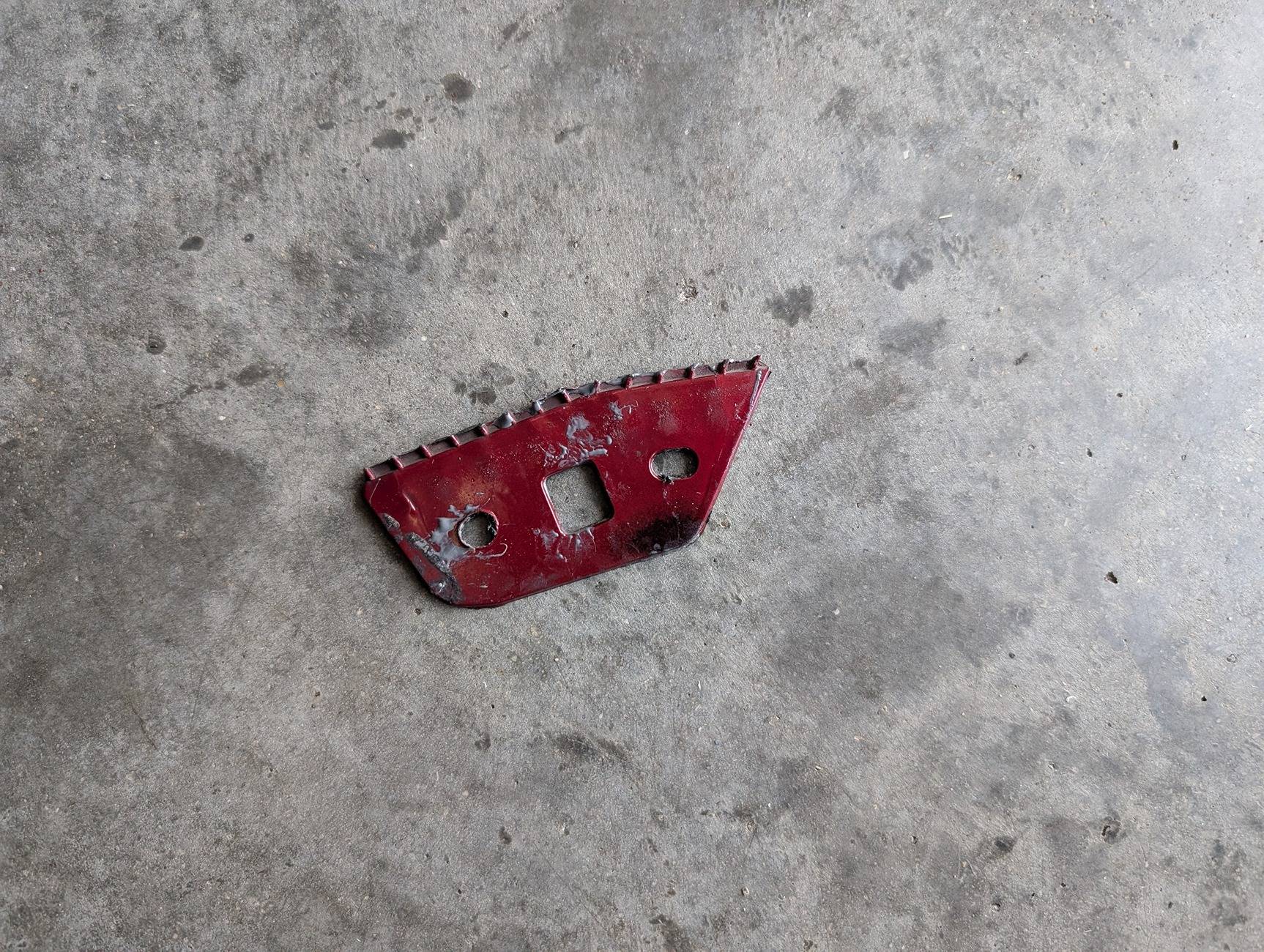

Turns out you can break the bumper cover in 2018+ if you hit cones hard enough....
Replaced the broken off piece with two brackets cut out of the aluminum and attached using epoxy adhesive. Will see how that holds up. (picture #3 shows intact side)

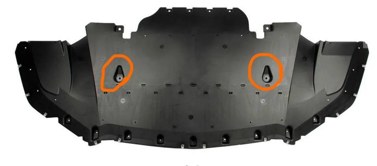

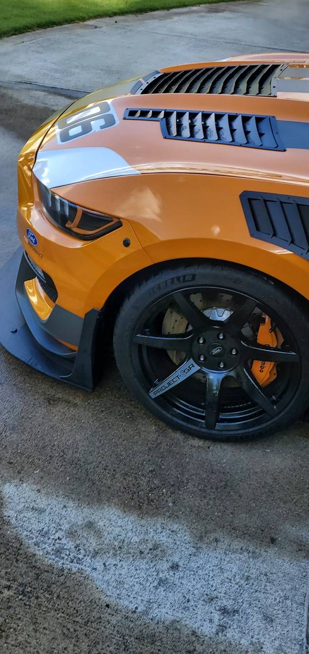

I would think a splitter that big a cone would have a tough time getting a direct impact on the bumper enough to break it.
As Dana says it depends how his splitter is attached.
I have those quicklatch pushbuttons on each side, but my car is black so they blend in.
For the record, the brand name quick latches are better built and last longer than the cheaper knockoffs. Pay the extra money. The cheap ones dont seem to last 6mo.
