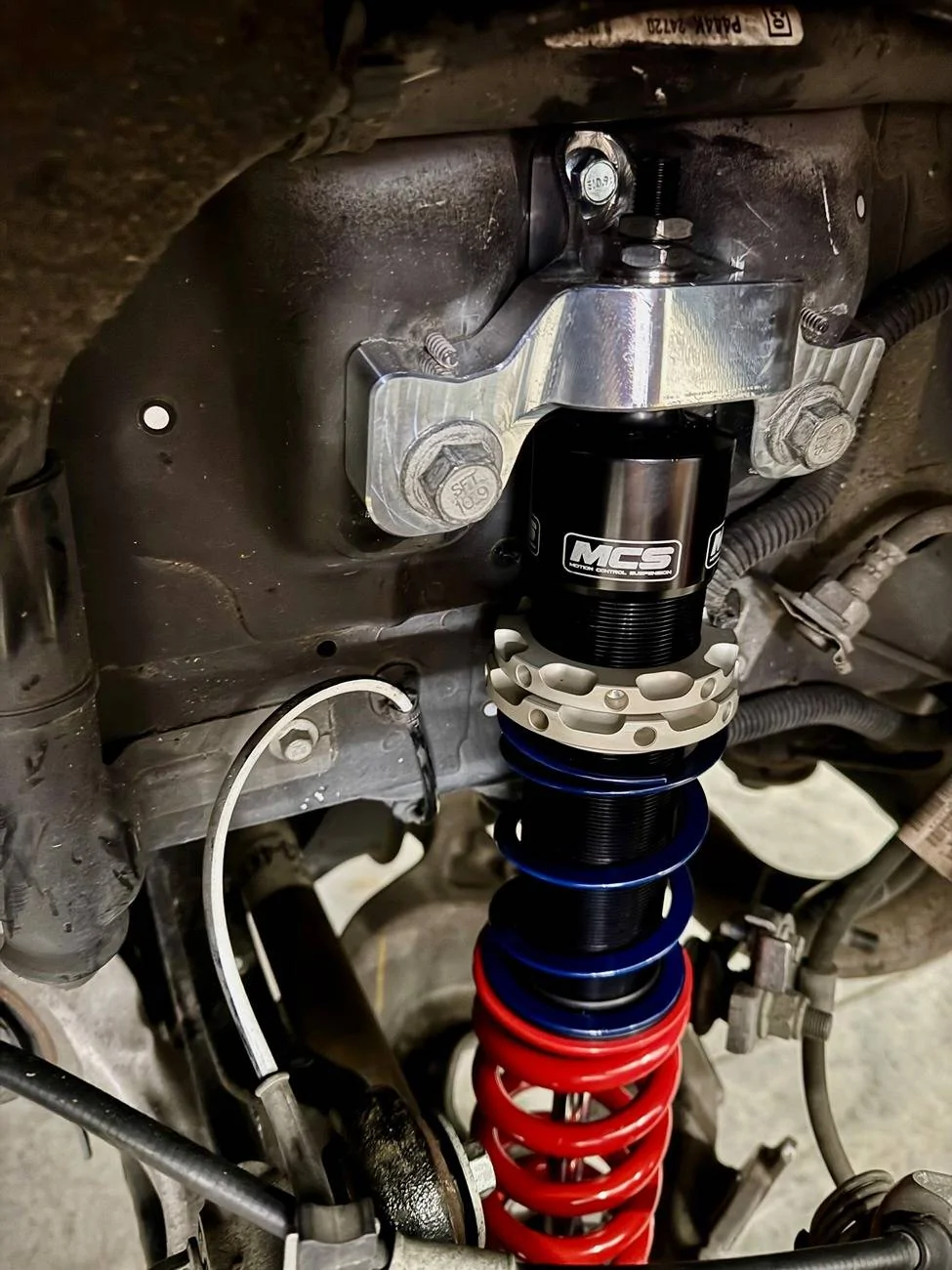

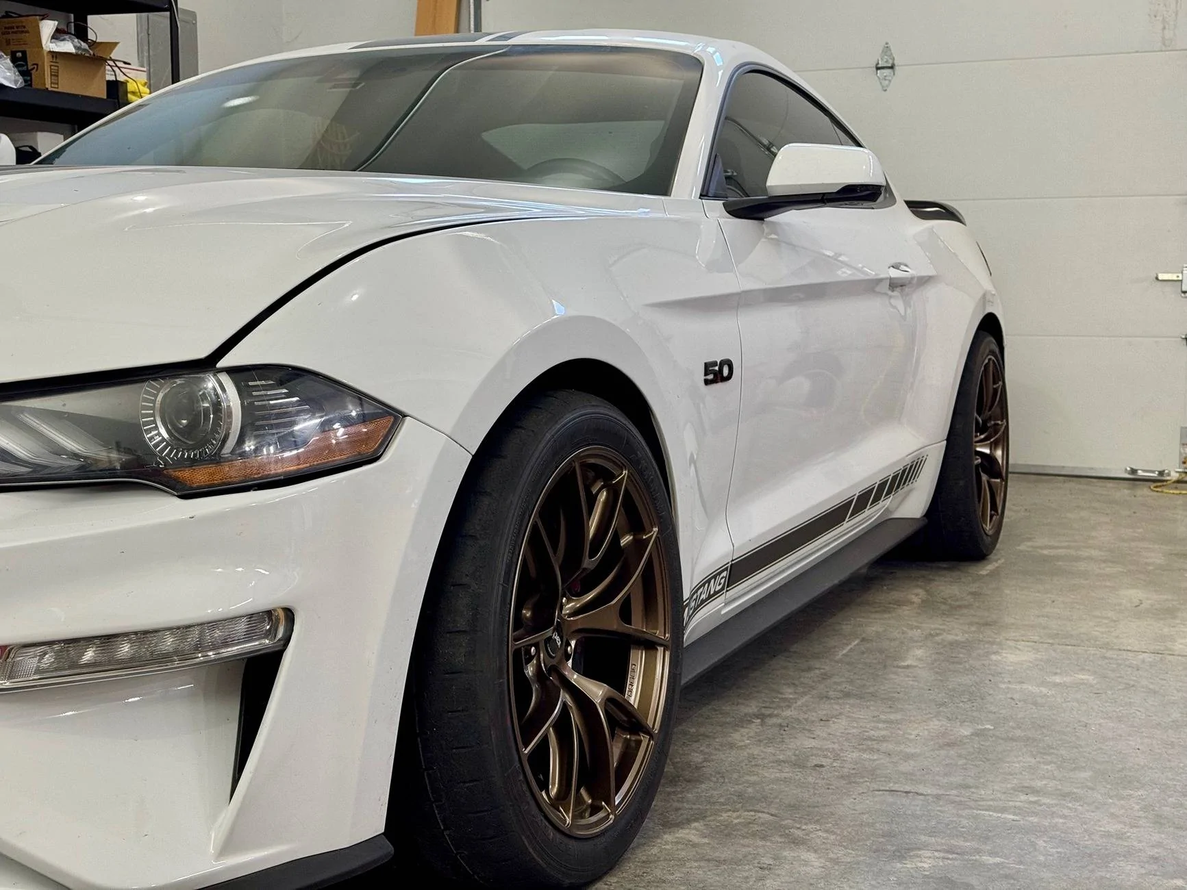

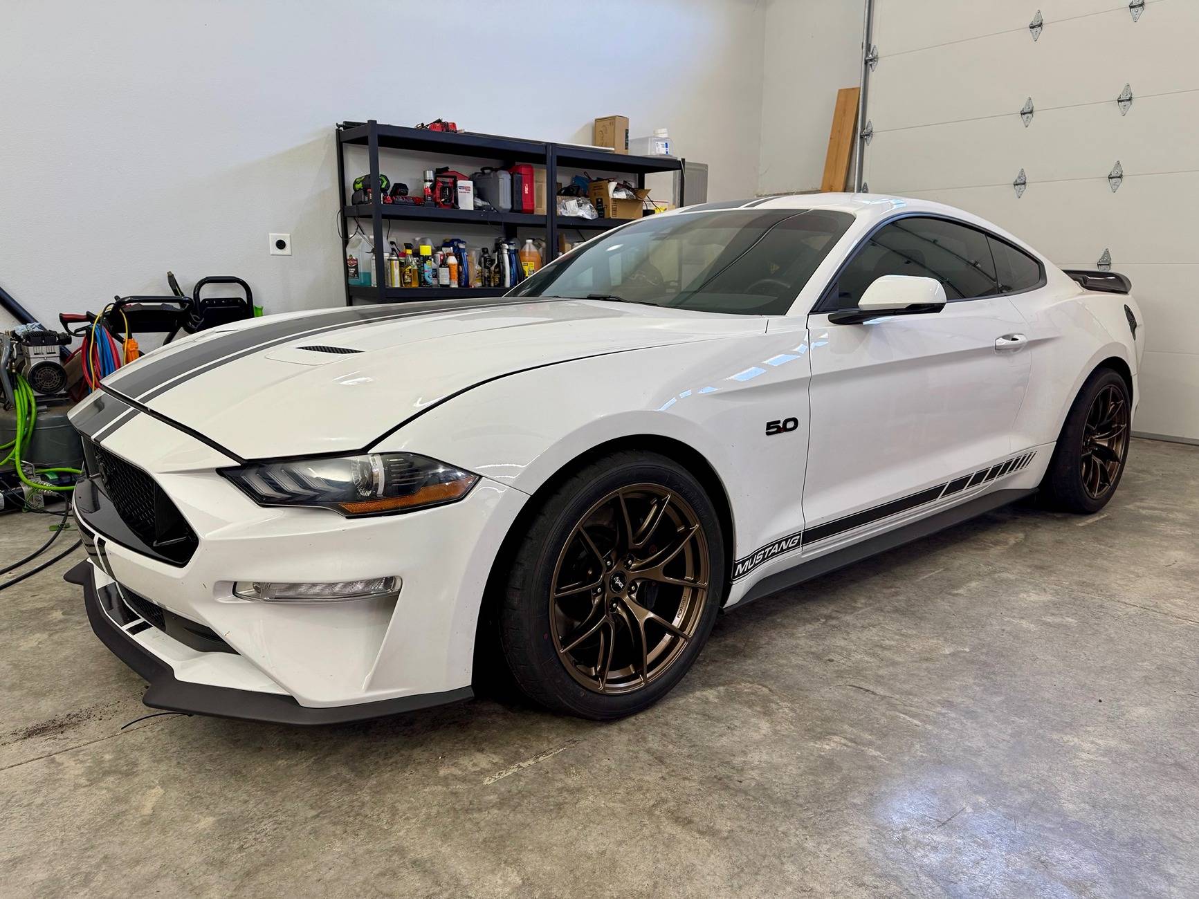

A little break in the Solo Nats reg, which I wont make this year, got my start in the CAM build.
Settled on 14" wheel center to fender all around. Which is lowered 1.25f/1.5r in suspension and with the diameter from stock to 315s, -1.75f/-2.25 from stock.
Spring rates are 450/550 with natural frequency at 2.2f/2.0r.
With the MCS coilover ditching the divorced spring, I made an upper mount with a 3rd point that prevents the rocking back/forth. I think its the fatigue from bending back and forth causing stock sheet metal failure so this should both support more load and help prevent the tear-out. Of course bottoming out is going to always cause issue but thatll be important to make sure is not a common event.

looks good, shocks good, wheels and tires good. Hope it runs good.
i’d go a little stiffer but I know the 450 front springs will feel good.
needs aero though :)

Love that upper mount design. Great job! I'm an aerospace engineer and I appreciate a good load path.
