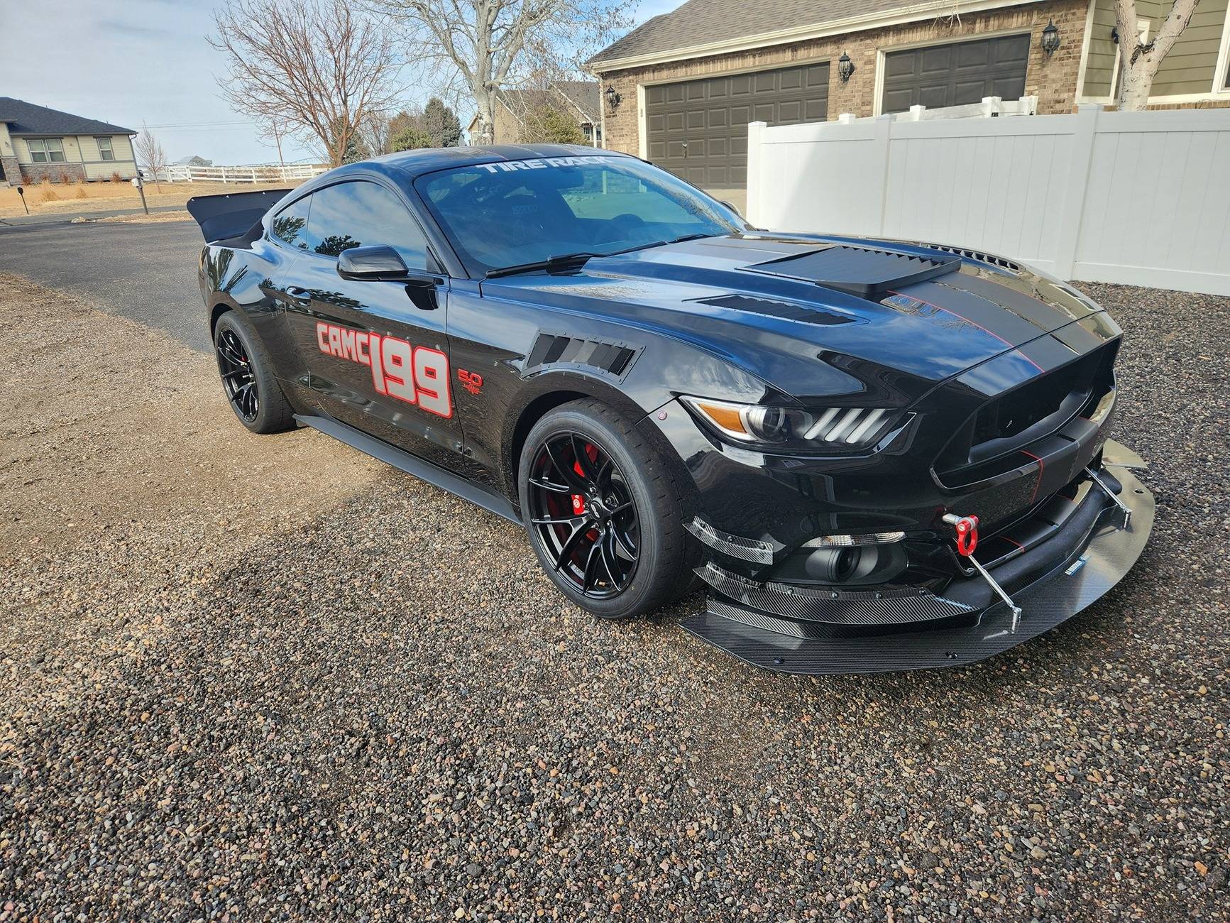

I run 18" x 12" Apex rims and run 315 Yokes with no fender mods. 35mm spacers + super long GT4 wheel studs from OPMustang. I run Ohlins coilovers and there is maybe 1/4" clearance from the tire to the strut body with -4 degrees camber.

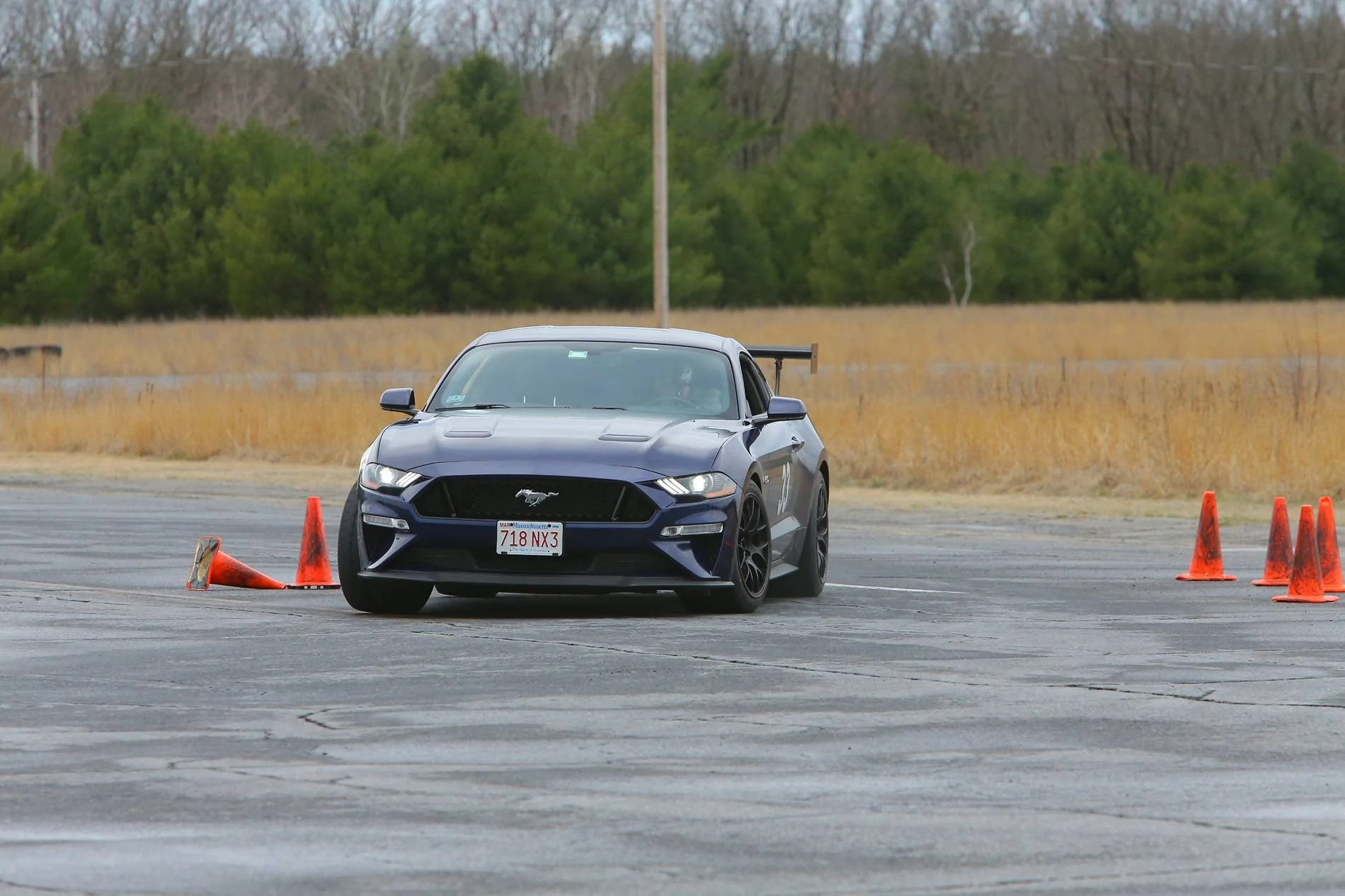

Another year goes by where sticker yokos remain the ultimate cold/wet tire. With a little help from Mother Nature I got top pax at the first bmwcca AX event of the season. Anyone on 71rs or Vitours or ECS or anything else were in the dark ages.

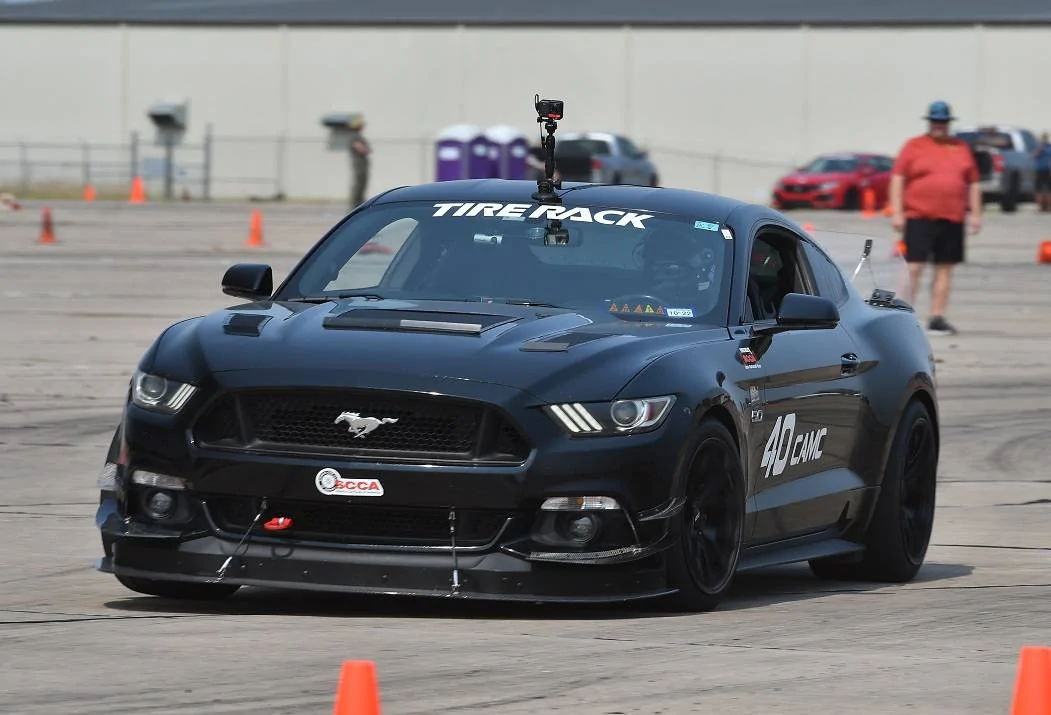

We're back baby! Got one good event under my belt after 3 false starts this year (one transmission leak, one fuel starving at high RPM and another with more fuel starving).
This one was a local event and autocross school with 168 people entered at the Beeville TX concrete site. Engine ran well with the new KPM1000 fuel system and a couple revs with the tuner to correct the voltage driving the pumps and to dial in the fuel trims for the new higher PSI.
155 miles down the highway to the site, A couple of days with no leaks, misfires, and no fuel starving, and 155 miles home with no mechanical issues and no strange noises.
Peak speed/RPM was around 69mph at ~7800 rpm (so still 2nd gear for the Voodoo and Tremec even on the short Yokes)
I'm not sure how many runs I have on these Yokohamas (lost my tracking spreadsheet over the winter), but after sitting outside most of last year, they're pretty hard. They still held on pretty well and good enough for a respectable 11th place finish. The R-class guys cleaned up on the dry concrete, but I was 4th fastest on street tires and undoubtably on the oldest tires. 2nd places was a CAMS car on square 345 Vitours. I have as set in 305 waiting in plastic wrap, but I really want another lightweight set of 18" Yokes for these forged Apex wheels.
I'll work on fixing the wind noise in the audio next time
