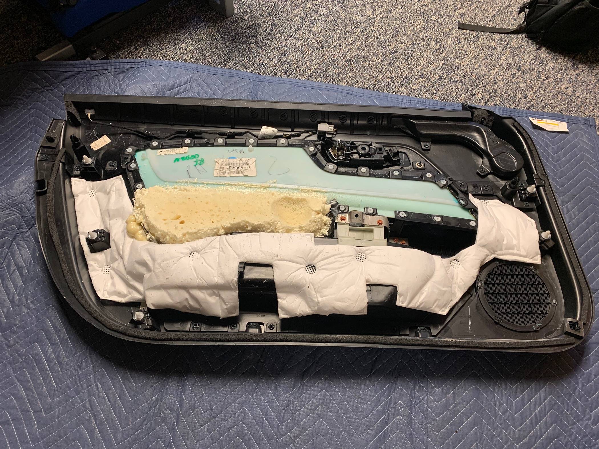

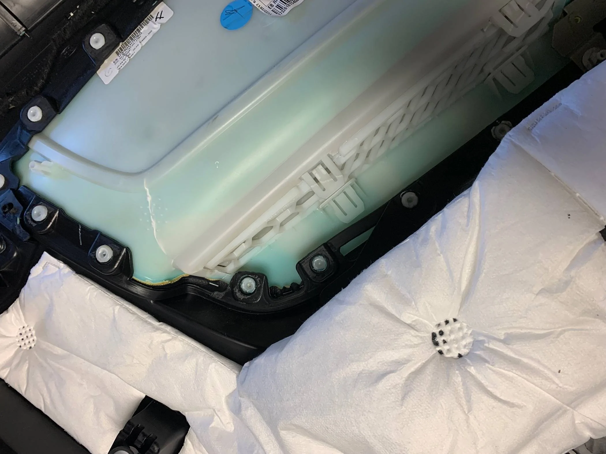

The stupid passenger armrest broke last event from having bodies thrown into it repeatedly for so many years. I filled the eBay junkyard replacement with foam hoping to avoid a repeat failure…

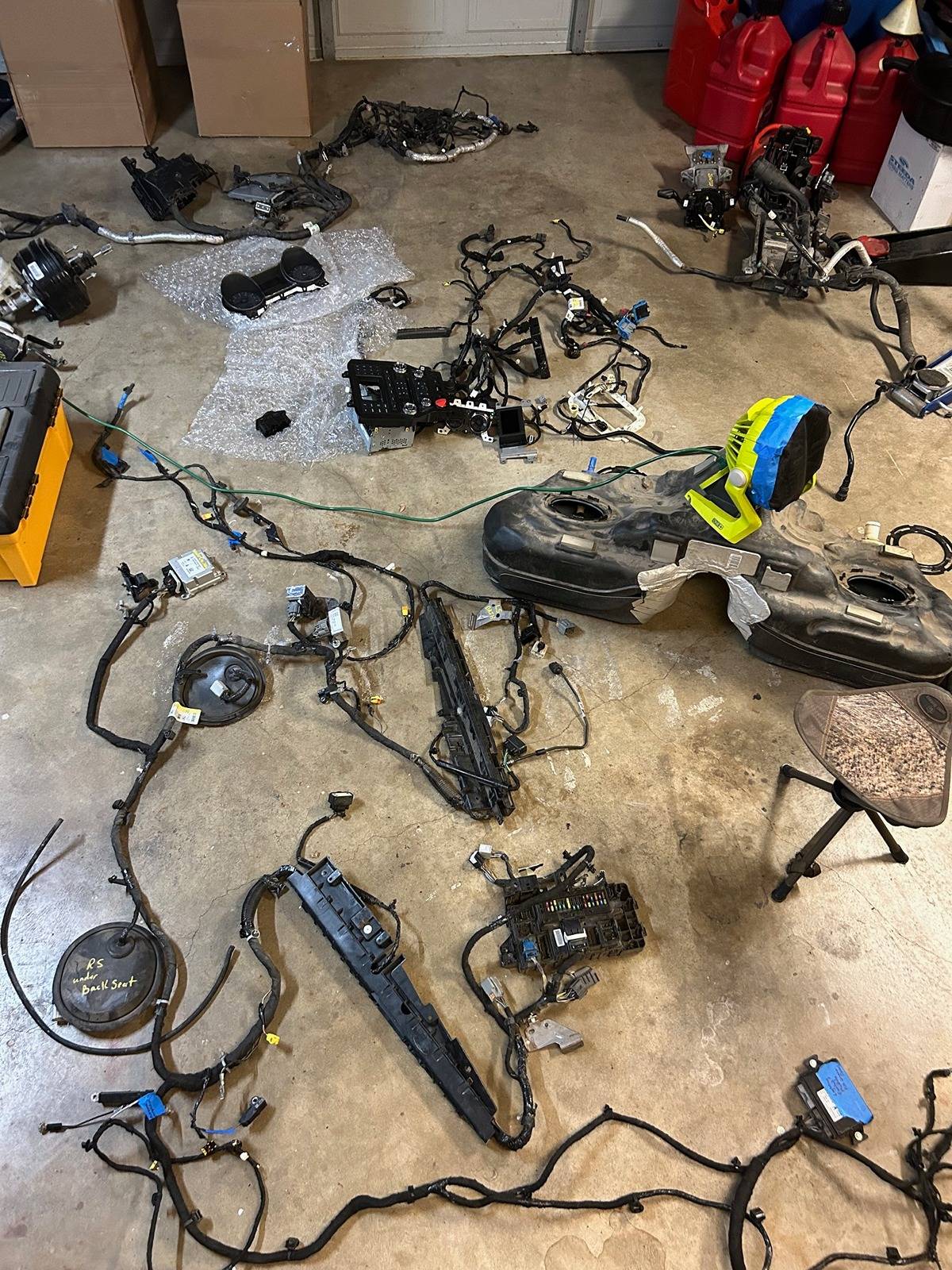

A little update on my (re)build.
I'm learning more than I cared to learn about Mustang wiring harnesses.
There's a big floor harness which runs down both sides of the car and includes the interior fuse box. This harness runs some of the airbags and also the fuel pumps. (bottom of pic)
The dash harnesses are different. My PP1 was a Premium and this 350 was a base. The 350 gauges are a little different. oil pressure and temp instead of the PP1 oil pressure and vacuum. The tach goes to 8250. The GT doesn't quite have the hardware to just snap in that Heads-up LED panel, the front part of the dash is slightly custom to the GT350 (doh!).
I'm waiting on some miscellaneous Ford, Ford Performance parts to arrive before we begin the real work. Boundary oil pump gears are here. MGW shifter is here. GT350R cam phasers, motor mounts, fresh radiator, and the driveshaft have not shipped yet.
I also need to sort out how I'm going to do an oil cooler.. Probably will do a Setrab in front of the radiator since my GT wasn't really built for a GT350 stock oil cooler. The bracket might mount up but the GT facial and fender liners were not intended to have airflow through there. I need to investigate the oil pressure and oil temp senders more closely. I only glanced at that part of the block.
I wonder how the GT350 stock headers, aftermarket X pipe (no resonators) will sound when paired with a Corsa Touring mufflers. probably pretty good, but I don't really know what to expect as far as volume goes. It should be louder than my GT (stock midpipe and same Corsa mufflers), hopefully it won't be too loud. I'm expecting GT350R with active exhaust on quiet.

My two cents on the exhaust, the stock GT350 exhaust is the best sounding exhaust you can ask for on that motor. Everything else I've ever heard, including the setup you are considering, is obnoxious to the point it hurts ears. And I've not sound metered one, but I suspect you are going to be blowing sound with that set up.
The fender liners, I think you could cut out a square in the fender liner, then place a mesh that would protect the intercooler and allow airflow. That is my plan for the fender vents I've yet to install. Then your only issue is do you keep the fog lights or come up with something else to get air to the oil cooler?
I assume you doing the trans cooler right away too? It's basically a mirror image mount on the passenger side.
Do you have a build thread started on this? I might have missed it. *EDIT - I found it. Following.
