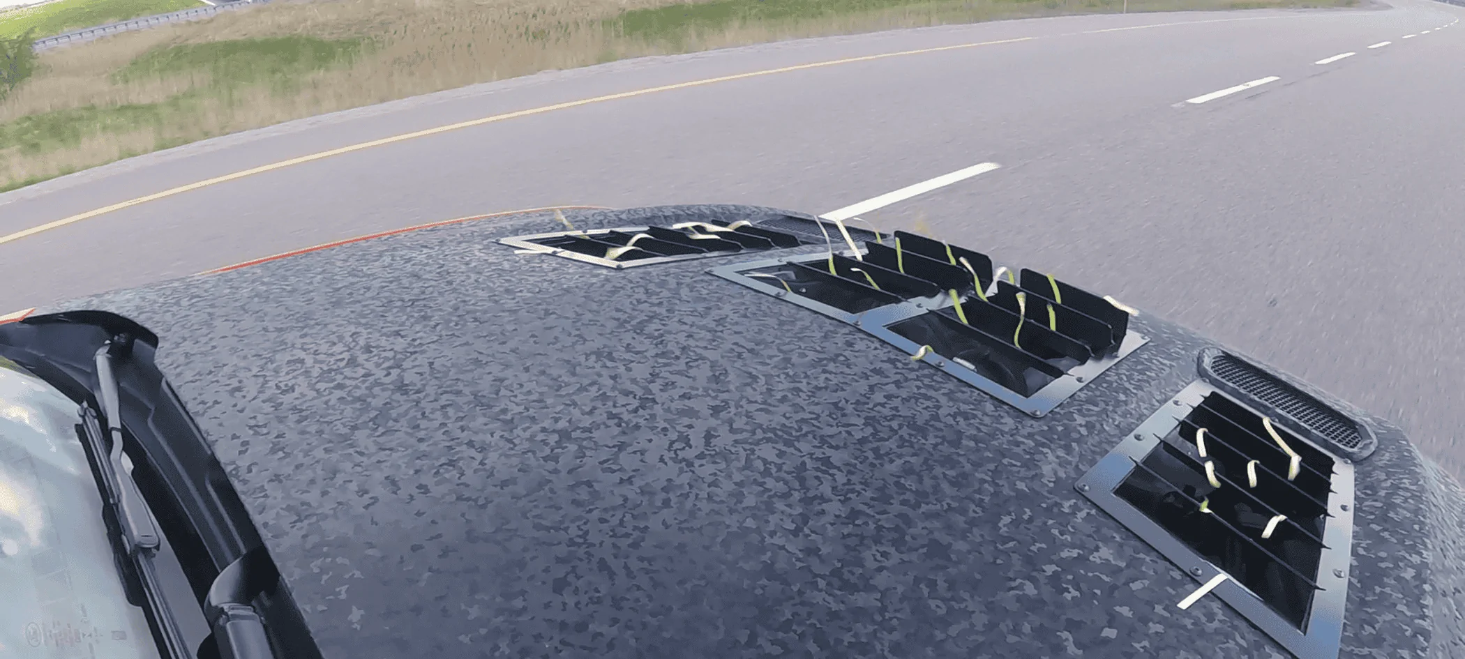

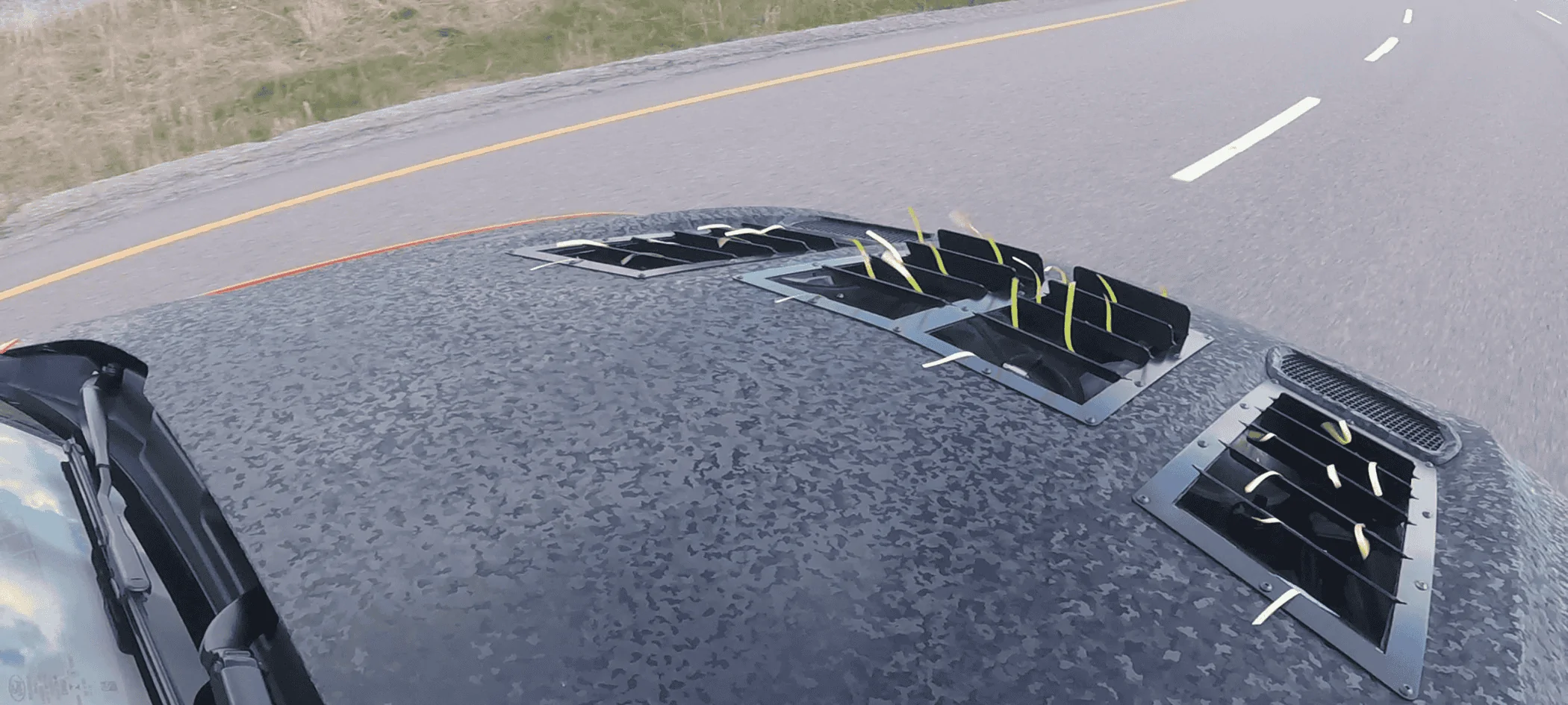

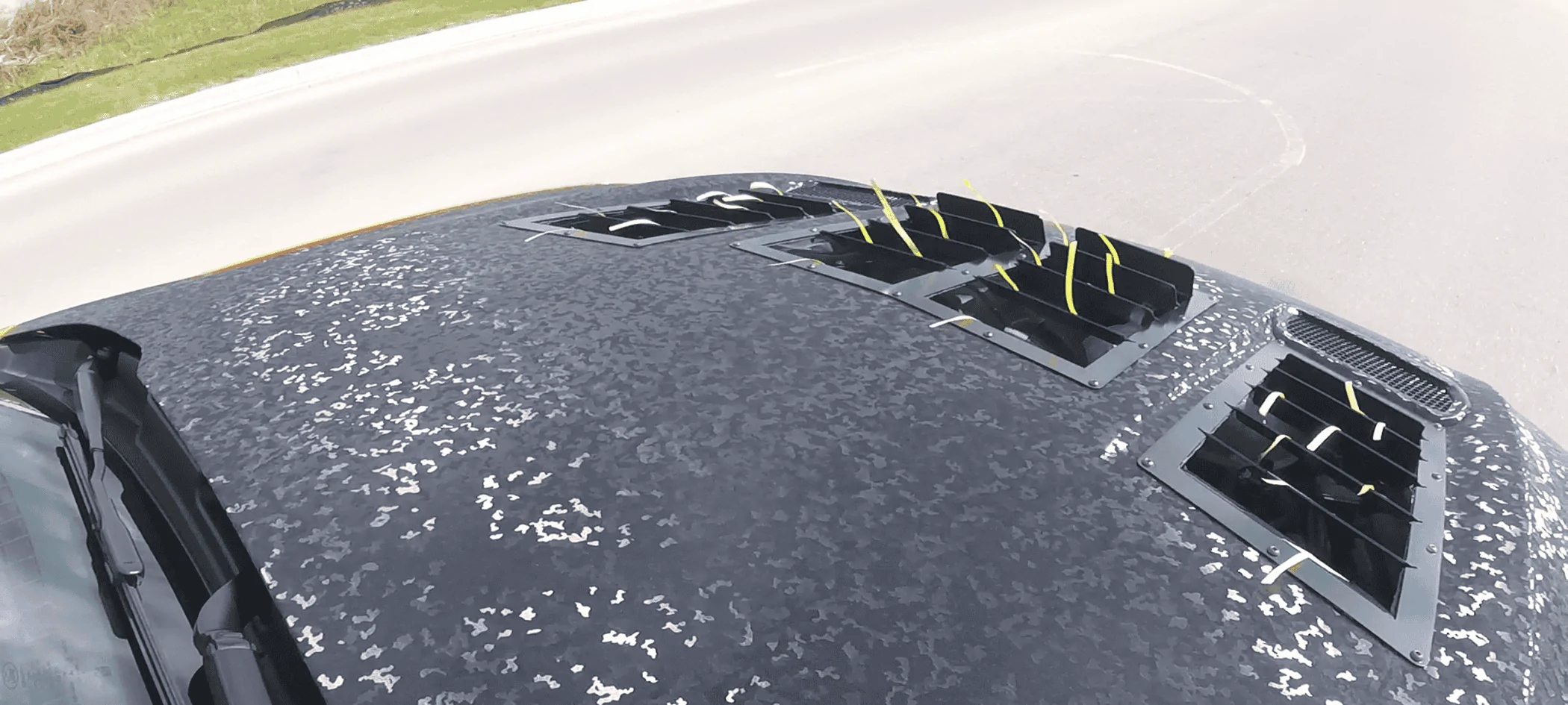

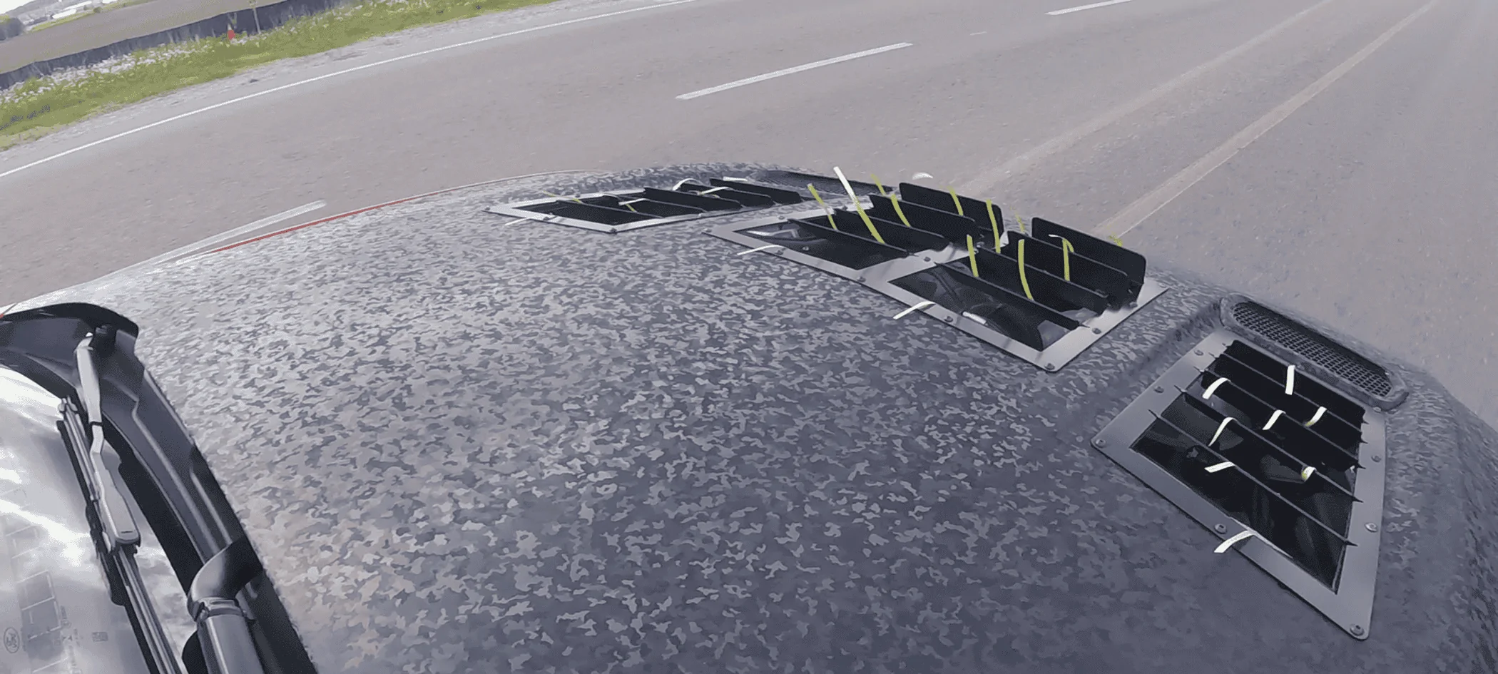

Ok, so video didn't exactly work out, but hope the screenshots give a good idea - center vent stripes are standing up across the vent surface, side vents don't do much at speed. When car is standing, side vents help extract quite a lot of heat from sides of the engine. Behavior is consistent at undisclosed speeds that certainly didn't go up to 90 mph :giggle:
Are these RX vents? 2015-2017 only gets RT ;-; ordering mine tonight.

Roger. I am curious whether these Louvers will solve my heat problem without having to add the heavier CSF rad. We shall see.
