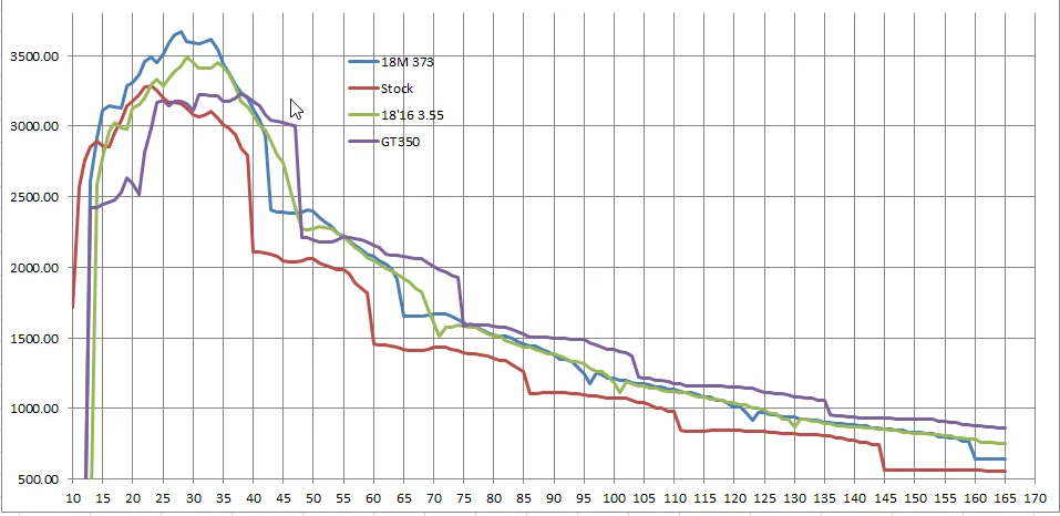

For fun, here's an example of torque by gear, which is the kind of analysis you'd want to do to pick a final drive for a specific track.
What I actually have graphed here are the final wheel torques of some estimated setups (of interest to myself). As far as y'all are concerned, just assume the numbers are made up. Torque is the push force you feel. With torque you can compare different gears and make smart decisions about gearing for your needs.
The short geared cars have an advantage (against similar power curves) right up until they have to shift. After they shift, they're much lower torque due to the new higher selected gear ratio, and the taller geared cars eat their lunch until they too have to shift a few miles per hour later.
(Ignoring the red and purple lines). You can see the green and blue lines, which mostly differ in gear ratios - they're trading positions before and after the shift points. Green shifts later and has an advantage for 5 or so MPH, but blue is shorter geared overall and has a bit of an advantage right after the shift. Blue shits the bed at 160 where it has to shift into overdrive 6th gear to keep going, where green is still in 5th. You'd like to stay out of the tallest gears, but you want the shortest final diff gear ratio that will do that.
[Unrelated to track] Also you can see where my old GT++ setup was ideal for many autocross courses with it's 2nd gear shift point at 64, while my next GT350 based drivetrain would have an edge by staying in 1st longer (to 47) and then again above 55 in 2nd where it's power can shine. If I short shift 1st to second at an autocross, I'll be behind all the way to 55mph
On a track, from 35-55 in 2nd gear (not shown) the GT350 is slower than a GT. Above 55 though and its game on because its taller gear ratios (and high RPM limit) allow it to stay in a lower selected gear for longer with a more torquey shorter gear ratio at the wheels.
This has been my experience in general. The 350 excels in that 50-70 zone, but the gearing and torque curve isn't exactly optimal for autocross. What it does allow you to do though, is be a bit of a hoon with the throttle input as the torque curve is slower and allows you to get on the throttle early easier as there's just less power available until you get the car pointed straight and then it comes on boil.
