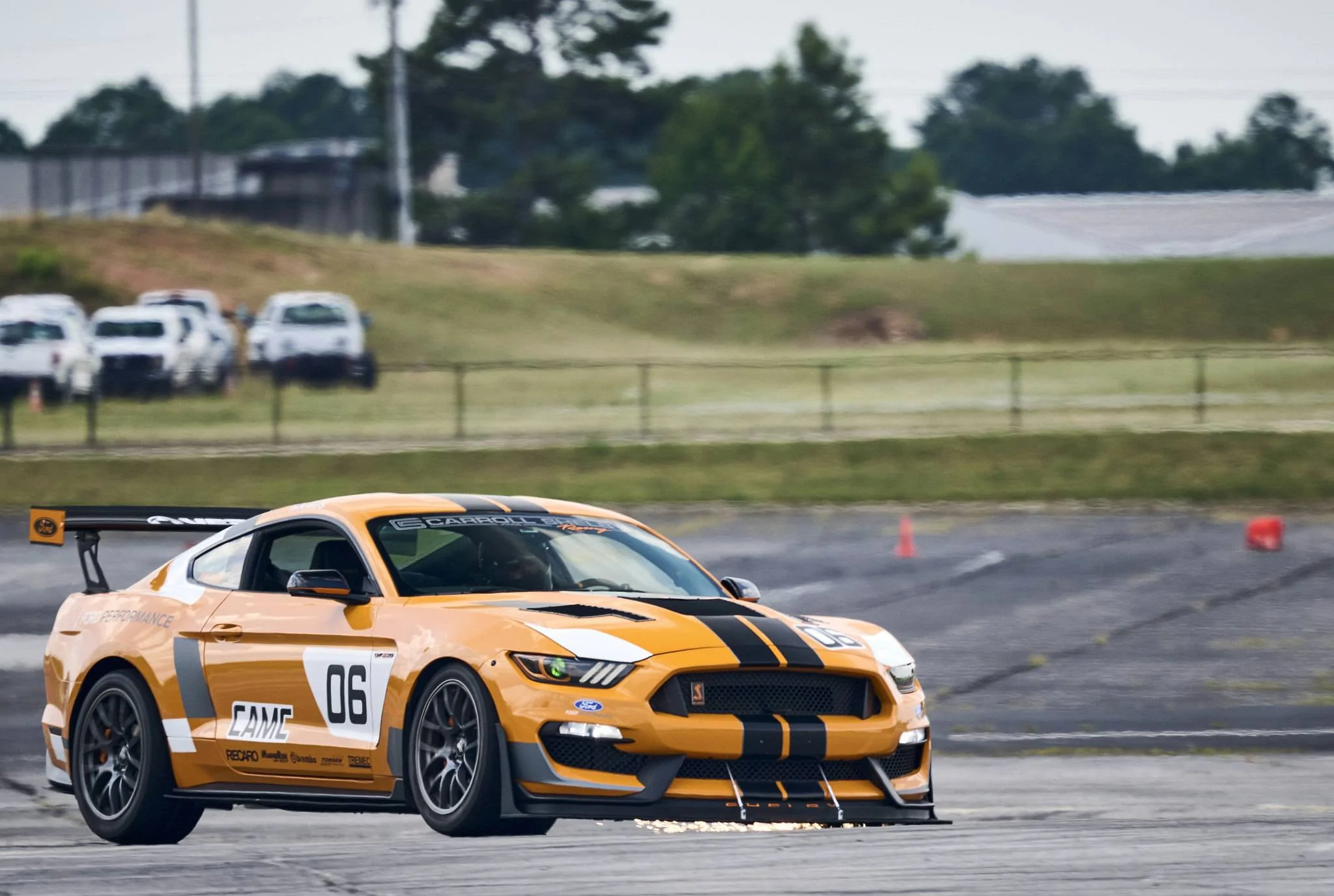

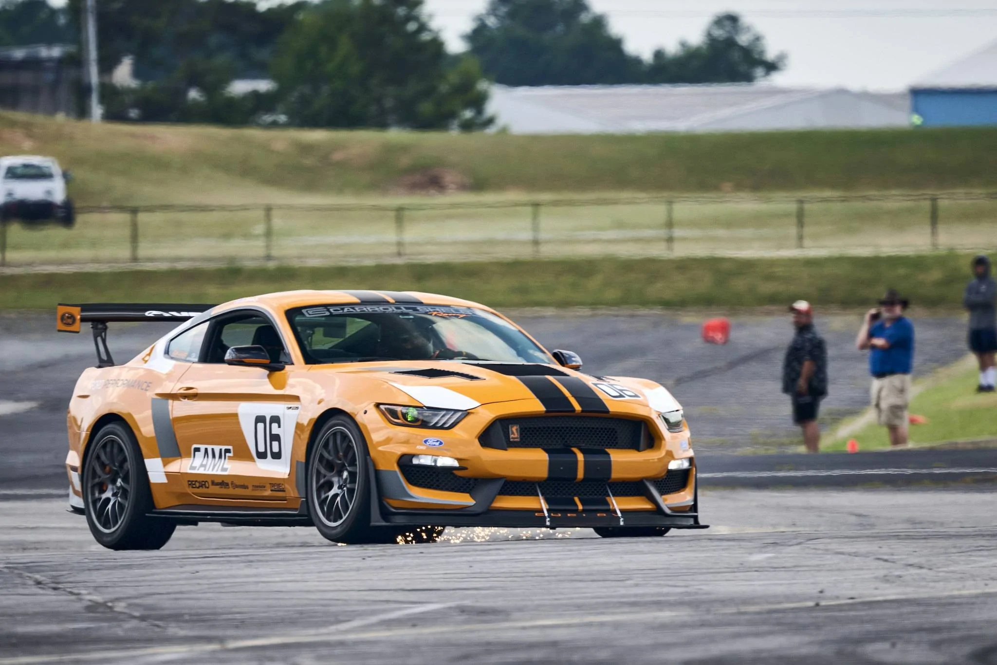

Well the titanium skid plates from Speed Italia and bumper repair mounts from LMR worked great and kept the splitter and bumper in one piece this weekend.
Made some big changes to the swaybars and the DSC suspension tuner and ended up with the front end too stiff in corners and was fighting excess understeer the entire event. Have another event this weekend and hoping that by going down a notch in the front bar we can get it to move right until we can get the spring rates corrected.
What spring rates are you on ?
Just the steeda Dual Rates for Magneride cars. It's not a mile off on the high end of the spring, but the first rate is about as soft as stock R springs I think. Wanting to get it up to the 500-550 range.

Unfortunately, I think they were trying to get a little too tricky. Usually with a dual rate, the 'soft' portion is only there to take up droop travel. It normally engages the stiffest portion of the spring at static load. I think Steeda tried to give it X amount of travel (say 1/2" -ish) of the 'soft' rate and then have it engage the stiffer rate as it gets deeper into the travel. I'm a fan of linear rates in most scenarios. I can see advantages to duals or progressives, but those gains are quite far out on the branch.
After using them I 100% agree. These were a notable step up from the Ford Racing springs I was on before so there is merit to the solution but about a month after I put them on the car AJ Hartman dropped his 2.5" coil spring conversion for magneride cars and I would have absolutely bought those if they were out. Tried to make these work, but their compliance is part of the problem.
