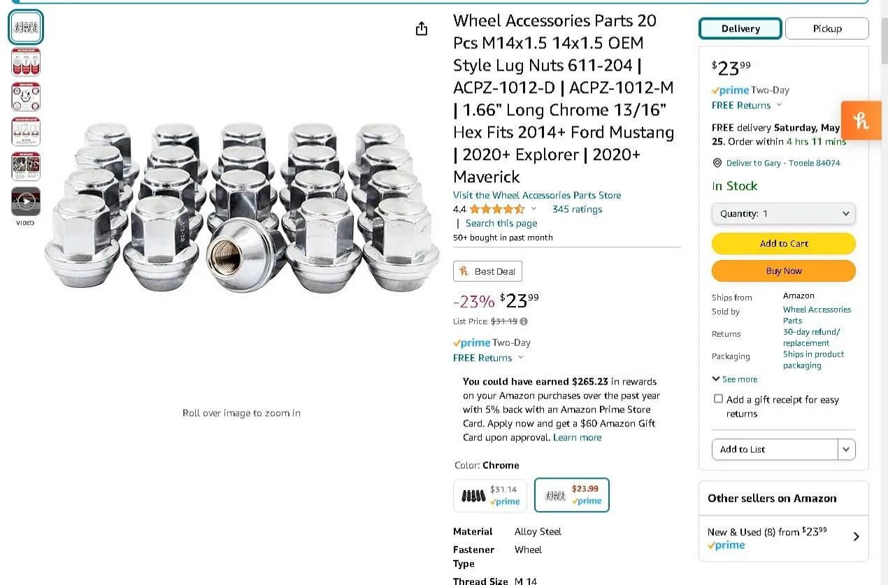

Changed out my winter tire wheel set to my all season tire wheel set yesterday on my car and noticed a few of the OEM lug nuts are starting to swell and get a little warped. I want to get a new set of lugs to use later this fall when I put my winter tire wheel set back on.
I am looking for a solid 1 piece steel lug nut set to put on my 2016 GT/CS with OEM factory rims. I did a little research on the forums and found a couple threads saying Gorilla 61148FS lug nuts are a good choice for replacing the factory 2 piece capped lug nuts. Are there other recommendations for 1 piece steel lug nuts for OEM wheels?
To clarify, I am not using aftermarket rims. I have 8 rims total of the factory black painted California Special rims; 4 rims have the Pirelli P Zero Nero all season tires and the other 4 have Pirelli Sottozero 3 winter tires on them. Specifically looking for a good set of quality lug nuts that will last a long time, won’t be easily warped and are compatible with factory rims.
I bought these from Amazon because I wanted the same chrome look as the OEM capped ones; they look the same except they're solid one-piece nuts.
