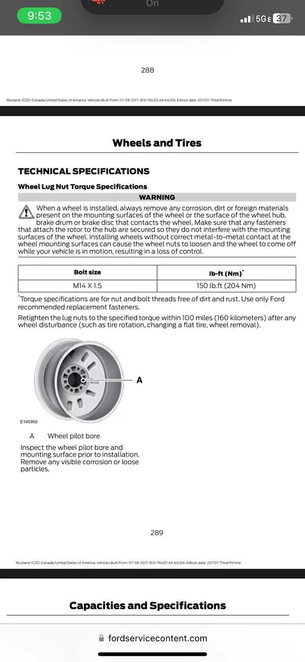

I'll bite. Because you're doing it wrong. Ford doesn't set the 150lb/ft spec, that is determined by the diameter of our wheel studs.
150ft/lb is the only correct number for the stock studs. Anything else is wrong.
Actually, the manual for my 2020 GT PP2 states 150 plus/minus 15, so anywhere from 135 to 165 meets spec. I would have to double check, but I am 98% sure that is what is listed.
I have Apex EC-7's, ARP studs and 1" spacers in front along with Gorilla lugs (and one McGard lock nut.) I torque everything to 150. I would never buy a set of wheels that would recommend less.
Doug
Silver Bullitt
Feb 26, 2018
2,391
2,295
Parkville, MO
2018 GT Coupe PP2
I’d be interested to see that in print. The manual for my 2018 PP2 is pretty clear.

Well I was wrong about it being in the owners manual, but I knew I saw it somewhere. It’s in the performance pack level 2 supplement, page 10:
https://www.fordservicecontent.com/...k-2-Supplement-version-1_su_EN-US_07_2019.pdf
Guess technically it only applies to PP2 cars, but studs are the same, so not sure why.

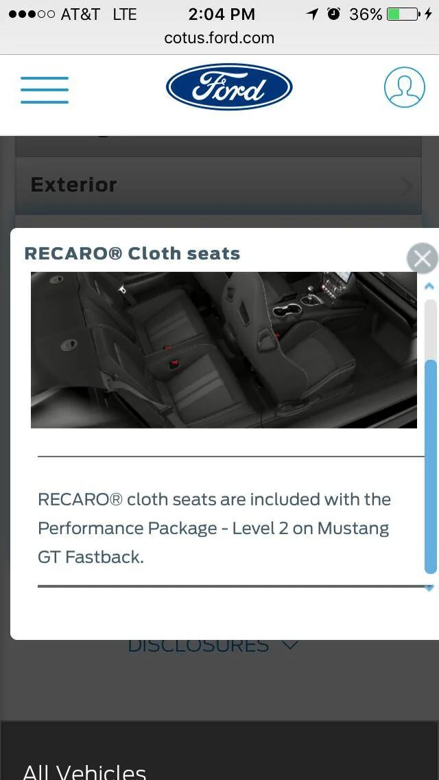

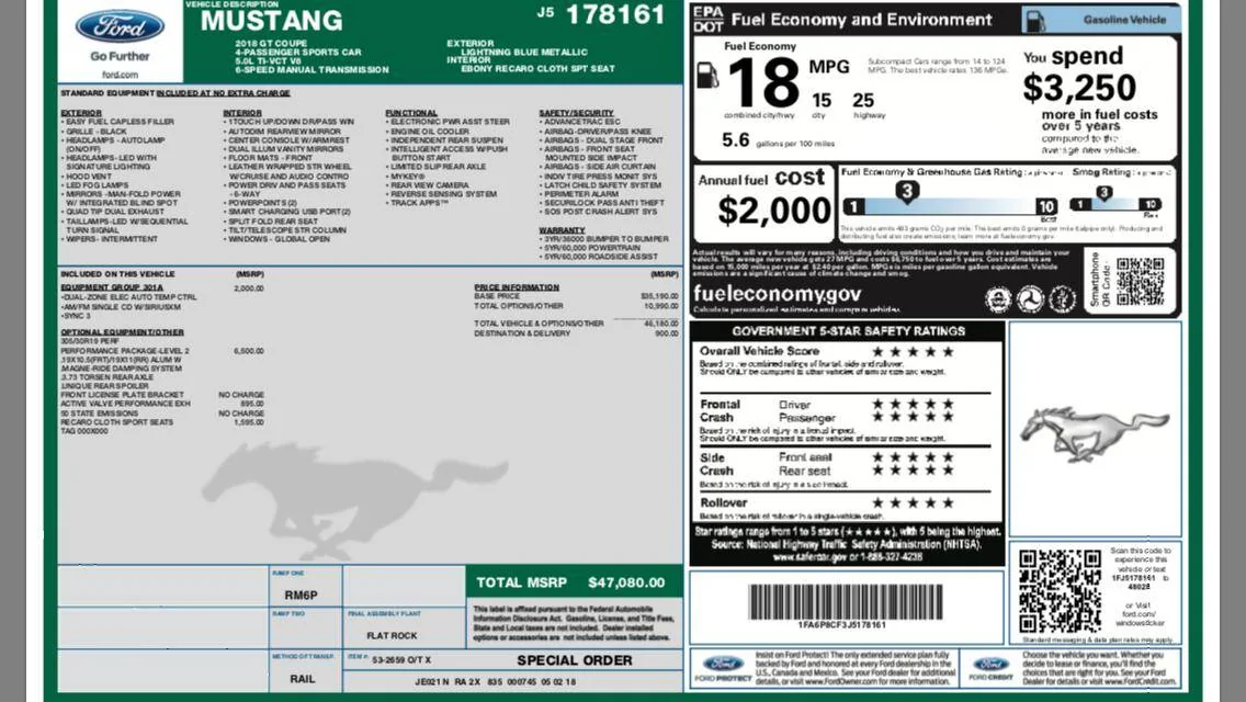

Thanks for sharing. I have never seen that supplement before. I never received that with my car. I noticed it said for vehicles built after 7/15/2019. Mine was one of the very first PP2’s built. The PP2 was not available until late in the model 2018 run. Most people don’t know that cloth Recaros were actually a free ($0) option on the first PP2 models built. It’s really weird the way this transpired. It changed from a $0 option to a $1,595 option almost immediately like it was an error in Ford’s ordering system. But, I have literature and a window sticker example showing them as “NO CHARGE”. This actually changed between the time I ordered my vehicle and the time it was built and delivered. My window sticker actually shows the Recaros as a $1,595 option, but the price I negotiated was based upon them being a $0 option. My dealer is a stand up dealer and honored the original agreed upon price, but I was shown the manufacturer charge (at cost) included on the dealer’s invoice for my car. I know they were appealing it to Ford but never followed up with them to see if Ford honored it or not. (Sorry for the poor quality of the window sticker pics.)

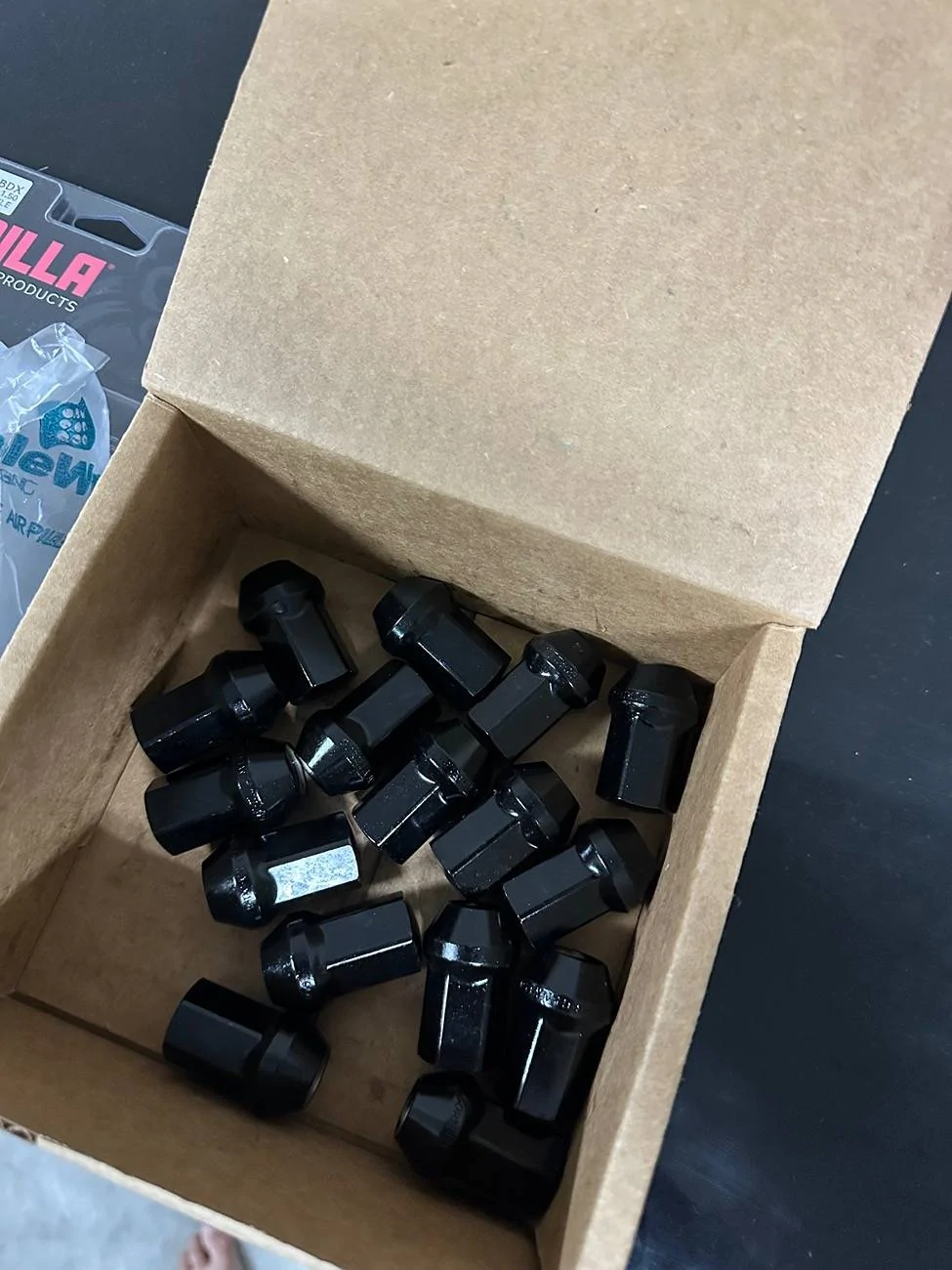

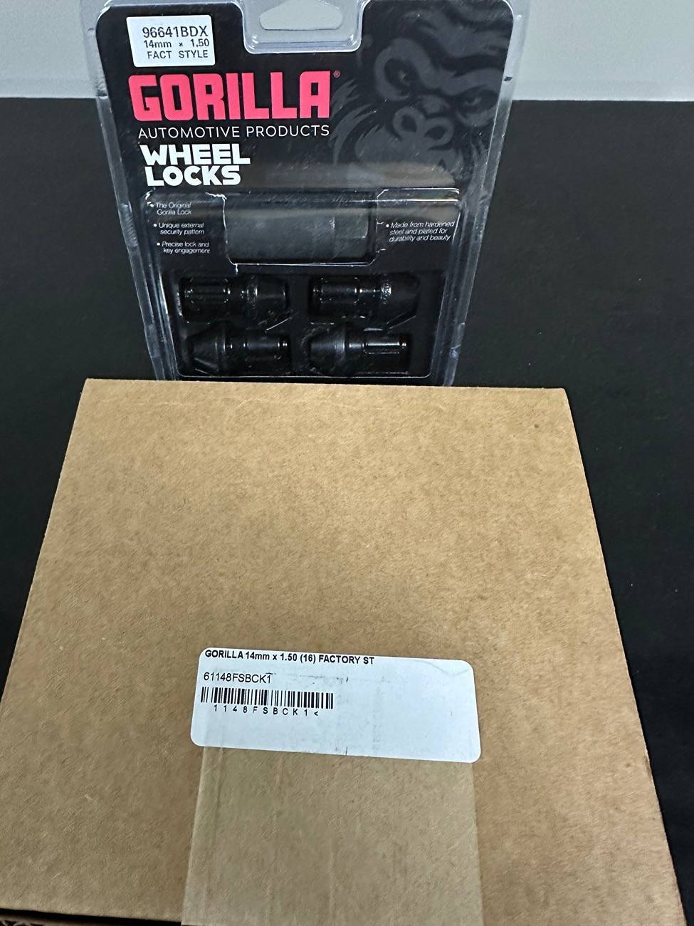

Received the Gorilla kit. For the price, I was surprised the lugs were shipped loose to beat and bang around. I guess they’ll get marred up soon enough anyway.
Yes, I was a little surprised as well when I received mine for my last truck. They were just loose like that in a box. The McGard’s always came individually wrapped, which was what I was expecting. I guess maybe just consider that’s their break-in period.

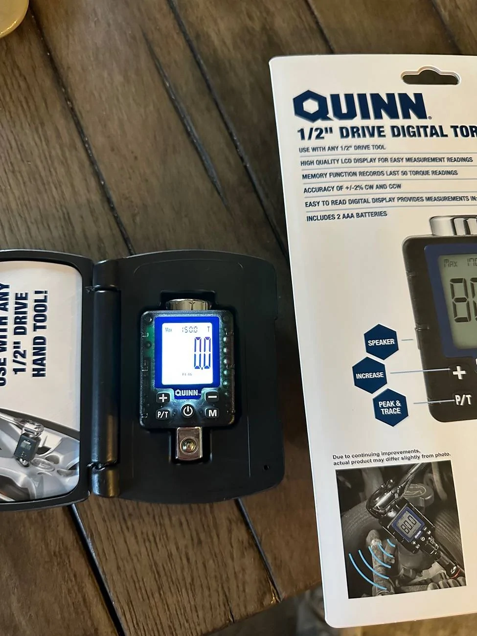

Picked this up from HF - will hopefully turn the lug wrench that came with my scissor jack kit into a 1/2” torque wrench. It weighs nothing & fits in the bag storing the jack and accessories
