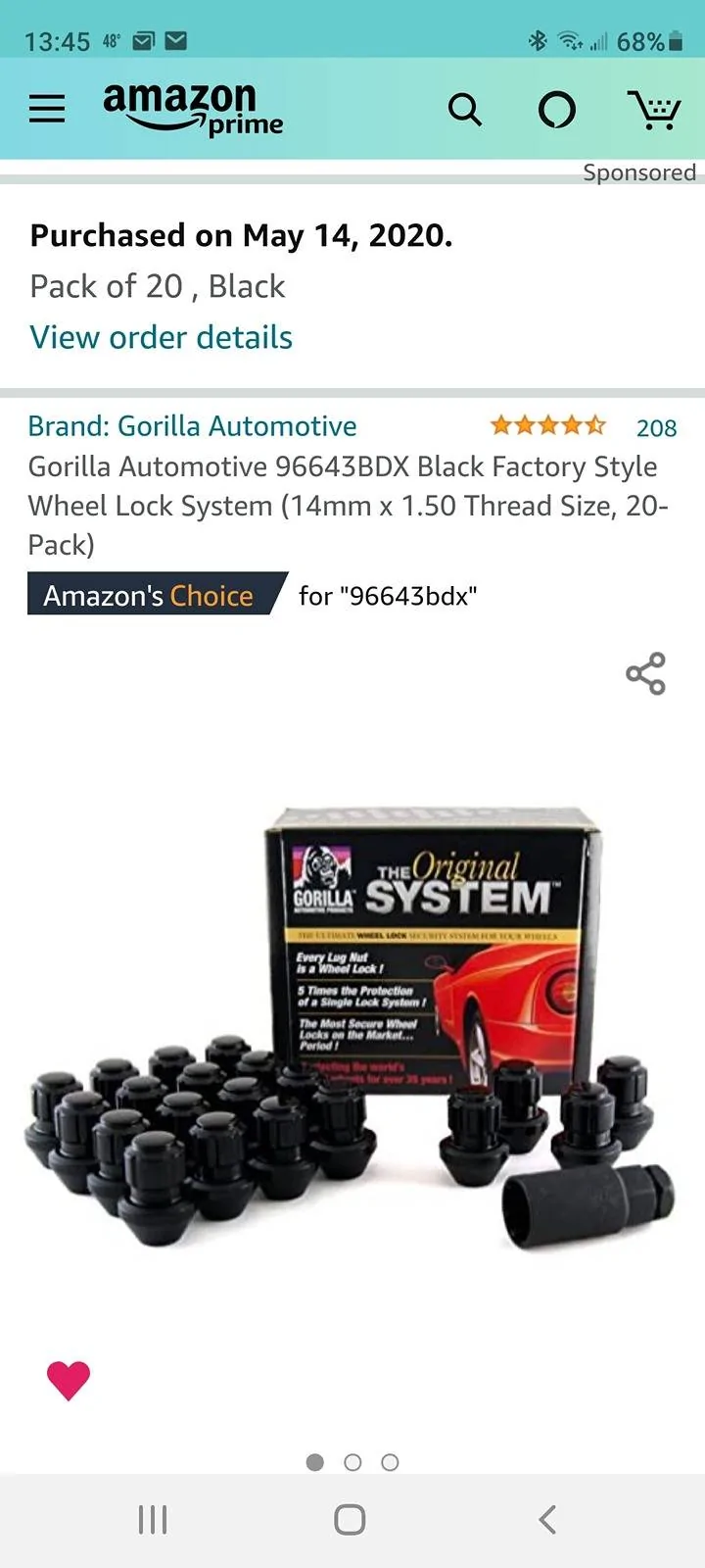

I have these and have been very happy with them. Bought two extra keys for them as soon as they came. I know any lock lug can be defeated but it's a bit of extra protection and they all match.

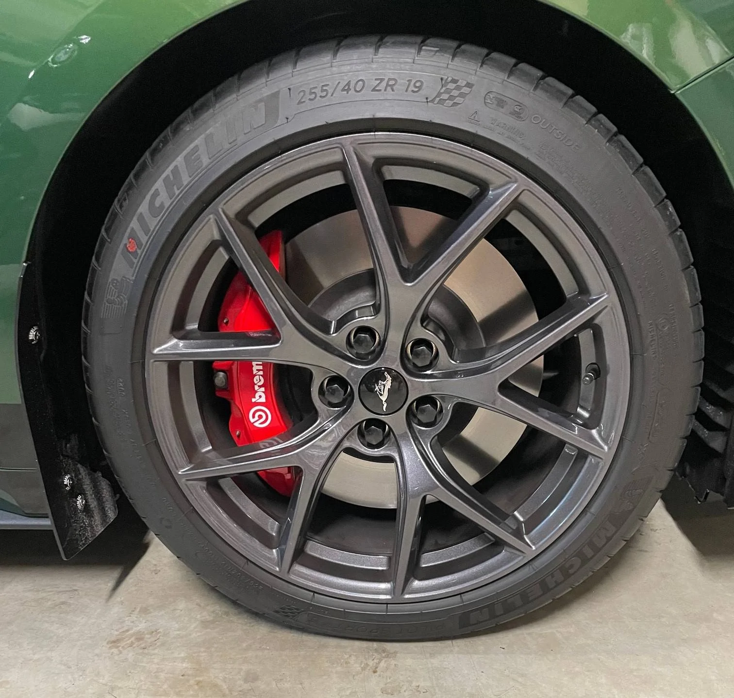

Here's a photo I just went out and took, dirt and all. I haven't given it it's spring clean yet. 4 ish years of use.

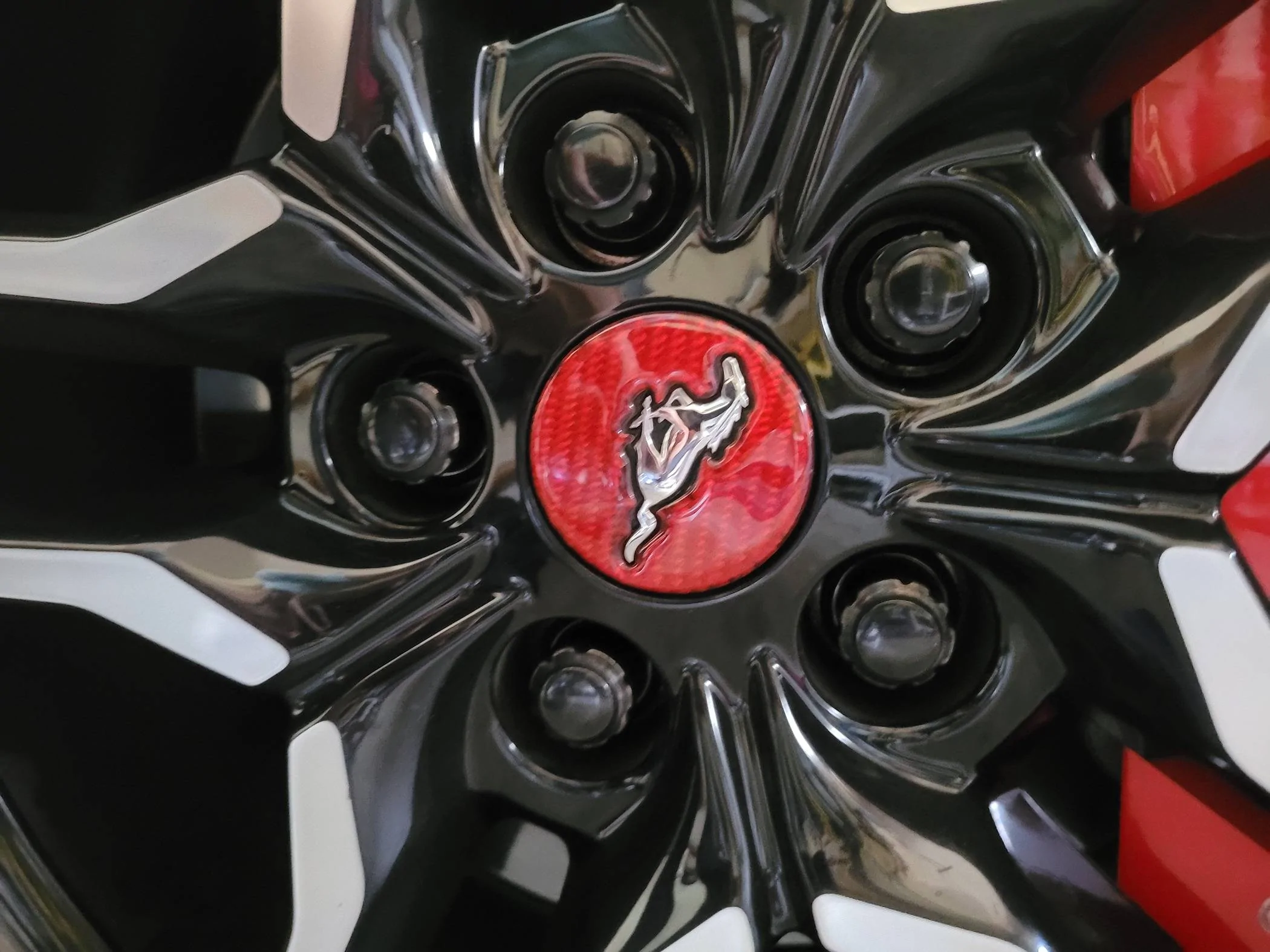

Gorilla also makes regular black lug nuts for Mustangs. Finish is doing well over the first year but I always take care to use a 6-point socket and a manual wrench to help reduce damage.
