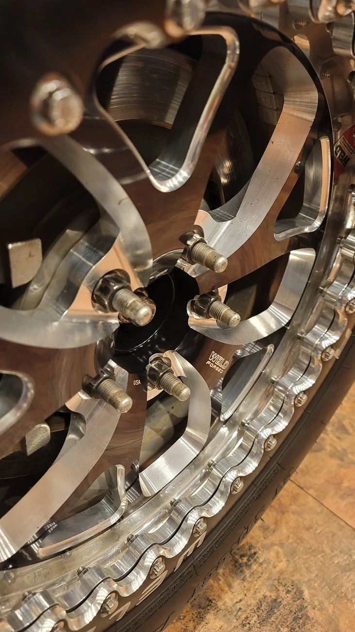

Impulse bought belmont beadlocks on the way home from a trip to florida.. what lug nuts should I use to put them on? Didn’t think that through lol.

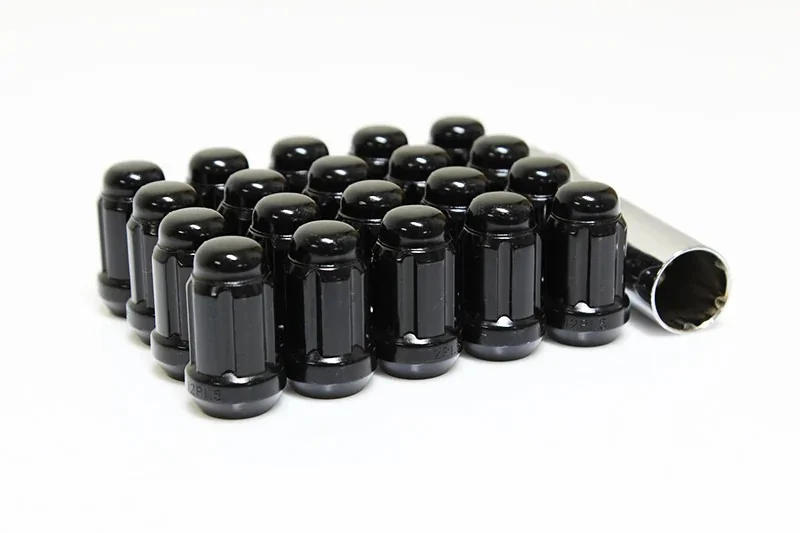

They take acorn lug nuts. Do you have stock wheel studs or ARP. If stock use some spline drive tuner style lugs. If ARP run acorn open ended.

Yeah I'd go with some good spline drive lugs if you're on stock studs, McGard makes some solid ones that'll work great with those Belmonts.

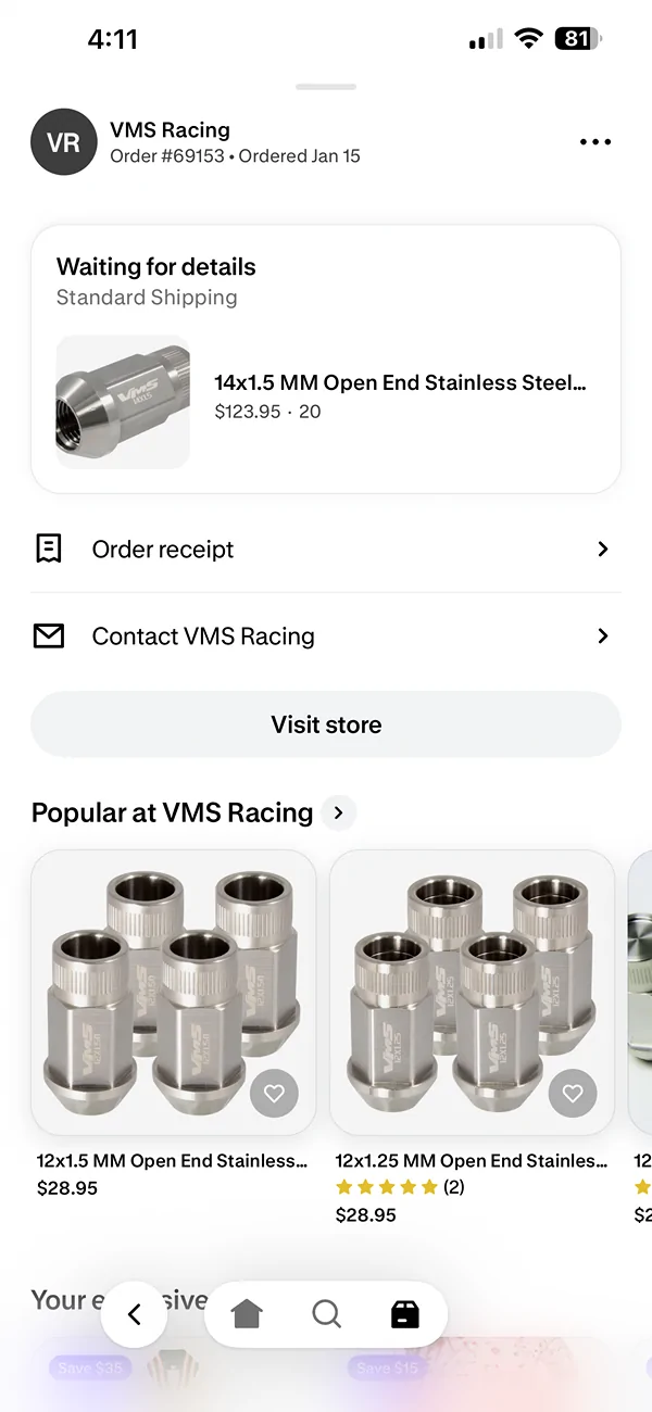

I ended up going with these VMS ones, should they be good?
You can run those, just know oem studs are very short and will likely thread 1/3 of the way thru those. The tuner style are shorter and closed. Looks will really be about preference.

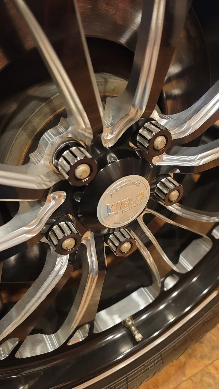

This is my setup, arp studs and open acorns on the rear. Arp studs and open aluminum shank on the front.
Best way to go above , and if you go to the track ,I would want open end , and stud threads pertruding thru end of lug nut ... visible may still be an NHRA rule.
