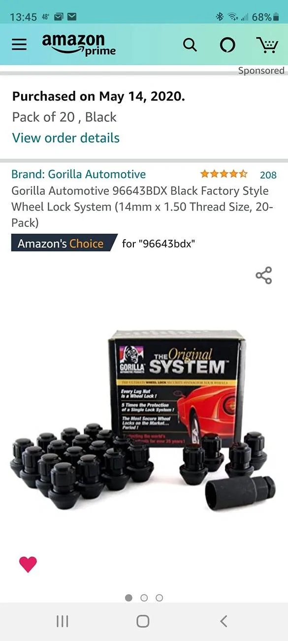

AFAIK all ford's lug nuts are two piece.
A very big part of how they last will depend on the climate you live in. Rust belt cars will have them swell and fail far more often than warmer dryer climates.
Living in the south I've had mixed results with the stock lug nuts. My '12 Edge has been swapped for solid lug nuts, just inexpensive chrome ones. My '14 Fusion has still got stock lugs, mostly because I have a lot of spares from the Edge and Mustang. I swapped the ones on the Mustang for esthetic reasons, I wanted black to match the wheels. I used Gorilla and will post a picture. The Gorilla's have been on about 4 years with no issues at all with the finish or the high lug torque.

Thanks everyone for the replies. I’ve seen Gorilla mentioned often. Is there a particular size for my application or should I speak with someone at Gorilla to determine what I would need?

I ordered mine from CJ Pony parts. Put in my model and they sent me the right ones.

any of their 14x1.5 thread 60 degree conical acorn bulge
