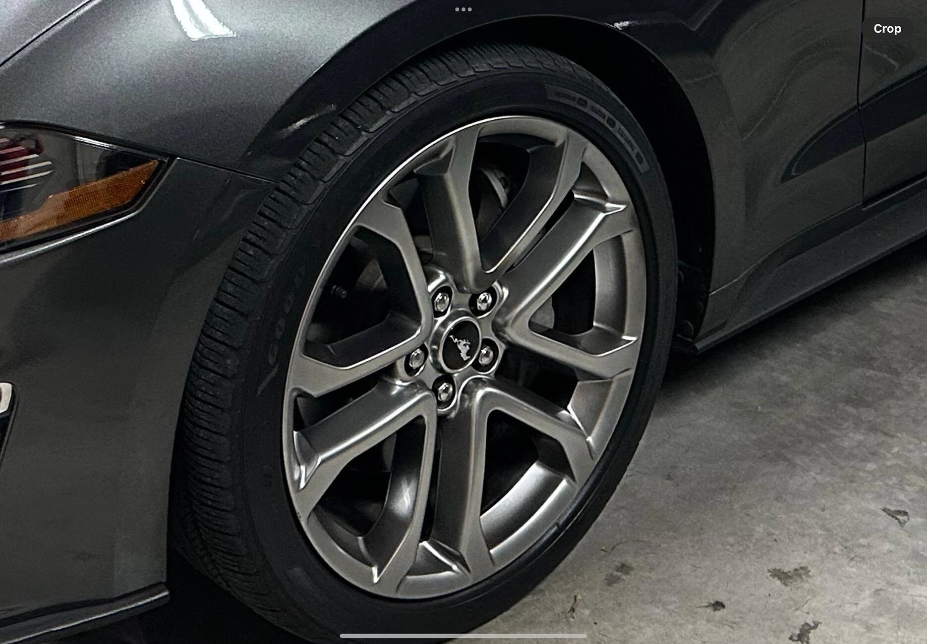

I bought those with my hubs from them.. I just was looking for some more decorative OEM look for when I have my regular tires and rims on the vehicle. I was hoping Gorilla or someone else would be a solution.
Understand if you are going for a "look." I personally don't care, I just need them to hold. With my combo of extended lugs and these open lug nuts, I have good results from using impacts or just simply running the recommended TQ settings vice the 150 requirement from Ford's products.
I'm sure the Gorilla's are a fine product. I just desire dependability.

It’s just for when I have stock rims/tires on and I’m not at the track. I see open end ones longer ones. I’ll look into it.
I don't understand that statement. Are you somehow trying to imply that Gorilla Luke nuts are not reliable? Mine have been far more dependable and reliable than the junk Ford installed.
As for open ended lugs I'm sure they are more versatile for track use. The thing is probably 98% of Mustangs never see a track parking lot much less make it onto one. And that 98% is far more concerned not seeing a bare lug/stud than worried about constantly changing wheels.

I don't particularly love the black Gorilla lugs, after taking them on/off a few times the edges get messed up.
And the black paint fades faster than the paint on my wheels, so they look slightly off if you look close. When they were new they looked great. So I can see the value on some shiny lugs.
I have my OEM lugs still and they are in perfect shape, being used half the year with my winter set in bad weather. I only remove by hand/do not use power tools when I change my wheels.
