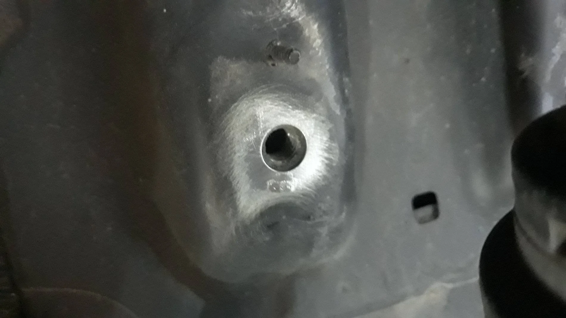

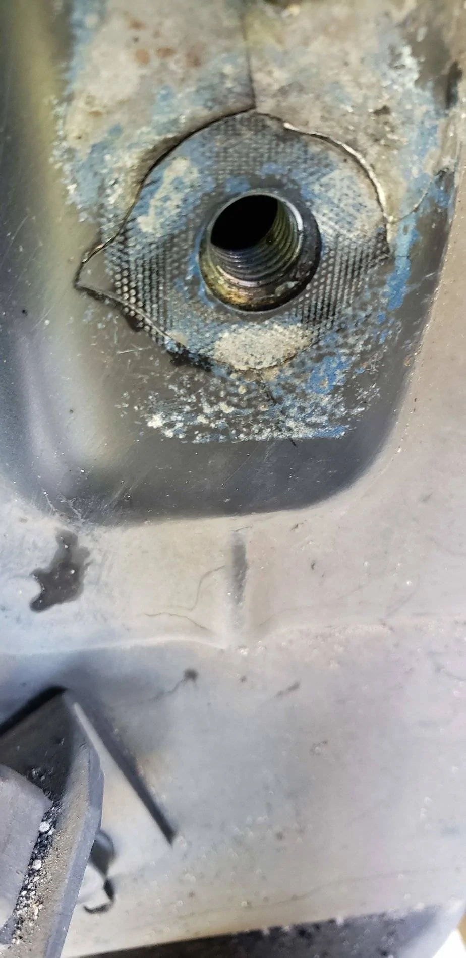

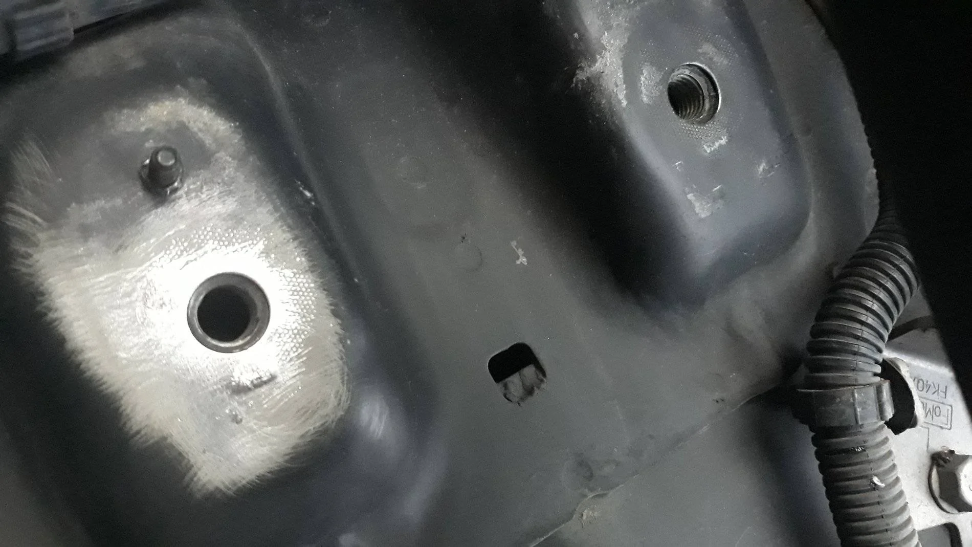

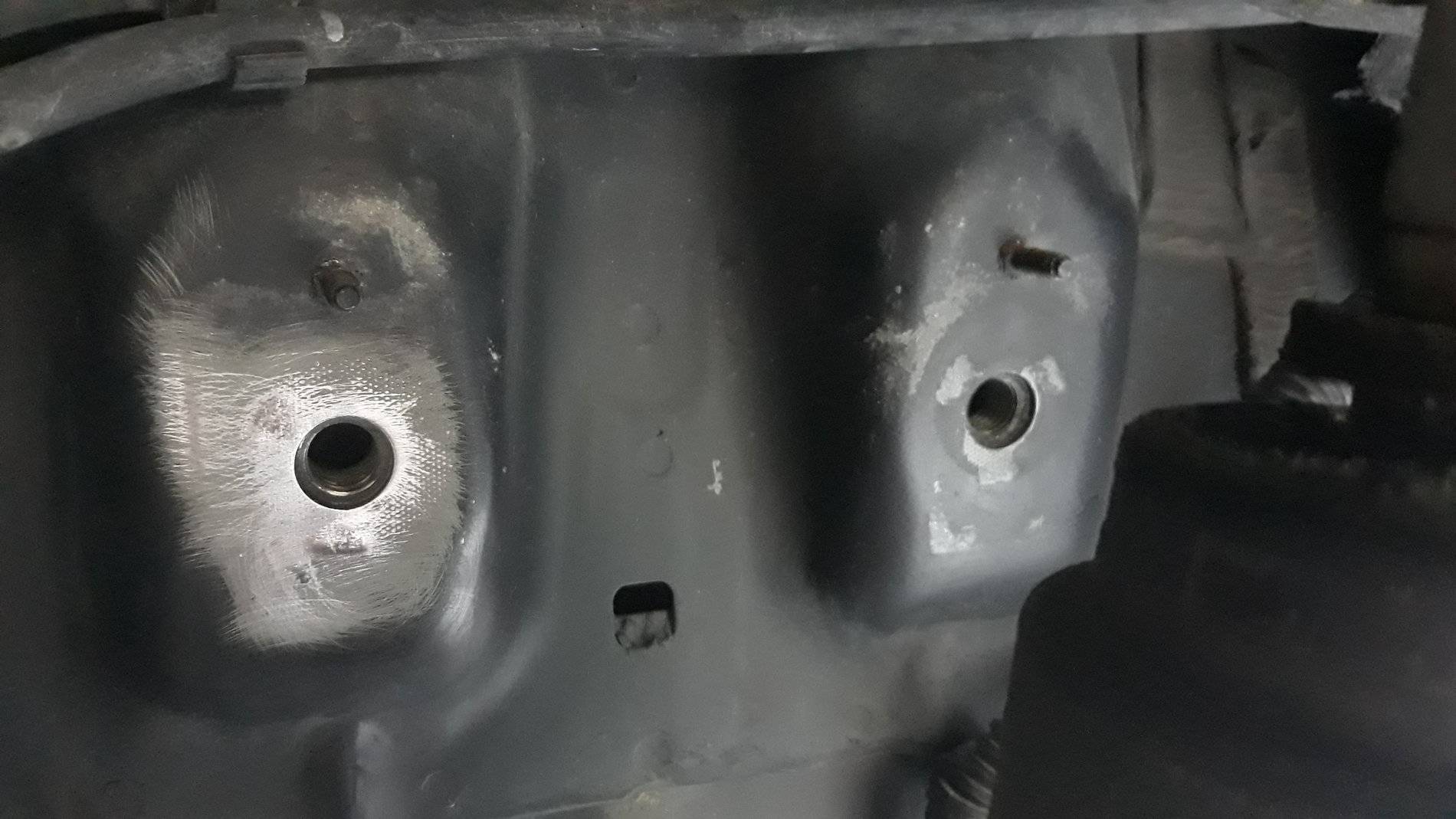

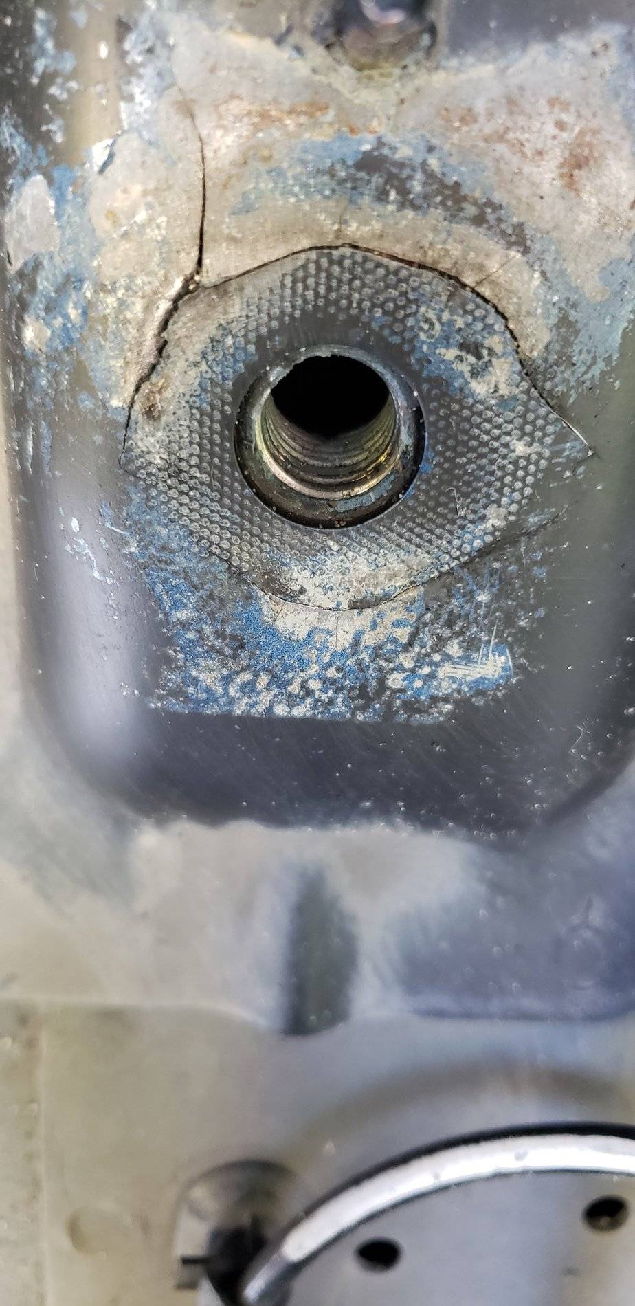

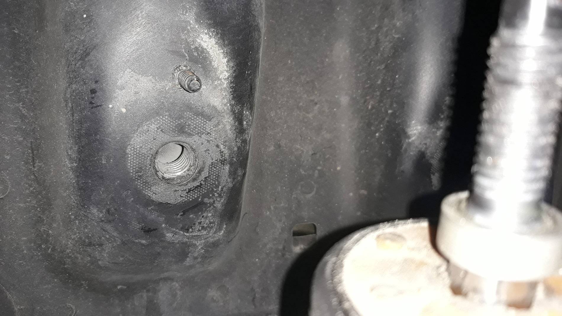

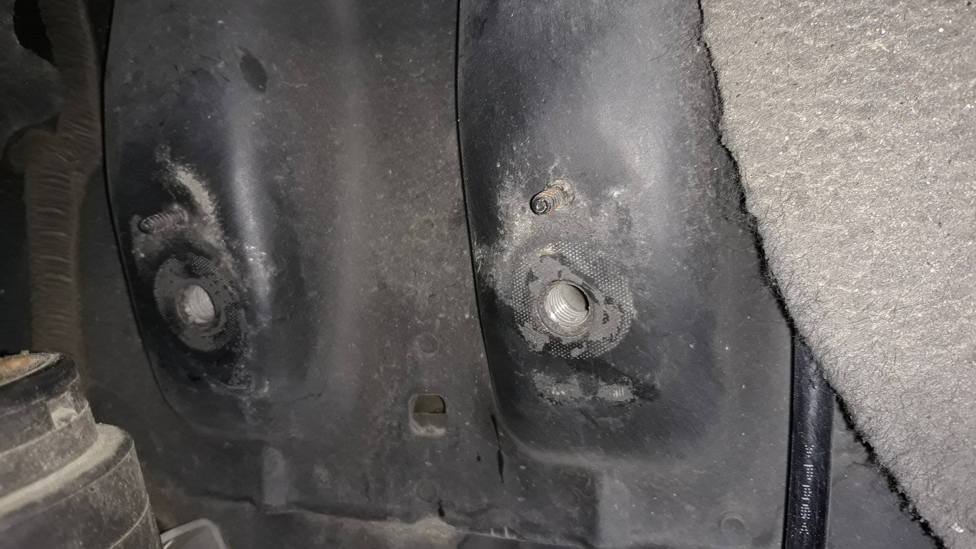

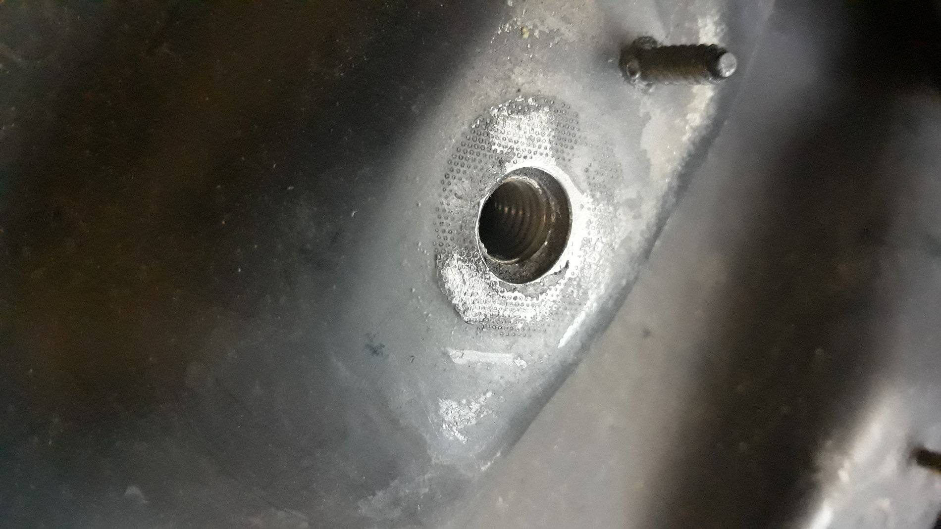

pulled mine off after 6-8 months to inspect. stock PP suspension with RLCA bearing. didnt see much but the bottom weld on the nut looks like its starting to pull through on the sheet metal. on 2 of the nuts (1 on each side) the bottom weld sticks out noticeably further than the others. the rest are still flat.
i didnt take photos of what it was when i installed but i dont recall any raised portion around the bolt hole. appears the load is being placed directly on the welded nut, and the sheetmetal flexes a bit. notice the 3 points of contact around the bolt hole that have spots of paint flaking.
maybe im being a bit anxious with this one part, or maybe its before the metal fatigued to failure, thoughts?

I should have labeled. First 2 are driver side. It's the front bolt hole. Last 4 are pass side and it's the rear bolt hole

The longer this thread goes the more suspect the Ford chassis mount points are. I think the solution is going to be to plate the Ford with perhaps 0.90" like we would for a rollcage backing plate and bolt the shock mounts to that. Or weld more plate to the shock mount like Ridetech and add some rivet nuts to the Ford chassis.
Ford putting the joint in bending was the first mistake. There's a reason why most shocks have fasteners oriented in straight tension & compression or in shear (strut mounting).

what im seeing in these pics is the sheetmetal around the bolthole cracking but the bolthole looks ok. can someone confirm that its the sheetmetal that is the structural support for the shock?
If there's enough clamped load those bolts shouldn't be in bending.
