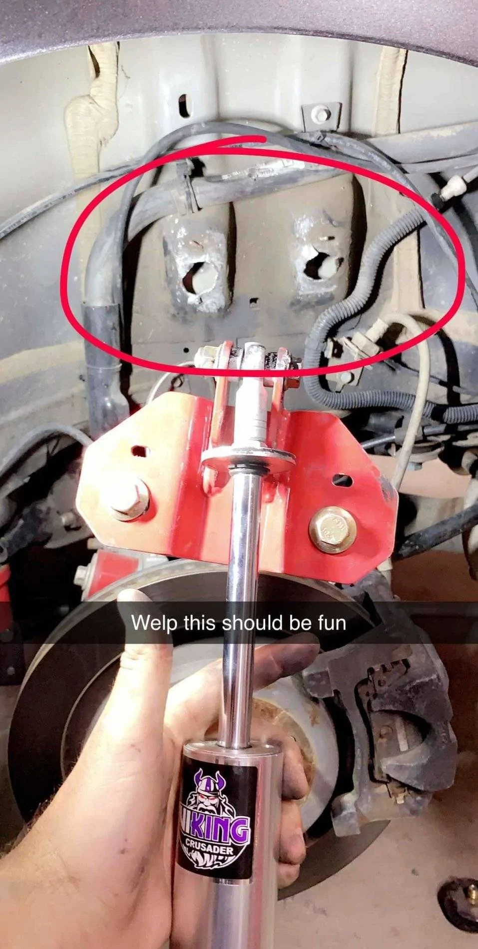

I have over 10k miles on the original BMR. Many autocrosses, track events and DDing. No cracks or anything. They were revised to get additional wheel clearance...that's straight from the people who worked on the change. Current rep doesn't seem to have a great handle on this or much else. I'm not going to bash people but there are reasons why they failed on certain users cars. See the problem on this one? People need to stop the scare tactics.

Any mount, except stock, will remove the sacrificial portion. No aftermarket mount keeps this design.
Proper bump stops are imperative. be mindful and avoid large pot holes and abrupt intrusions in the road surface or slow down when crossing them

4 months on my BMR mounts with the stock uncut bumpstops and I can't remember even maxing out the travel enough to hit them yet. With no bumpstops like the guy that ripped out the threads, you're gonna have a bad time. I talked to a Bilstein engineer (a friend of mine) before I installed them, he said he couldn't see how I'd ever have a problem with my setup, since the additional height would give the factory bump stops plenty of time to dissipate the energy from a pothole event. Good enough for me.
