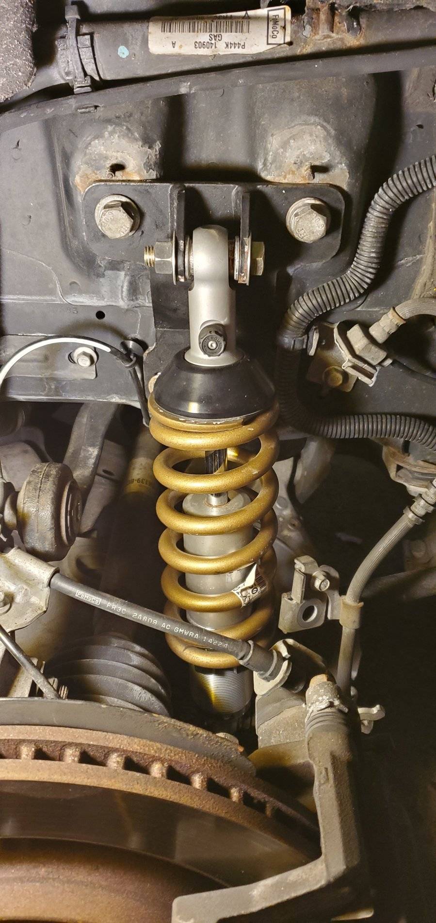

The kit looks like the Vorshlag MCS TT2 one and in the pic you can see the front springs are 600lb or GTS package rate. Can't tell from the pic what the rear spring rate is but if it is the GTS kit then it would be 750lb. Vorshlag says 60mm front springs and 2.25" rears. Probably 6" long at each end.
Correct! I just did not feel comfortable with the bigger rates on his other package. Terry says it works and is smoking fast "trust me." I'm more of a softer spring bigger bar guy. So I compromised and took his middle package and those rates are still higher than what anyone else runs of I mentally feel comfortable with. They are certainly higher than BMR's fastest setup or the GT350R setup. I forget the chassis frequency I estimated but it was pretty stout for a non-aero car. I get the exact frequnecy when I weigh all the components and do the math. I figure I'll try this and best thing are springs are off the shelf easy and cheap to buy in any rate I want. So if I want to go softer I can and Lex at MCS (former best guy at Moton left to start MCS) says these shocks can take quite a large range of rates before I have to revalve them.

The rates you got are not too far above the traditional go-to of 2 Hz baseline for a low aero street car. The problem with big bar on the rear of this car is that you won't be able to put power down.
I just installed RideTechs with 425 / 550. I previously had the GT350R and BMR handling springs with the FP track dampers.
