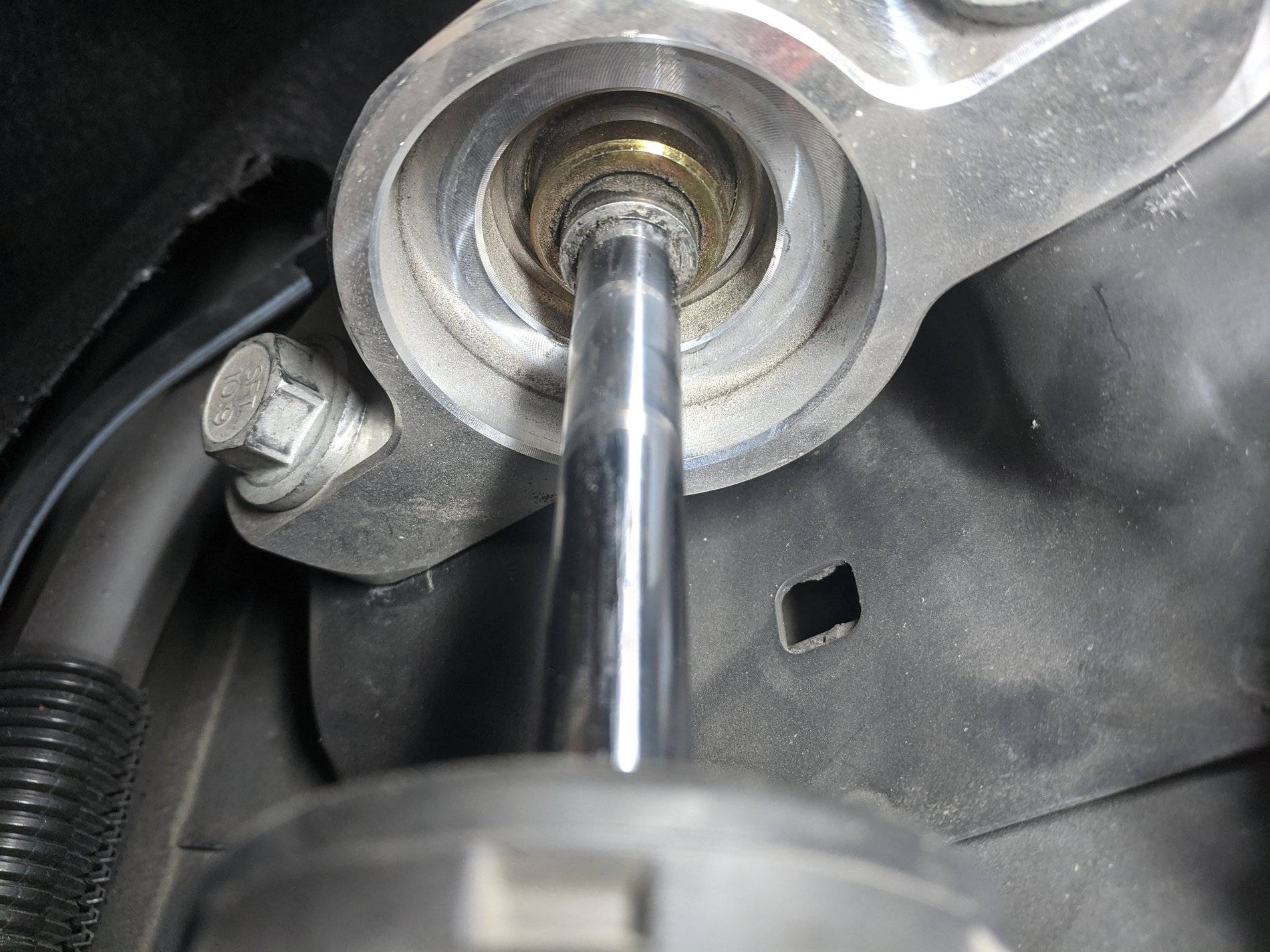

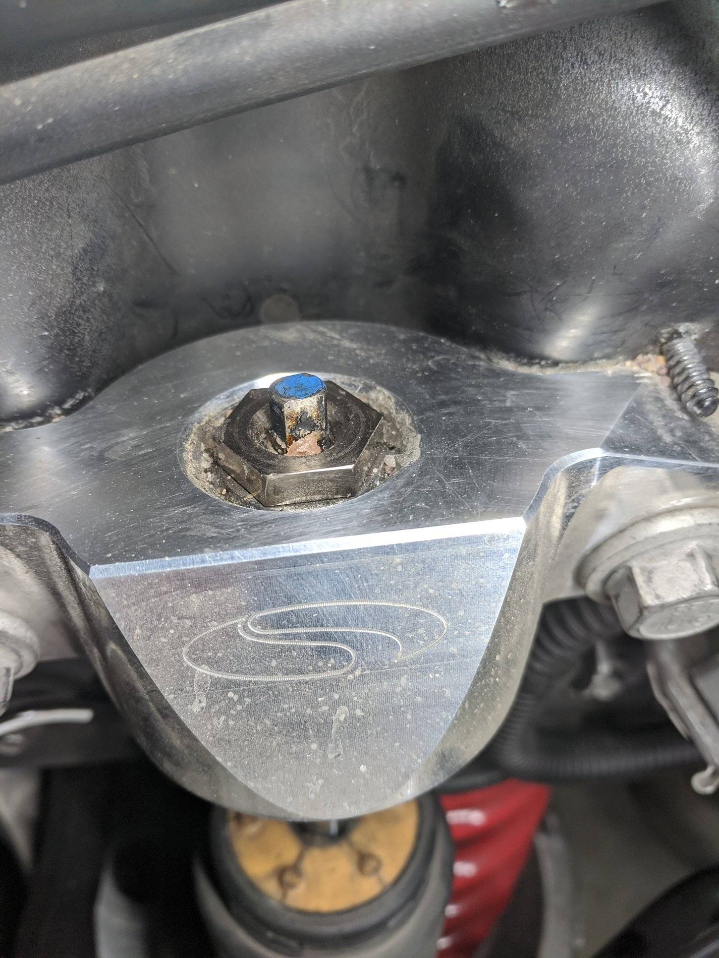

I had enough time last night to pull the driver side rear wheel and removed the bottom shock bolts. The shock is tough to compress much, but from what I could tell there didn't seem to be much of any movement in the bearing. In hindsight, I should have pulled the top bolts too and removed the shock and the mount as a unit and it would have been easier to determine an issue. Duh, it was too late last night, brain no worky.
Anyway, here's a couple pics of the mounts I have in case it would help anyone else as well:

@Strokerswild looks like there is bulge on the bottom weld of the front bolt hole just like mine. Maybe its the camera angle. Right at the edge of the mount below the bolt.
Pull the mount off and feel. Wire wheel cleans up the roads grime and paint for clear inspection.
