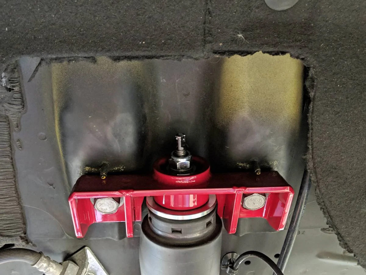

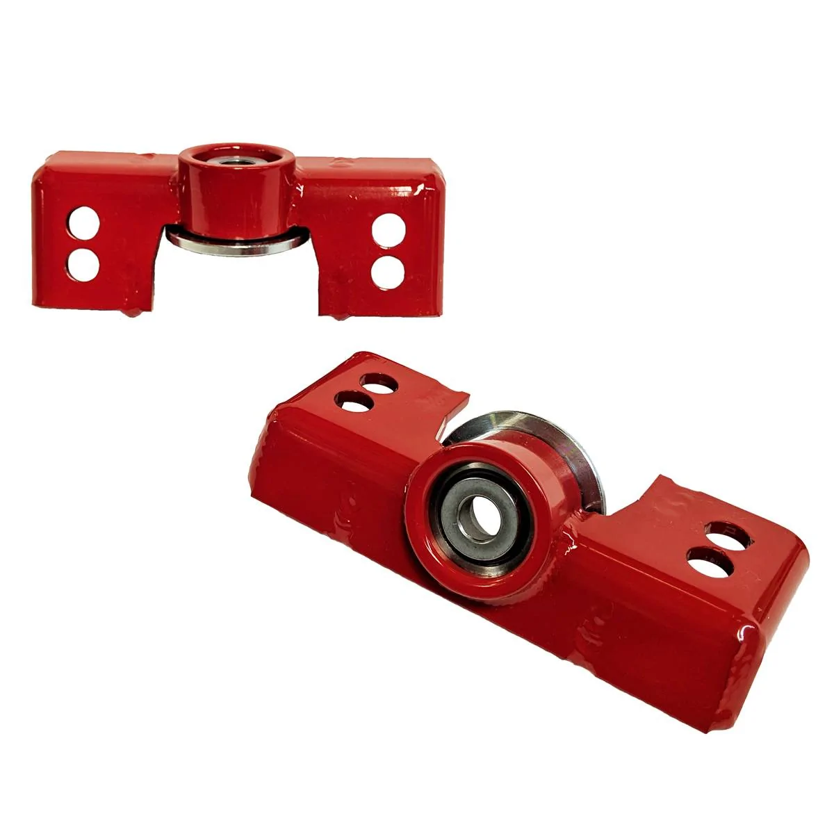

From what I've seen:
Steeda - reinforced stronger version of the stock design, improves ride quality, slight better clearance, some people have noise issues (I think this is mostly due to install, but it is pretty common)
BMR - more clearance, better ride quality, rips the inner metal instead of failing only at the mount
UPR - looks like a Steeda rip
There's also JMS I believe it is, haven't heard of failures from them yet but they are probably selling in much lower quantities than the above.
I don't have any firsthand experience with any of these mounts, but if I went with one it would probably be the Steeda for the sturdy design that would fail sacrificially instead of risking any potential damage to the sheet metal.

Thanks! Seems to be the consensus, I wanted to go with BMR since they make great stuff and most of my car is BMR, but like you I’ve heard stories and that makes me a little nervous as I don’t want to touch my suspension again for a long while haha, the Steeda looks like the winner but the people chasing the noise also scares me a little but seems like that was all due to install. Thanks for the insight!

I have a set of the steeda ones cause I got a good deal for a new set on here (still in box) very nice... however, the BMR ones are nice too, as they are made to compliment the lower ride height and raise the top mounting point of the shock to keep the full travel it had originally...
