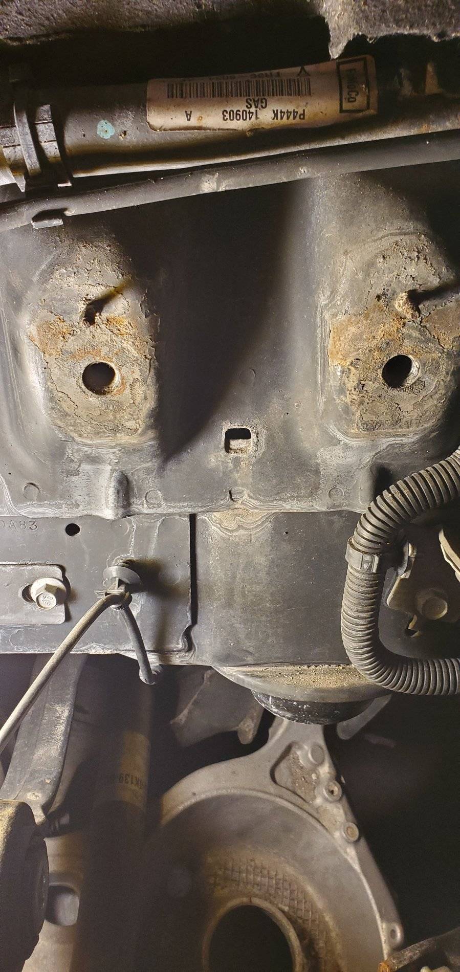

I figured I'd give some positive feedback on the BMR shock mounts. I had the very first set installed, original design and 13,000+ miles of DD, autocross, and track, often on far from perfect roads. I also drive the car quite hard all the time. Bumpstops were trimmed from when I had OEM mounts. They were used with Ford Performance Track shocks and BMR SP085 handling springs, 980 lb/in. I just changed to a coilover setup, but upon inspection, I saw exactly what I expected: dirty but absolutely zero cracks or signs of structural damage.
This is a PSA: do not fear using these mounts. With adequate travel and bumpstops, you will not have an issue. All failures of the mount area can be attributed to abuse in one way or another.
shogun32
Feb 8, 2019
92
16,223
14,019
Northern VA
That's a goodly amount of flaking though and the surface doesn't look remotely flat. (not blaming the mount)
Maybe take a metal file and get things back on-plane?
I did, but the picture makes it look much worse than it was. The surface has "grit" as formed, so that the shock mount does not slip. Most of what you're seeing is salt and road grime build-up.

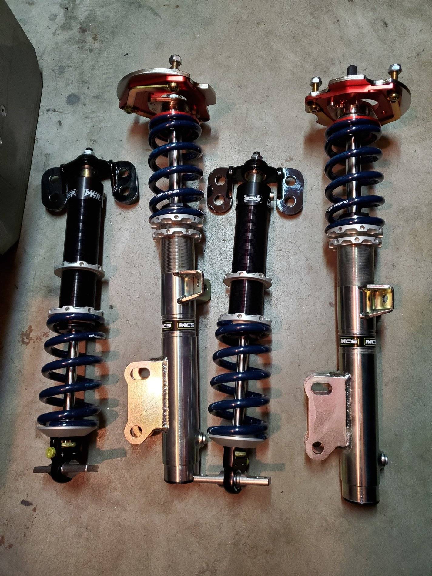

SteveW
Jun 3, 2015
700
271
Columbia Gorge area
2015 Mustang GT PP
those springs look awful short. what diameter? 2"? Rate?
The kit looks like the Vorshlag MCS TT2 one and in the pic you can see the front springs are 600lb or GTS package rate. Can't tell from the pic what the rear spring rate is but if it is the GTS kit then it would be 750lb. Vorshlag says 60mm front springs and 2.25" rears. Probably 6" long at each end.
fatbillybob
Apr 1, 2017
43
554
273
SoCal
'19 GT pp1 A10 Orange
And having no bumpstops puts you in a situation that you could rip the mounts out...
Yes but only if you run out of travel and bottom. That's part of what racers do is test and develop to go faster. If that 2" BS takes up travel that you still have in your suspension and you hit those stops you go slower. You can't do things like get the power down right because you loose grip on the BS.
