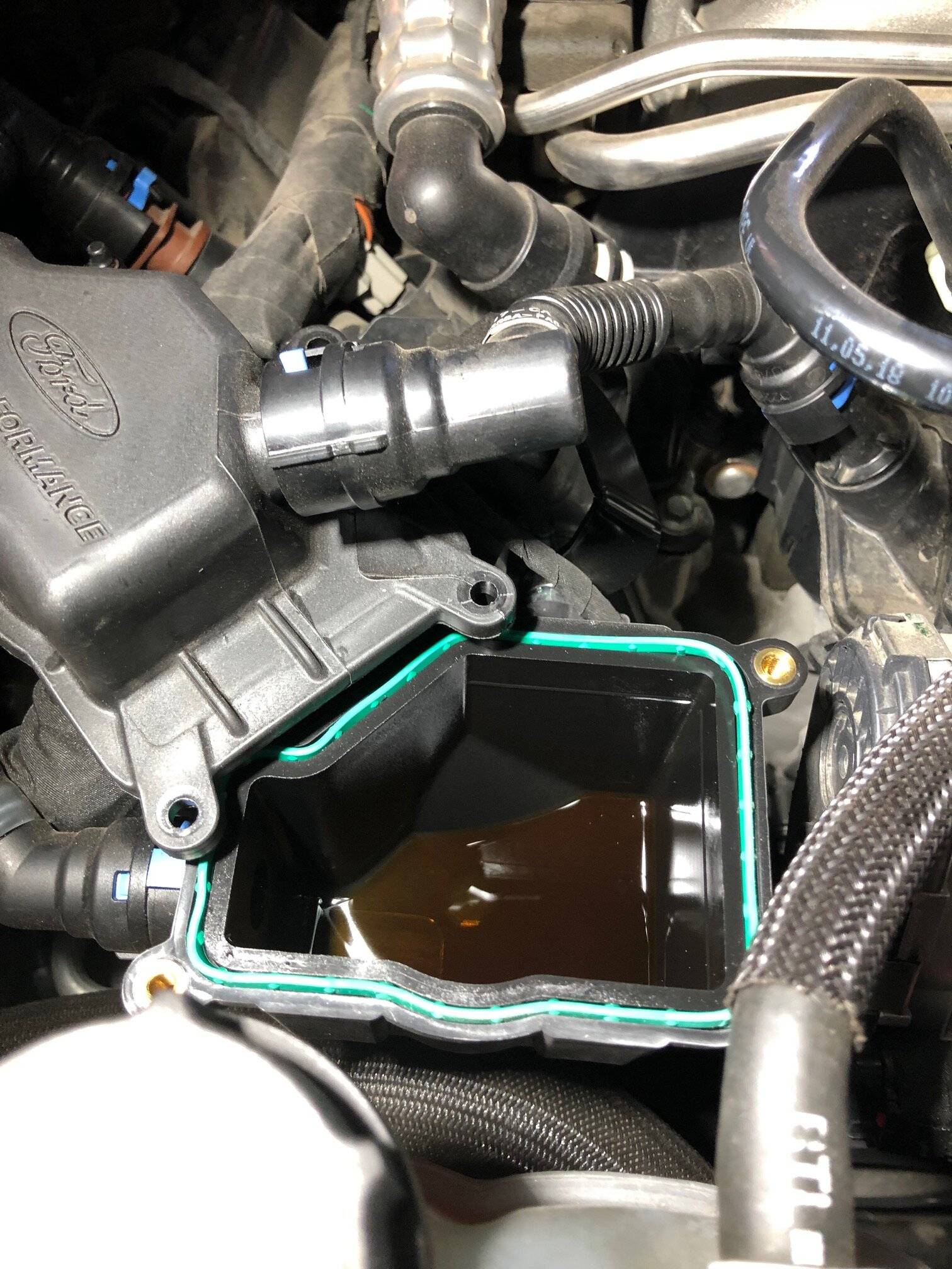

Here's after a couple of track days, passenger side of the Coyote, same config as in the Mach 1. Yes you need it if you track, but not necessary on the driver side.
I will disagree with you regarding the driver side for track use
On my 17 pp1 , using a power pack 2 and with ford racing track suspension and running 305 squared nt01, the driver side was pucking quite a lot in the can
It all depends on how much you push the car
For me the solution was to use the aluminum valves covers from the gt500 that have a much, much better baffling system with 1 way valves
